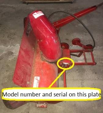

BrianX128 107 #3 Posted December 4, 2019 https://pittsburgh.craigslist.org/grd/d/vandergrift-wheel-horse-snowblower/7026547530.html This one is closest to me, but appears to be missing the height adjuster. Darn. Share this post Link to post Share on other sites
pfrederi 18,332 #4 Posted December 4, 2019 (edited) The skids are the adjustment works but not ideal Edited December 4, 2019 by pfrederi Share this post Link to post Share on other sites
gwest_ca-(File Mod) 11,243 #5 Posted December 4, 2019 Price is right. Make sure to get the lift tube and flag not shown. Garry 1 Share this post Link to post Share on other sites
