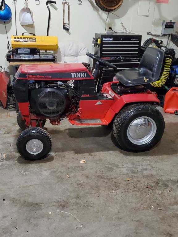

Marc M. 12 #1 Posted December 1, 2019 Hello everyone, I am new to the wheel horse world and I am lucky enough to be restoring a 416-H . What fluids should I be using in the rear diff ? 3 Share this post Link to post Share on other sites

pfrederi 18,090 #3 Posted December 1, 2019 10w-30 or 10w-40 motor oil. Will take about 5 qts Filter is Wix 51410 1 1 Share this post Link to post Share on other sites
Achto 28,083 #4 Posted December 2, 2019 Nice looking tractor!! 1 1 Share this post Link to post Share on other sites
WHX?? 49,645 #5 Posted December 2, 2019 (edited) Hey Marc and I use synthetic 10w40 so as the motor and tranny both take the same oil. Works good for me. Guys here claim the synthetic works a bit better in cold weather. Does seem to help. Your 416 should have the Eaton 1100 and tons of info on them here. A fairly reliable and bullet proof unit you take care of it. I have three tractors with them in it but they do all have their own quirks. Yes nice looking tractor Edited December 2, 2019 by WHX24 1 Share this post Link to post Share on other sites
