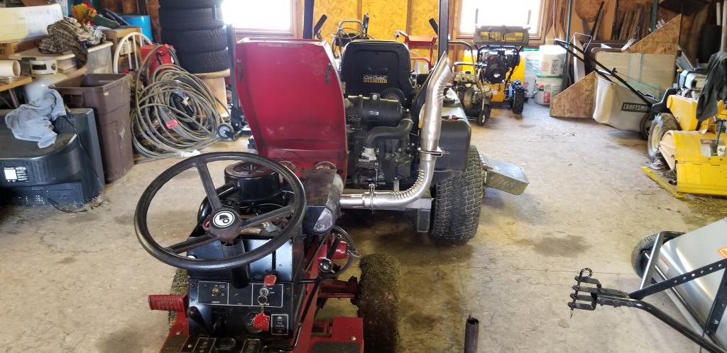

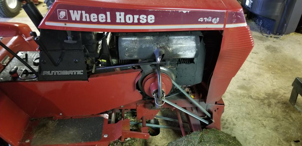

Has anyone changed this exit angle from this type of muffler to literally anything else? My yard has some long stretches where you are normally driving straight west where our wind always comes. Tonight was the first time I actually mowed with it and mowed for over two hours. It did great and my recently jb welded flywheel magnets are still stuck and working but I have the worst headache from breathing exhaust fumes and since this is meant to be my wife's mower and she hates exhaust smell- I gotta do something with it. My garage always smells of exhaust / diesel / something but this was rough for even me.
I have a stack on my other mowers that just goes up and out to the side, I'd like to maybe do that as she won't be mowing near any trees low enough to hit anything with a stack, either that or aim it down. I just don't know if that exit is a common pipe ID or OD without cutting it and was wondering anyone had messed with that. I like the muffler itself it's good and quiet. As much as I love my wheel horse, and lawn rov'r I'll be spending 75% of my mowing time with this.. also ignore the way its mounted to the 3 point hitch I since made proper extensions.. first day rigging in this picture to try it. It's actually straight now.

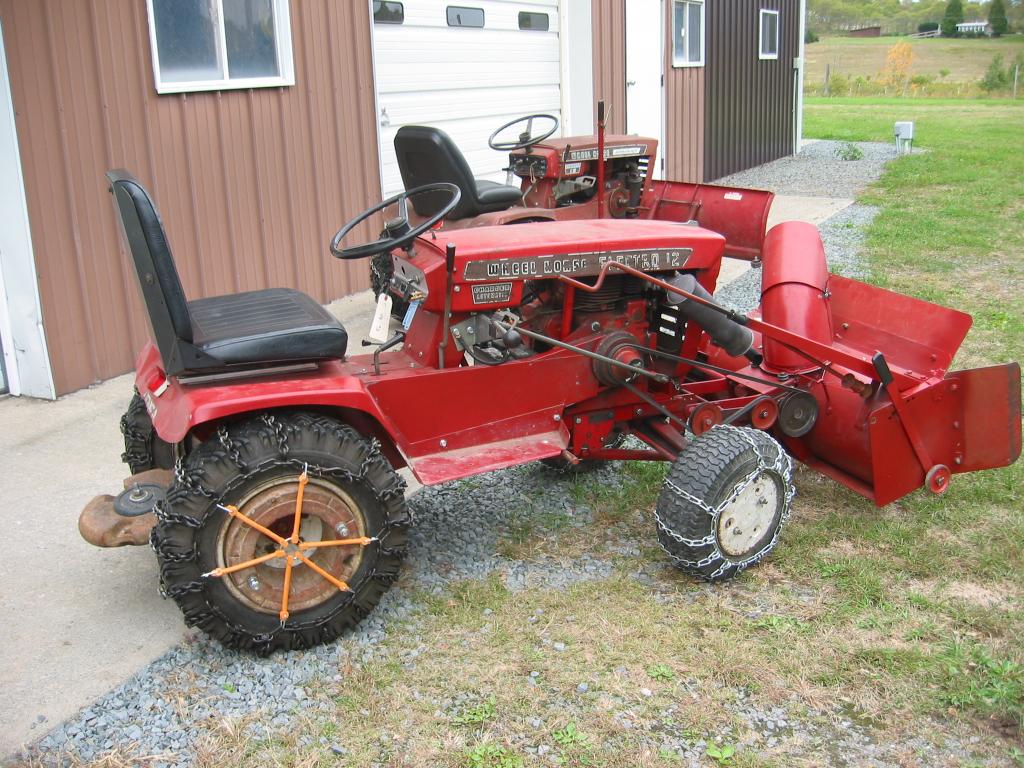

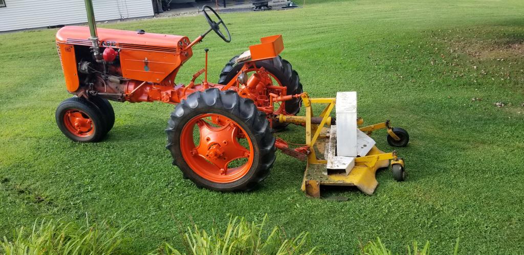

I have a B80 and a C160 with stacks.
Both point straight up so as to direct the gasses away from me.
The Case rig is lovely....

Those Kohlers are standard pipe thread on the exhaust so you could remove the muffler and add some correct size fittings to move it but realize that if you move in too far in any one direction you'll have to support it so as to not break it off in the exhaust port of the head.  Or try one of these https://rover.ebay.com/rover/0/0/0?mpre=https%3A%2F%2Fwww.ebay.com%2Fulk%2Fitm%2F191782081418 and route it like on the B and C series of the early-mid 70s.

Maybe I'll try and get a 45* or 90* bend pipe at the local Ace Hardware store that measure's closes to this and has threads on an end and tac it to the muffler that way I can thread in something to the end if need be. I'll just probably have to cut the exit part of the muffler flat maybe back 1 inch so the exhaust isn't getting pushed at an angle in the new pipe, that seems a little bit restrictive.

I think I'm going to do this and just get a shorter in both length and height 90* bend. Its just 2" pipe there so that should. Easy. Its pretty light and 1 3/8 od pipe will shove over the existing pipe coming out of the muffler if you gently tap on it. I'm still going to either hook a wire through the exhaust clamp or see if I can tac it to the other muffler. It's pretty light too, we'll see if it helps tonight.
