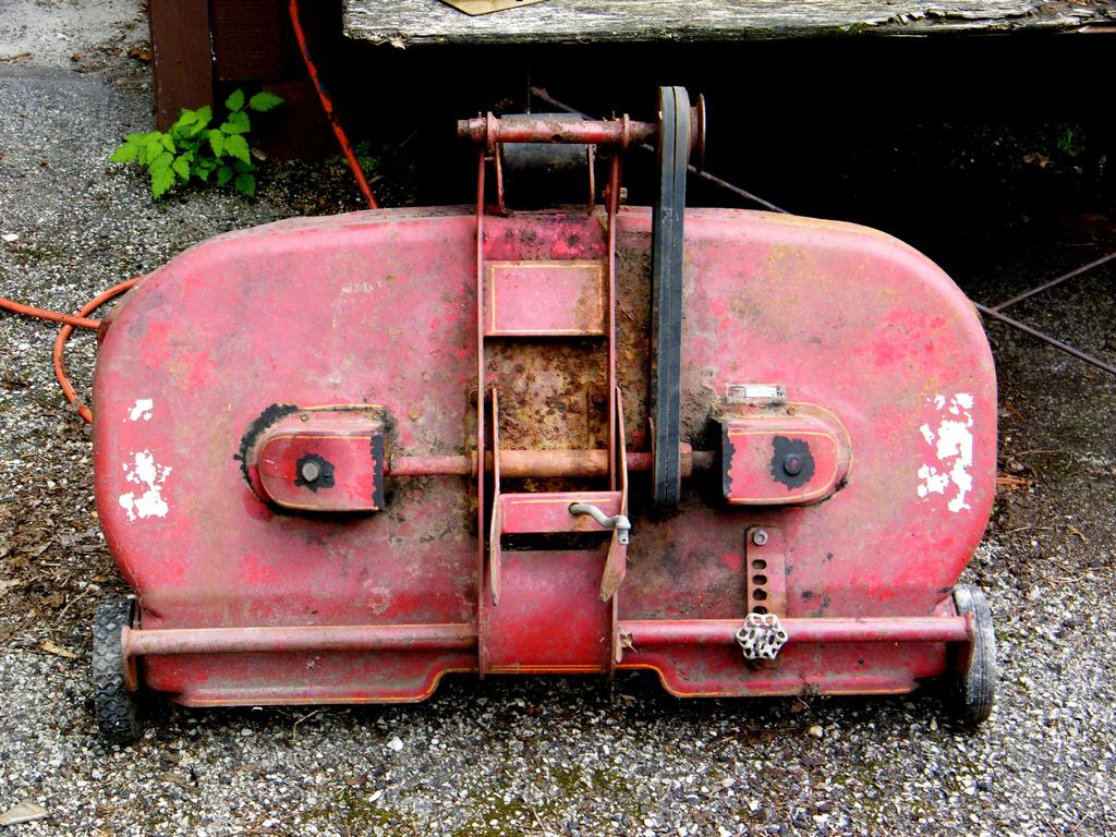

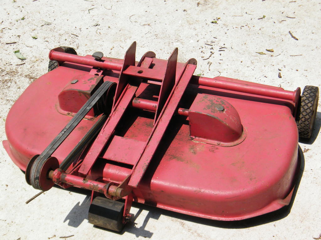

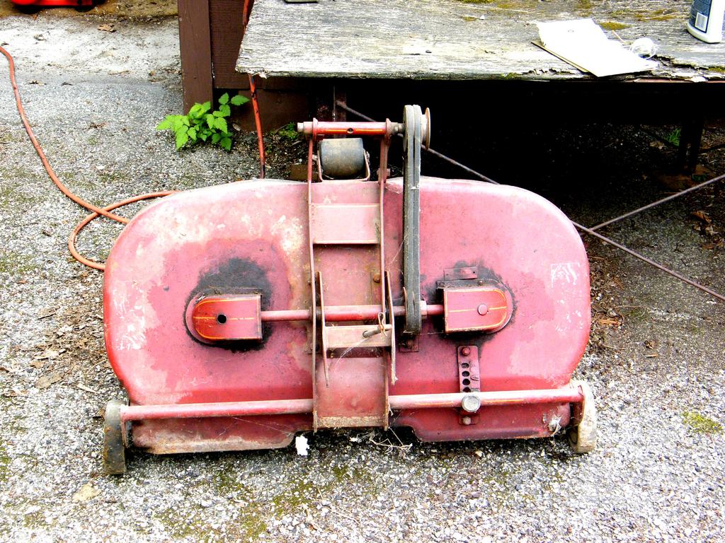

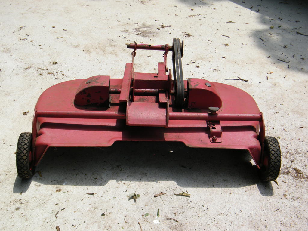

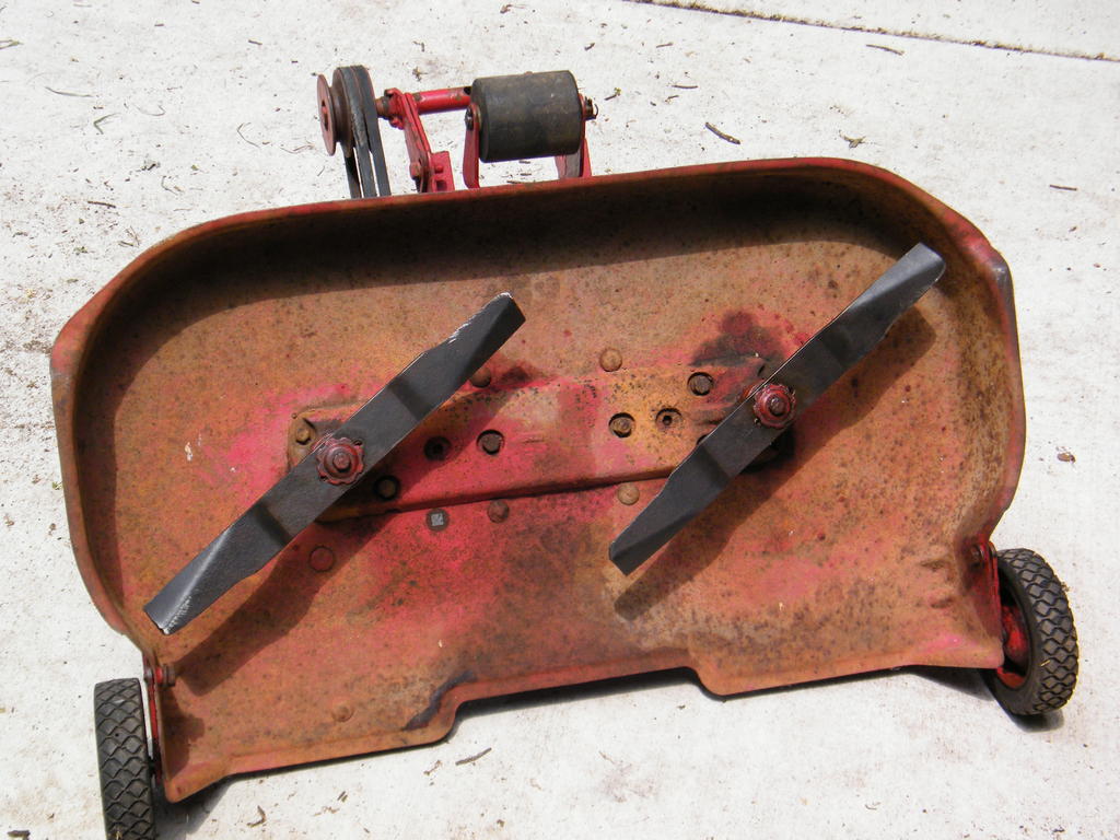

stevasaurus 23,816 #5 Posted November 22, 2019 If you are looking for a deck for your 653, you want to find one of these oval 2 blade decks. They come in 32" & 36". They are rear discharge. RM-364 (rear discharge 36" 1964)...RM-324 ( rear discharge 32" 1964). Go into the Manual Section on the main page...the 1962's, 63's, 64's and maybe 65's/66's & 67's will work. Some of the manual numbers may look like RM-3665, etc. This is the 32" Here is the 36" Share this post Link to post Share on other sites
