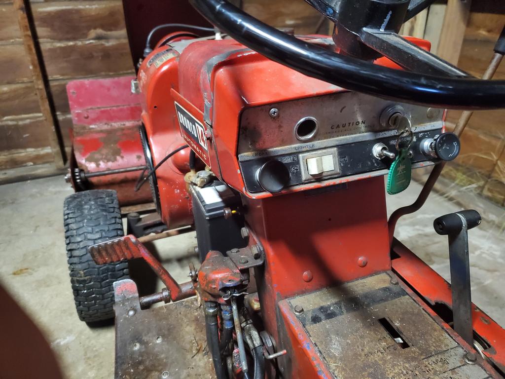

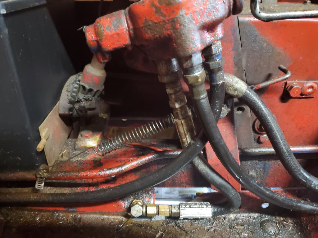

I dunno if my pivs are explanatory enough, but that metal rod attatched to that spring, is rubbing the hydraulic hose.
How do i go about moving/fixing that? They are tight...
Also...what exactly does that rod/spring/wire do? I havent touched a thing...

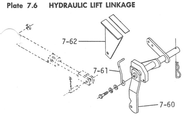

Rod looks like the lift height indicator item 7-61
Depending on how much it needs to be moved you could add a length of flat stock between the valve mounting bracket and the side of the hoodstand.

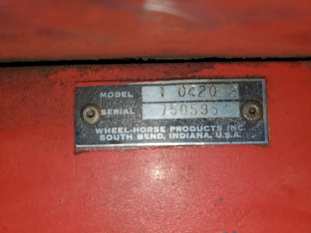

Have you ever posted the model and serial number of this tractor? Can see the ID plate under the dash in the last photo.

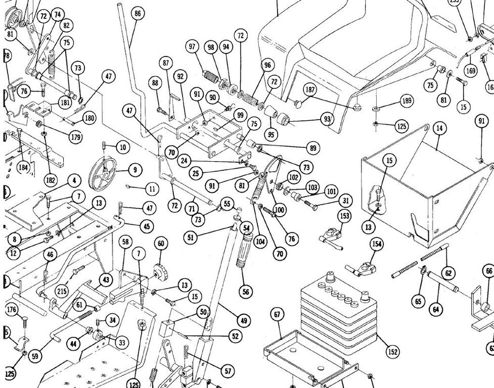

That is not an original WH spring set up.  i assume the original pedal return spring mounted down in the motion control linkage (under the silver plate on the hood stand) broke and I think and some PO came up with the external spring to hold the pedal up.  I think the spring is NLA and even if you get one it is a real PIA to install. Item # 104 WH # 1230
edit:  Gary is right about the indicator rod.  part of your problem is the hose end going into the valve appears to come out at an angle  the original was straight  The hose looks to be a replacement original had a smooth surface and no white markings.

Did, but here you go😊

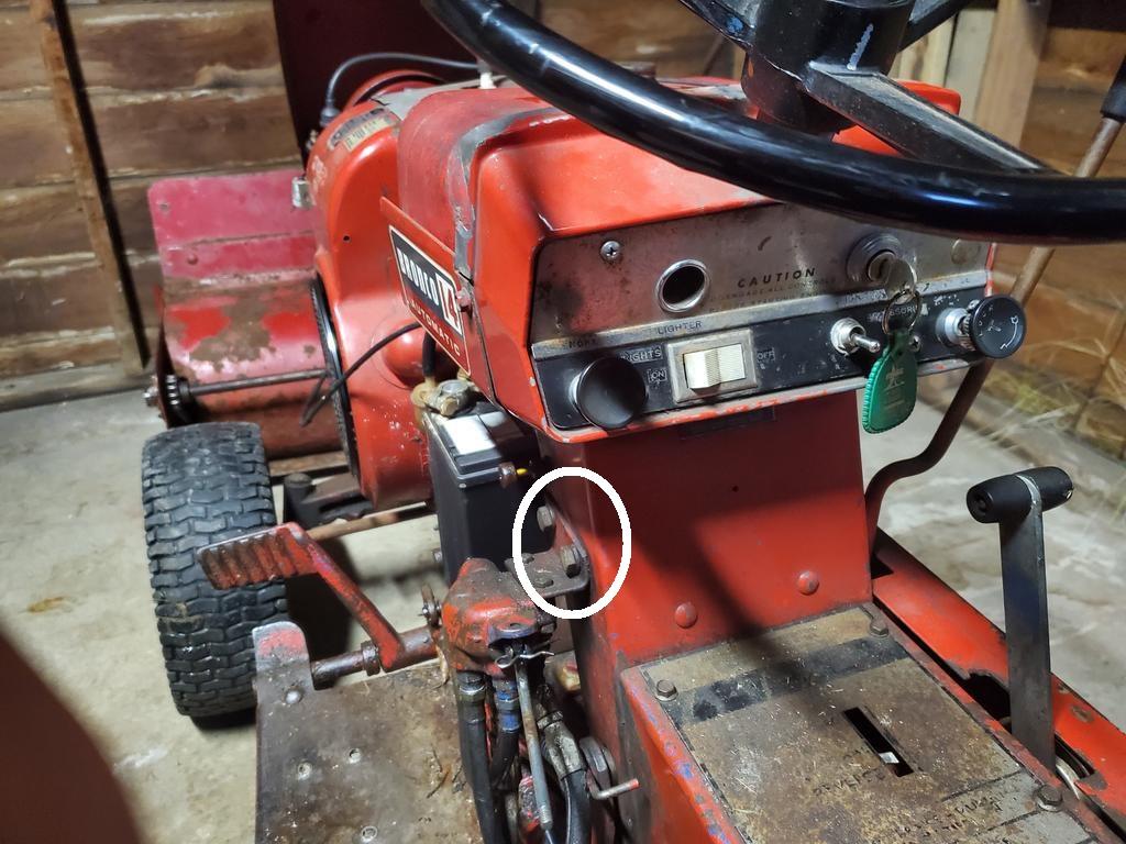

You need to get that hose off of there and quick!!!!  Remove the lift height rod or swivel the connector for the hose or buy a fitting so the hose runs straight down or space the entire control valve farther off the tower. You can put spacers behind these two bolts marked below. Once that hose gets a hole you will have a mess on your hands with hydraulic oil pissing everywhere. Not to mention high pressure streams can be dangerous. You should replace that hose while you're at it.

John is right you need to replace that hose. Failure is very messy and possibly dangerous.  One of our vendors here can fix you up.
These are SAE #5 ORB fittings and hard to find  I doubt the average local hydraulic hose shop could help you
