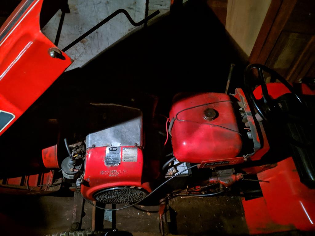

So, the Bronco isnt here yet...stupid weather; hopefully today...
But i ordered a 'lot' of top tin ( see pics, of what ill b getting, n what i ordered). But not being so good at downloading/searching, i'm trying to figure out which piece(s) ill be needing/actually using. Was wondering if anyone might be able to show/tell me? Itll be my luck, none of'em may work...i kno i dont need 1 piece already, i think (yes, i was guessing)...but that's ok; mistakes teach, too...

Big piece goes on top over spark plug.  Oval hole goes around the carb. Bump out one back side of engine.  One hole into the head one into the engine end plate and main shroud

That top piece is for a starter gen
motor lf lm not mistaking. You would need the one that matches the head bolts unless you have a start gen on it.
