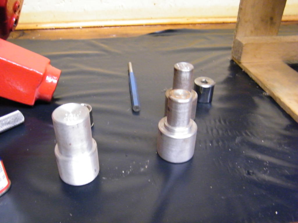

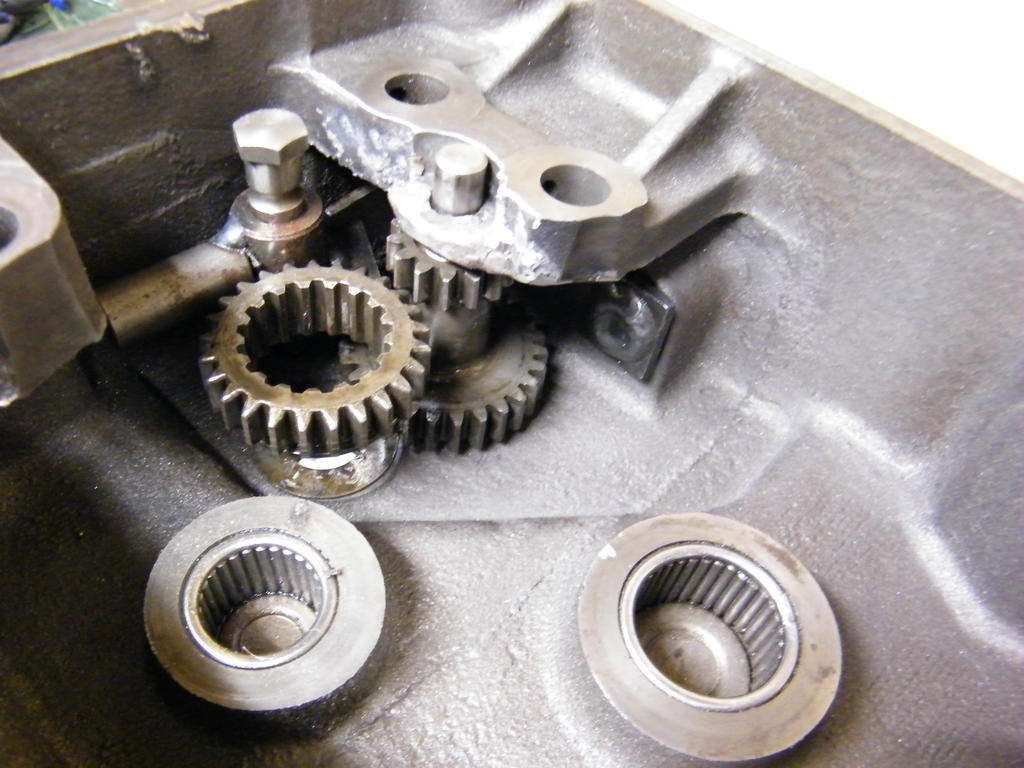

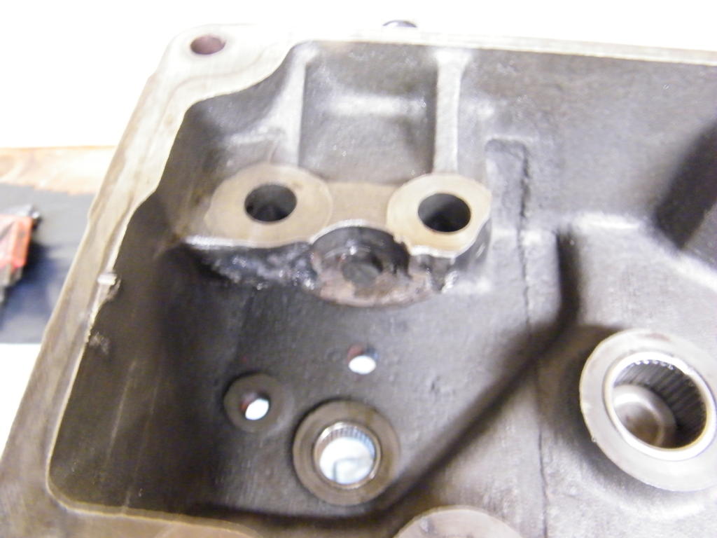

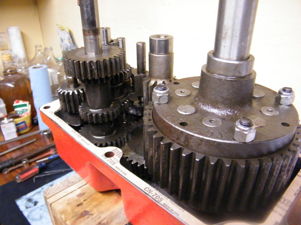

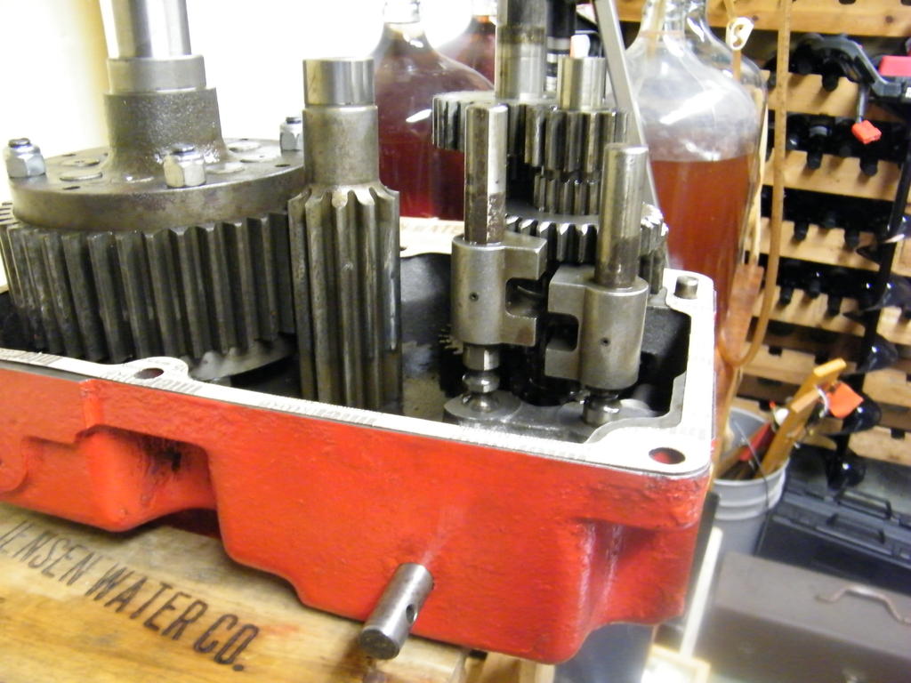

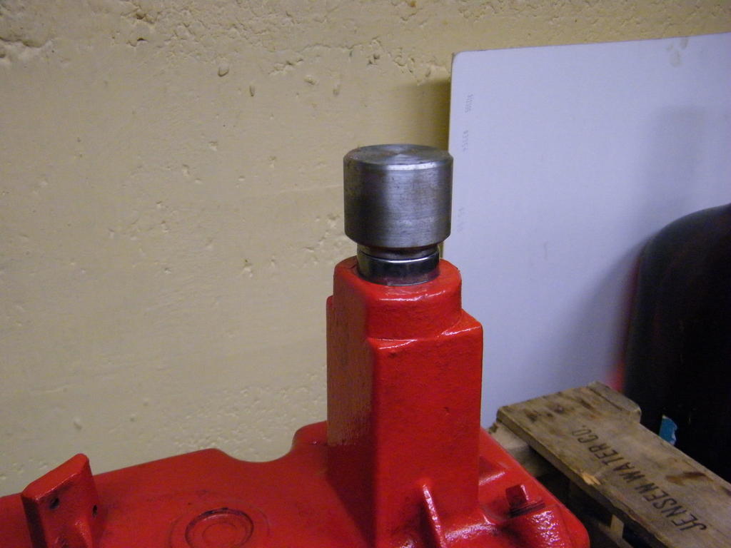

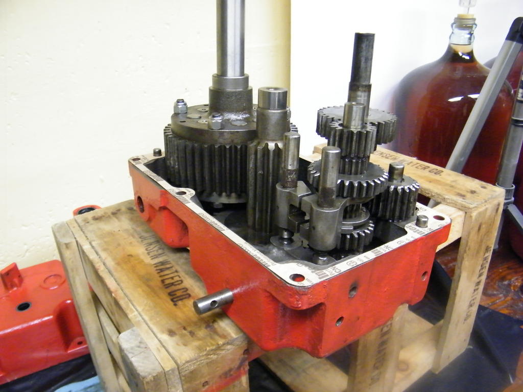

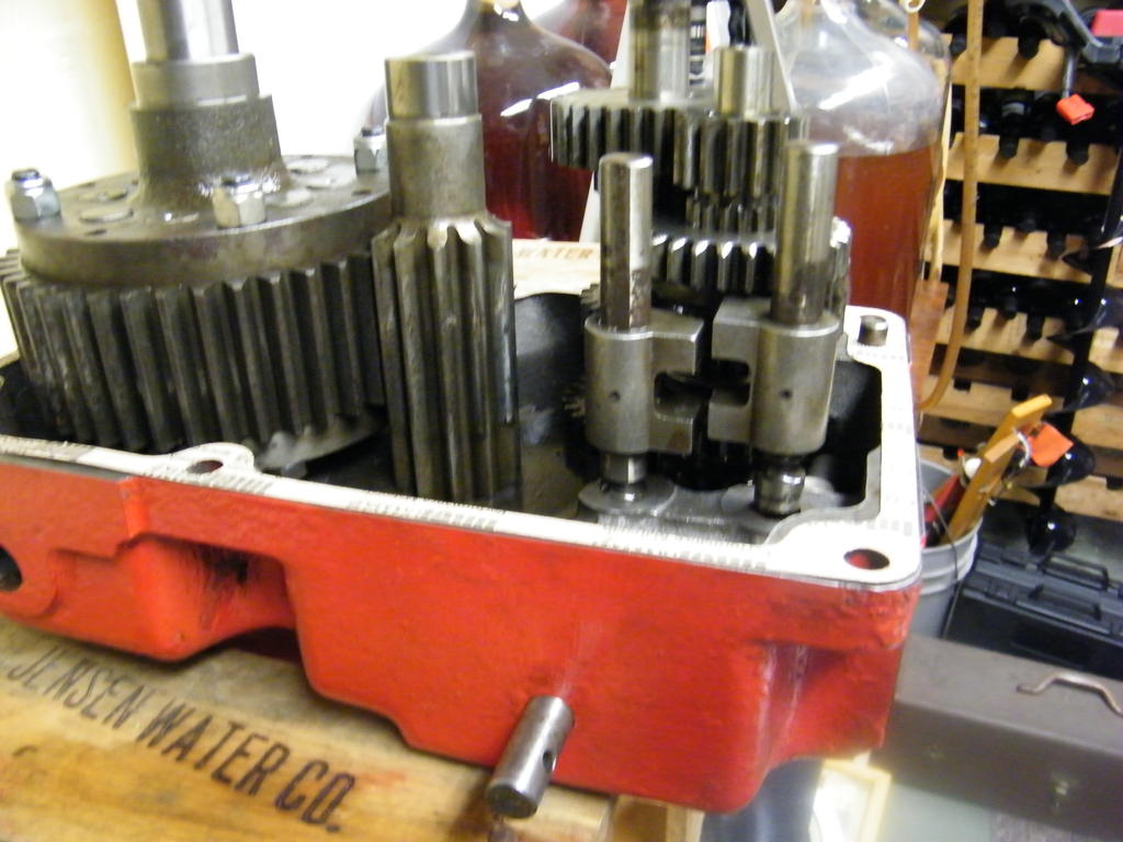

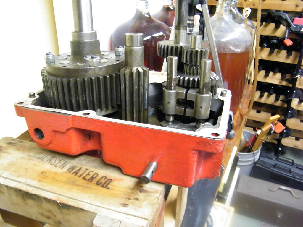

stevasaurus 23,515 #1 Posted November 14, 2019 This is the final in a series of Wheel Horse transmissions. I have done the 3 piece #5003 & 5010 for the RJs...the #5025 3 speeds...the #5085 4 speed...the #5060 6 speed and now the #5091 8 speed. It has been a long wait, but my brother Mike had a C-100 that just had both axle bearings go bad. He took it to a dealer to have it all checked out and the dealer noticed the play in the axles. He did not want to touch it and even suggested scrapping it. That's when Mike called me. HELLO!!! I rebuild these...take it off the horse and bring it over. He did. We did have to cut off the both hubs with a 4" grinder...which we replaced with help from Randy... @The Tool Crib. Got the hubs in the mail a week later. We needed 2 axle bearings, 1 break shaft bearing, the 4 seals and the case gasket...got from Lowell https://www.wheelhorseforum.com/forum/141-wheelhorse-parts-and-more/ Time for pictures. Case half...deep side...showing lack of axle and brake shaft bearing. I have to say... @prondzy made me a set of arbors that I was able to use to set these bearings. I did use the freezer method for 2 days to shrink the bearing race...worked like a champ. Mike, those arbors were the cat's meow...Thanks Mate. Seeing that the axle bearing disintegrated, it did leave the axle with some rough spots. I ran the 4' grinder gently over the rough spots so it would fit back in the differential side plate and the axle tube.. BTW...I did 5 videos doing this trans. It fought me to death and I did not edit any of the things that made me go back and re-do the things to make it right. Hopefully, watch the whole video 1st and see where I made mistakes and what it took to make things right. Then you can do it right the 1st time. Video...putting the differential together. I took a bunch of good pictures of the most important part of the 8 speed transmission...the hi/low mechanism...especially showing the fork that is the weak spot. This is what makes it so you can't shift between hi and low range. Video of putting this together follows the pictures. This is the hi/low range mechanism. the input shaft with the gear and spline assembly. The rough part (you see) is where I broke the casting and Mike had it welded. You can see the fork gear and the bolt to release the detente and fork it self. There is the fork...that is what breaks or gets bent. Shifting without coming to a complete stop and going from low to high...or...hi to low range is what breaks this fork. You can see, there is not much there. This is the piece that sticks out of the trans with the lever hi/low. The notch hooks onto the fork of the fork mechanism. I took some different views because sometimes the pieces can be welded back together. the weld job The look of the parts. the videos The rest of the trans. The last 2 videos. Here is some different shots...that I can use to help members when they run into things...like what neutral looks like from the inside. neutral 2nd gear 1st gear It will take approx. 2 qts of 90 wt oil to fill up to the fill mark on the dip stick. I know...this may not be my best effort, but it does show all the pit falls. I am so glad to finally be able to do the 8 speed 8 pinion transmission. Thanks to my brother Mike, my good friend Lowell, my new good friend Randy, and a Minnesota guy that has always been special...Mike P....and as always...my inspiration...Squonk. One thing I have to say though...the video times ad up to 42 minutes and 21 seconds. That is the worst time it would take you to save an 8 speed transmission. 4 14 3 1 Share this post Link to post Share on other sites

prondzy 3,889 #3 Posted November 14, 2019 Glad to help Steve! 3 1 1 Share this post Link to post Share on other sites
stevasaurus 23,515 #4 Posted November 14, 2019 prondzy...1st chance I had to dig into another trans since, cents, sense you gave me those. I was pleasantly surprised to be able to use them on the 8 speed...remember, you made them for me to use to the 3 piece RJ transmissions. The one I used for the axle 1 1/8" was to die for. Rock & Rye Mike. 3 Share this post Link to post Share on other sites

squonk 44,860 #6 Posted November 14, 2019 Awesome pictures and I will watch the video's when I have time. The right tools and equipment always makes a tough job go A LOT EASIER! Those arbors, When at auctions, yard sales ect I f I see anything remotely like them I grab them. I got a box full of bearing and seal installers, plates, pullers ect. Sometimes you make a tool out of a couple of them. 2 Share this post Link to post Share on other sites

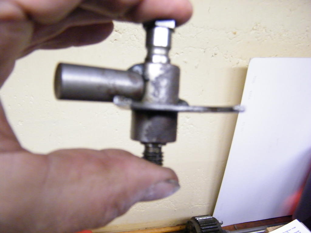

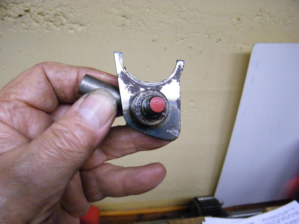

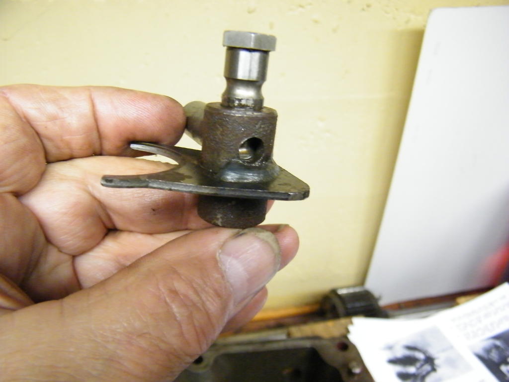

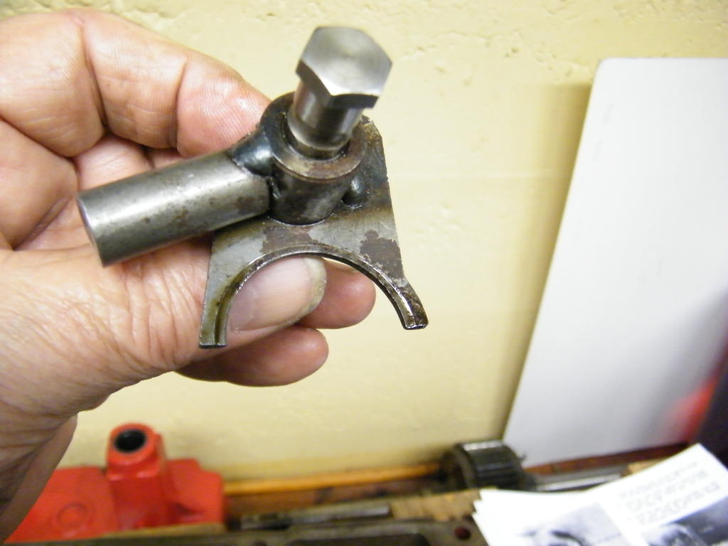

N875ED 98 #8 Posted November 14, 2019 Thanks, Steve. I just rebuilt my 8-speed last night after finding the Hi-lo shift fork broken, just as you said. I took the three broken pieces to a welder about getting it repaired but he declined because of the part's original heat treatment. So, went to the Toro dealer and ordered a new one...$57 in only 3 days turnaround. Nice. One thing to watch...the new ones are powder-coated black and it is important to sand the paint off the ends of the cylindrical portion, else the paint will be in contact with the transmission case and thru-bolt, and not the metal of the cylinder. Eventually the paint wears away and now it is no longer torqued properly. edited by stevasaurus...excellent to know you can still get that part and great to know about the powder coat. Thank You 1 1 Share this post Link to post Share on other sites

Pullstart 68,521 #11 Posted November 14, 2019 With the use of the arbors, did you press or just tap the frozen bearings in? Great thread! edited by stevasaurus...I just tapped them with a small ball peen hammer. With the freezer, you can almost push them in. The arbor I used for the axle bearings even had a lip which made it possible to set the bearing down enough for the seal. 1 Share this post Link to post Share on other sites
prondzy 3,889 #12 Posted November 14, 2019 1 hour ago, pullstart said: With the use of the arbors, did you press or just tap the frozen bearings in? Great thread! Kevin, I have found it best to press them but maybe steve tapped them . 2 1 Share this post Link to post Share on other sites
Pullstart 68,521 #13 Posted November 14, 2019 I imagine if a guy were to drill and tap the arbor with a 1/2” or 5/8” thread, he could pull ‘em in from the inside... 1 Share this post Link to post Share on other sites
prondzy 3,889 #14 Posted November 14, 2019 1 hour ago, pullstart said: I imagine if a guy were to drill and tap the arbor with a 1/2” or 5/8” thread, he could pull ‘em in from the inside... I think rough casting wouldn't allow that edited by stevasaurus...right, you have to pound them out with an arbor or a punch. It might work on some of the bearings though. 1 Share this post Link to post Share on other sites
WHX?? 53,325 #15 Posted November 14, 2019 2 hours ago, prondzy said: best to press them Agreed, the bearing makers say press them in. Using the BFH can wreck them. I use the H press & a socket till my arbor ship comes in.. You want to press on the very outside race. edited by stevasaurus...just because I can. No BFH's are needed to do a transmission. 1 Share this post Link to post Share on other sites

Lee1977 7,456 #19 Posted November 24, 2019 I have a set arbors for the PTO bell. Never needed a set for the transmission. Just use some 2" sockets and a wood mallet . I also have one for ball bearing, don't thing I have ever used it. Just used a socket or the old bearing. 1 Share this post Link to post Share on other sites
