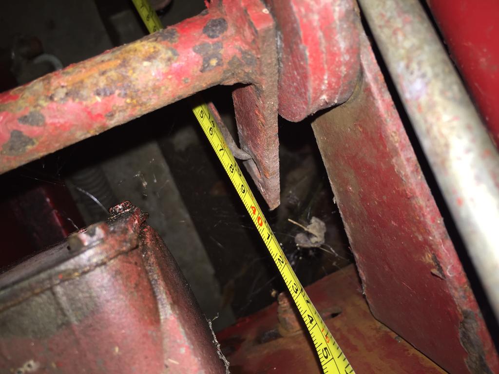

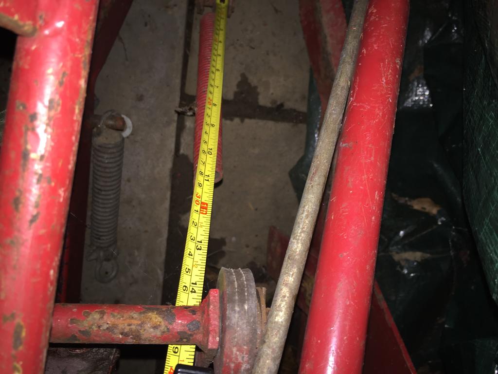

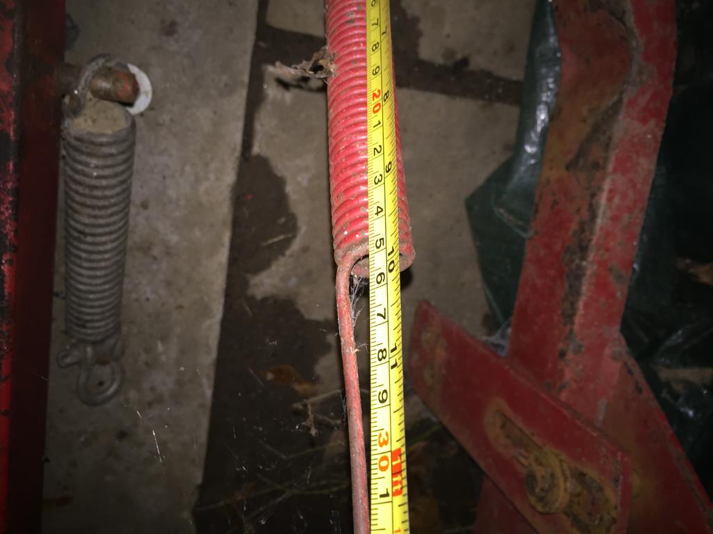

nylyon-(Admin) 8,523 #4 Posted November 13, 2019 Sorry for the bad pictures, I realized not home tomorrow morning so went out to measure tonight. The overall spring length seems to be about 14 ½" with the spring part being about 10 ½" to 10 ¾ "long. I can probably do a little better if I didn't hold the flashlight in my mouth 1 1 1 Share this post Link to post Share on other sites

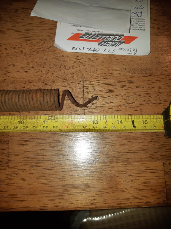

ti-jean 45 #5 Posted November 13, 2019 (edited) Ok 14 inch with tension On or free of it thank's i look ok to me check my pics Edited November 13, 2019 by ti-jean Share this post Link to post Share on other sites
nylyon-(Admin) 8,523 #6 Posted November 13, 2019 My blower is not hooked up, so it's without tension 1 Share this post Link to post Share on other sites
ti-jean 45 #8 Posted February 8, 2020 (edited) Big broblem now my tensioner spring is broken again but now for real lol where to find a replacement part or idea for mod can't find one stronger enought Tank's Edited February 8, 2020 by ti-jean Share this post Link to post Share on other sites
vanillaman 11 #9 Posted February 8, 2020 Earlier this season I broke the tension on my 42 in. single stage. I took the spring to a local mom & pop power equipment dealer. He has a box of used springs in the shop and found one that works for me. These people are familiar with most makes of machines. You might give that a try. Dick 2 Share this post Link to post Share on other sites

wallfish 18,788 #11 Posted February 12, 2020 On 11/12/2019 at 8:44 PM, ti-jean said: For a quick fix until you can get a replacement, heat up the broken end with a torch to cherry red, then you can bend a new hook in without it breaking. Share this post Link to post Share on other sites

wallfish 18,788 #14 Posted December 24, 2024 2 hours ago, GROlson said: but getting tension correct is difficult Get it to hold the belt tight and that's about it as far as difficulty goes. If the belt doesn't slip then the tension is good. If it does slip then it needs more tension. The ends of springs can be worked by using a blow torch. Heat only the portion of the spring you wish to rework to cherry red so it takes the brittleness out of the spring steel and let it cool. It can now be bent and worked without the spring memory and breaking. Basically, go down to TSC, get a spring and make it fit. This method can also be used to make new hooks on broken springs. Share this post Link to post Share on other sites
