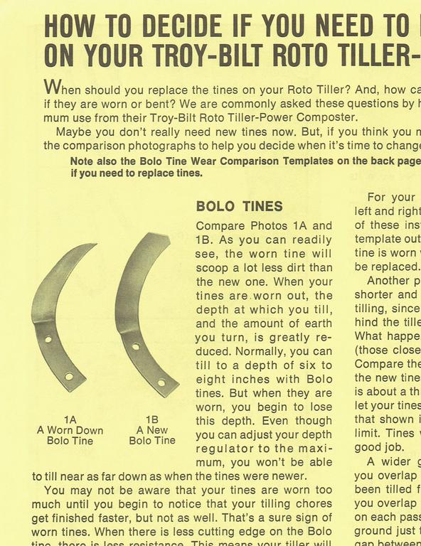

They are useful tools.  However they work best with a gear drive 8 speed.  You want to go very slowly and they try to push the tractor.
Big thing to look at is the condition of the tines. If they come to a point on the end they are worn out will not till well and are very expensive to replace.
Edit:  This is what I mean by pointed being worn out. (Actually from a TroyBilt tiller manual but the concept is the same.)
