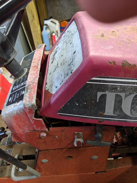

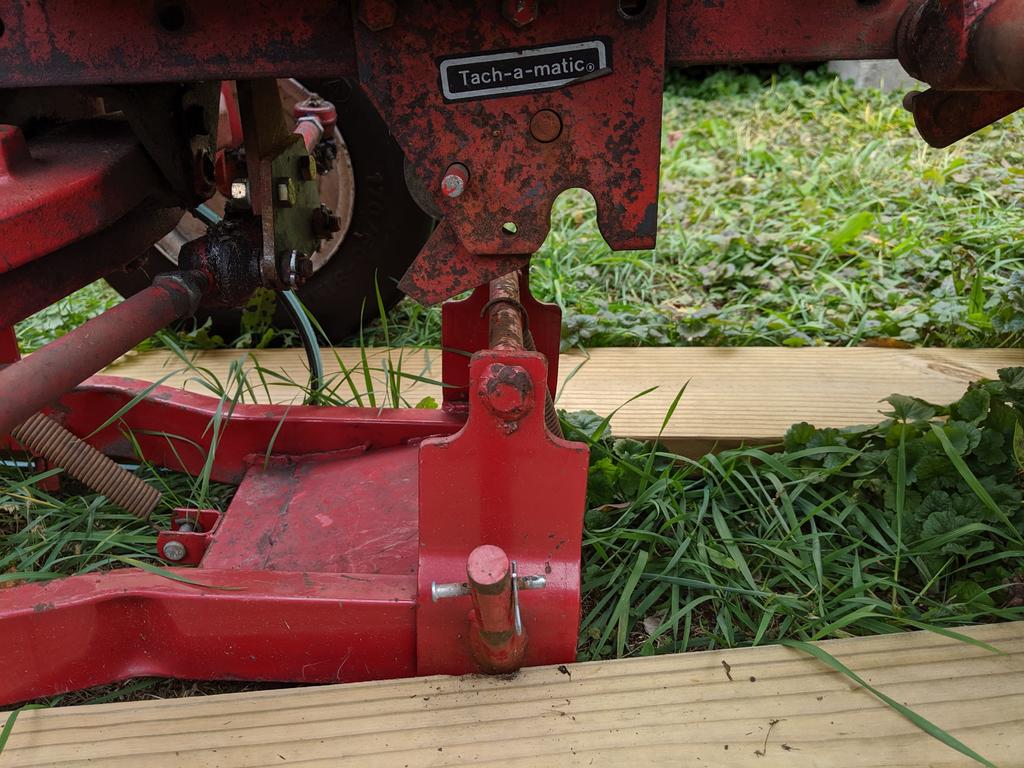

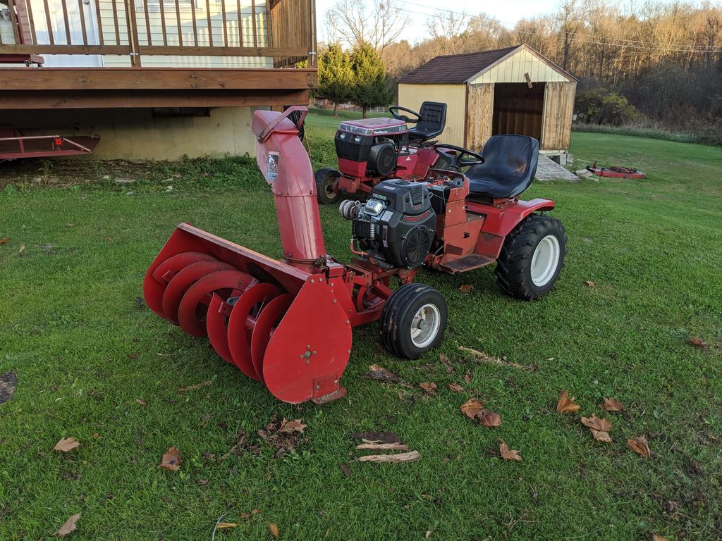

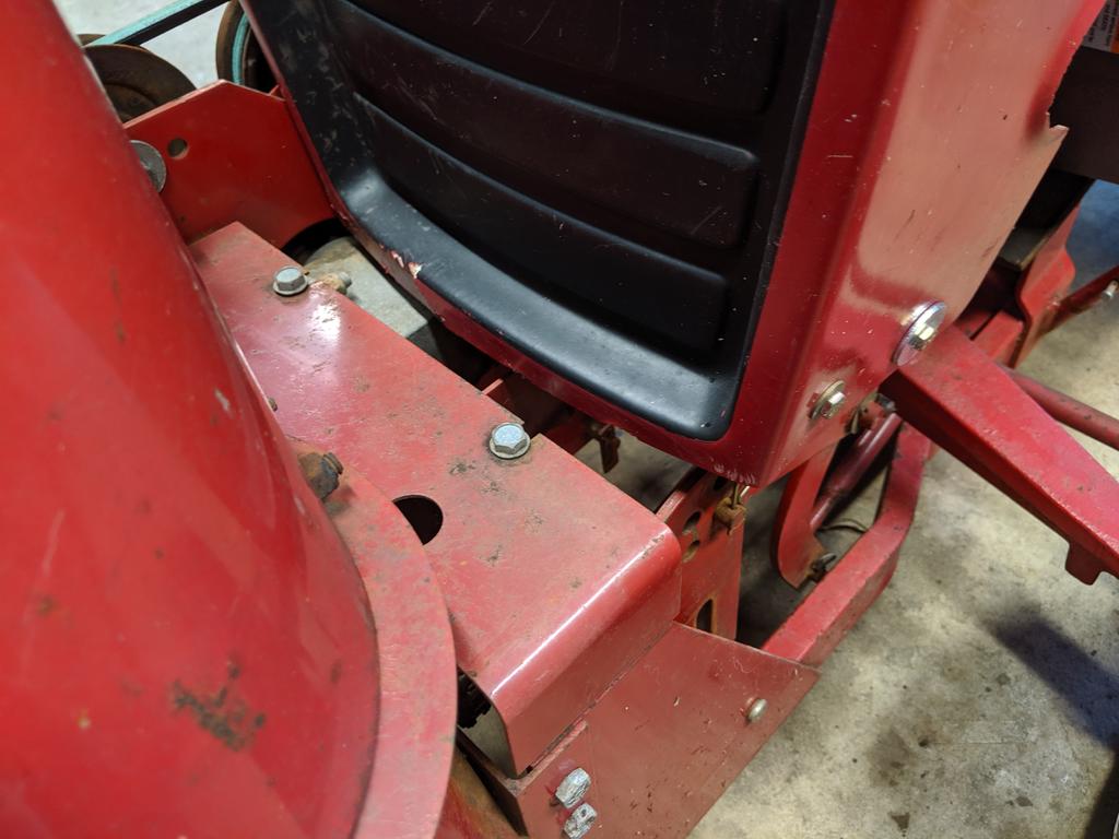

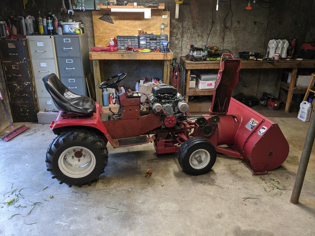

Has anyone done this before?  I am having fitment issues mounting the 44" blower as it hits the hood.  Unsure what I am to do here.  Curious if anyone else has had this issue before and of so what did you do to resolve it.
Could you move the tach-a-matic up to the next hole?
wallfish
Remove the hood and fit the blower up to make sure everything is good and operating correctly. Then figure out how to fit the hood back on with the blower installed so it doesn't interfere. Seems better and probably easier to adjust the hood position than modifying the blower position. You could always run it without a hood if needed or find a crappy 2nd hood to cut and modify for blower duty.
MalMac
Yes some hood modifying is in order as suggested above. That blower was not designed to work on that tractor.
Racinbob
:text-yeahthat:That's the issue here. It's just not the correct blower. You might be able to modify it to work but I'd suggest finding the right blower. :)
Ed Kennell
You could probably make it work on the FRONT attach-a-matic.       It'll take a long belt and lift rod and a long storage area.
wallfish
There is not a correct 2 stage blower made for that tractor and that blower will fit on the frame without any modifications, but the bigger front section of a black hood is the only obstacle. Before getting a correct SS blower to fit that tractor, I'd get a correct tractor for the blower or modify something with the hood. You'll love the 2 stage compared to a single stage. Don't get me wrong as the single stages do work great but the 2 stage is definitely an upgrade.

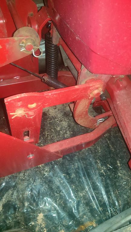

WVHillbilly520H

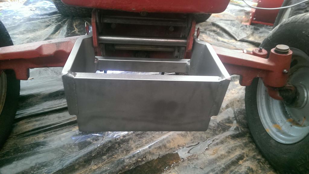

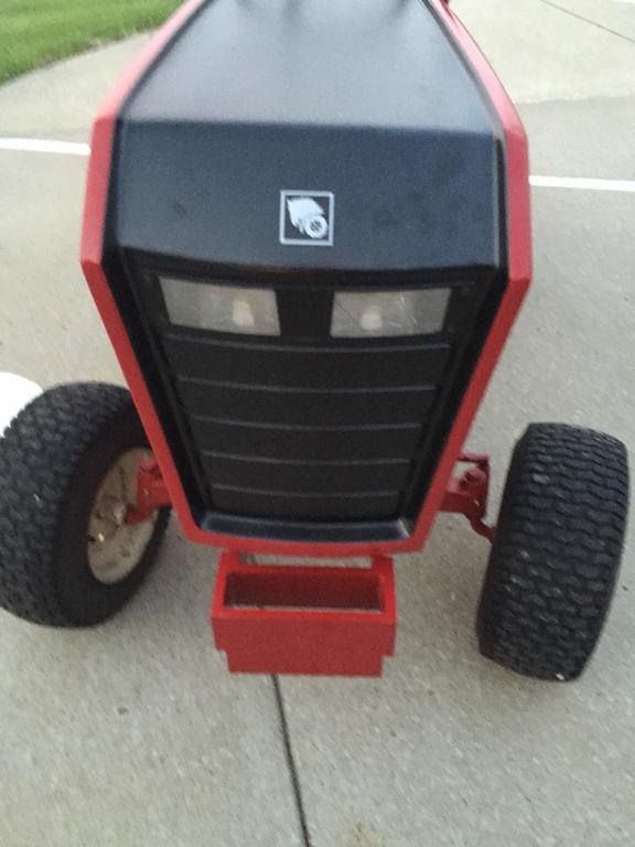

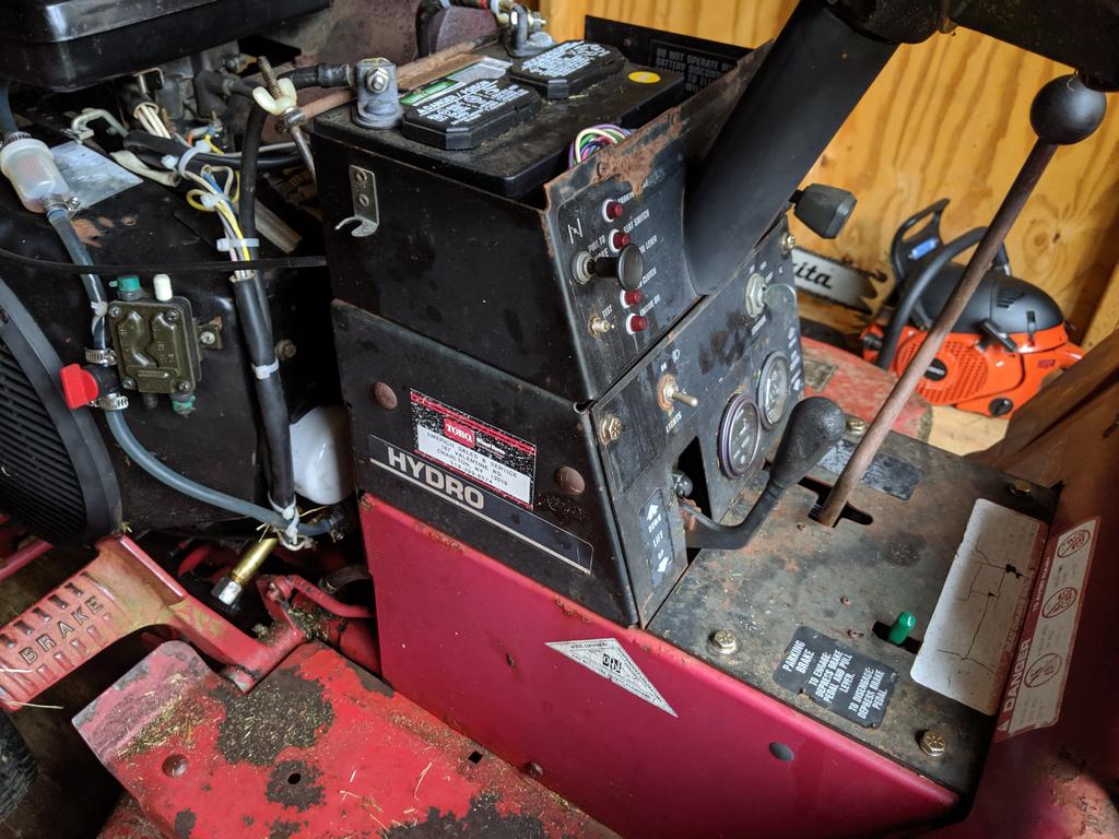

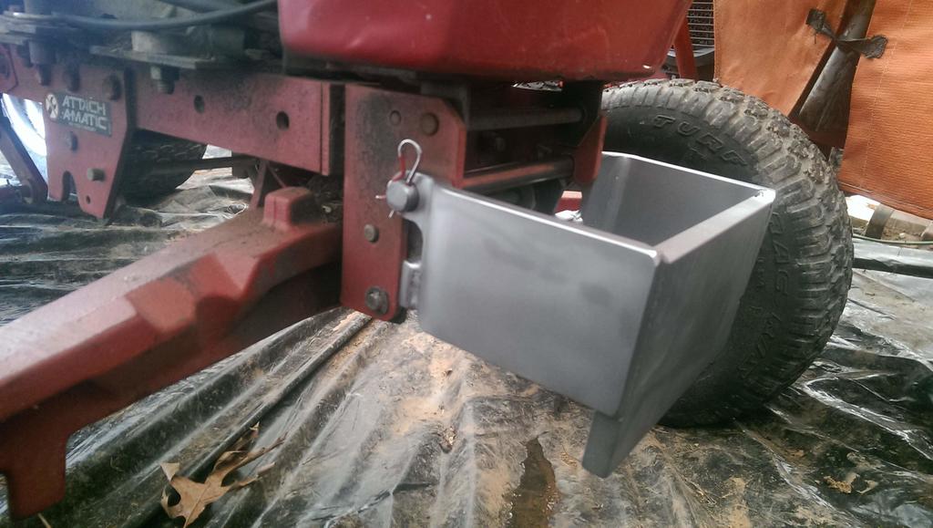

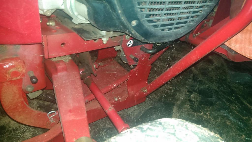

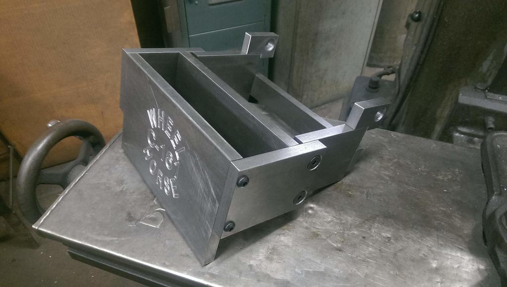

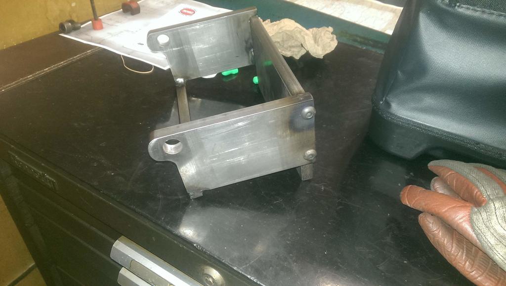

I have made front weight hangers for the B,C,3,4,500 series tractors a few years back... Then @cschannuth asked if I could make one for his dad's C161 and I had to add 3" and drop it it down about 1" to get it to clear the "Blackhood" versions vs the others so there's 99% of the issue and even when the 2stage is mounted on a 520 the hood still won't open fully unlike a single stage. Here's some pics of the differences.

WildmanC120

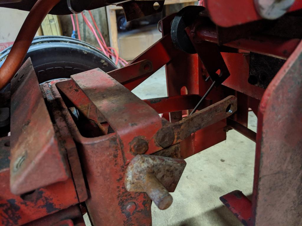

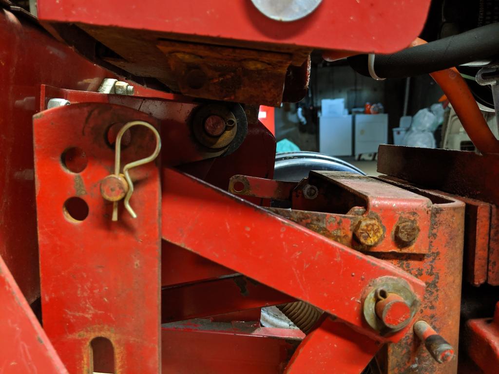

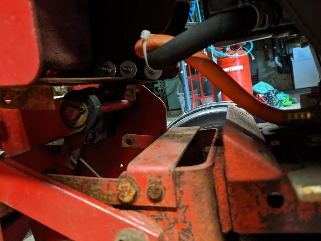

Figures I would have the only model that this blower will not work on.  I really need this unit to work as I just do not think the single stage will cut it according to the neighbors.  Here are some pics of what I am up against.  This black hood is super long and sticks way forward.  You would have to raise it 3-4 inches to make it work in the front.  I wonder if a 3/4/500 series hood would fit this???? I have plenty of room between the hood and front of engine.

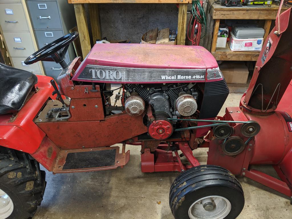

I think I'll pull the hood off my 416 and see if it fits.  If it fits then I'll buy another of that style good to run on it for the winter
WildmanC120

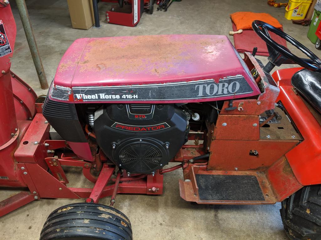

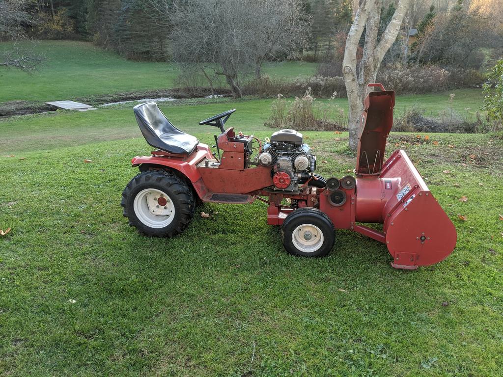

Ok so I think I made some progress. I took the hood off my 416 and mounted it. I discovered that I gained all the clearance I need on the front, no more hitting the hood and it even clears my engine ok.
Next issue is that this dash is different and now the hood is not long enough in the back.  After looking at both tractors it appears I can just swap the battery tray bracket/dash bracket and essentially convert this to a 300/400/500 series.
What do you all think???
wallfish

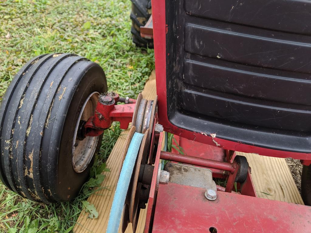

What does the C-160 hood look like on there? I see a C-160 in your signature
Is that a 1/2" wide belt on the blower? Should be a 5/8 wide. It looks to be sitting deep into the pulley grooves and very close together from the top and the spring tensioned idler pulley. If they rub, especially in different direction of travel, it will wear very quick. That idler will bounce a little under changing loads so make sure they won't touch.
I didn't try the 160 hood. I don't think that will be close to fitting. It's too small or WH would have ran that instead of making that fiberglass thing.
As for the belt, yes it's a 1/2".  It's what came with the blower when I got it this fall.  I plan on getting a new belt and will need a slightly shorter one due to the location of my engine.
