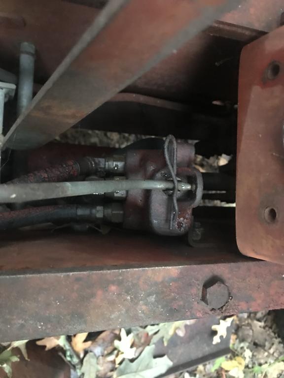

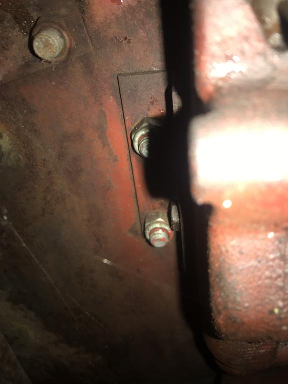

It appears I have a completely different valve than you - I assumed it had float, but I could certainly be wrong. If you press it down all the way, it will "click" into position and stay there. I assumed that was the float position. My valve doesn't have any caps on it all. Your unit looks more similar to the one on my C-160. I'll have to look at it.
Here are a few pics of the GT 14 valve.
Edited by ZXT
pacer
Yes, that is the way the MF is also - slight pressure in the down direction and it will 'click' there and hold. But! I really dont know for sure that it does actually 'float' as the mower deck is difficult to know whether it is or not.... But the manual says it does have a float valve there....
