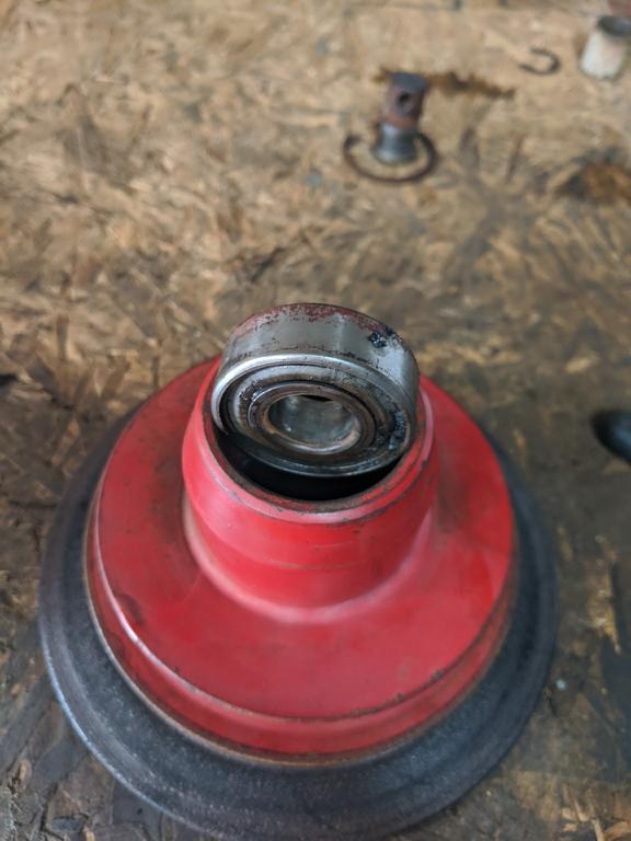

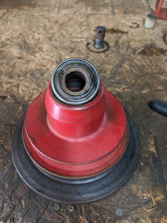

WildmanC120 613 #1 Posted October 26, 2019 Anyone know what bearing I need here for this? This one is destroyed. Surprisingly the needle bearing inside is in great shape and even greased. Thanks Share this post Link to post Share on other sites

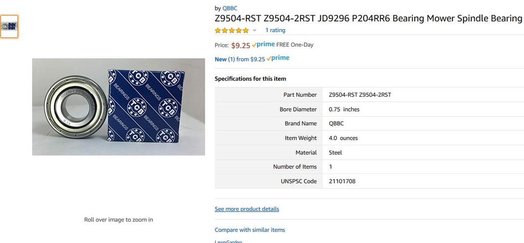

JoeM 7,874 #2 Posted October 26, 2019 Looks like a Toro: 109842. got one last week on EBay $5.69 Z9504-RST Lawn Mower Bearing 3/4" Bore 204BBAR P204RR6 JD9236 JD9296 T 1 1 Share this post Link to post Share on other sites
pfrederi 18,090 #3 Posted October 26, 2019 WH 106947 1 Share this post Link to post Share on other sites
peter lena 8,943 #4 Posted October 26, 2019 looks like that bearing spindle , at pto lever point , is worn , was that running dry? good point for some lucas red and tacky grease, it really stands up in tough areas, also detail lubricate entire pto lever set up, usually dry and rusty starting from bottom side of battery in dash. to lever pto end point, pete Share this post Link to post Share on other sites
Burnerman 759 #5 Posted October 26, 2019 Just replaced mine. Easy peasy. Just need a decent snap ring plier. 109842 was the toro # I think. My lever doesn’t jump all over now. 1 Share this post Link to post Share on other sites
