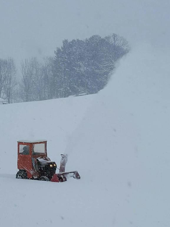

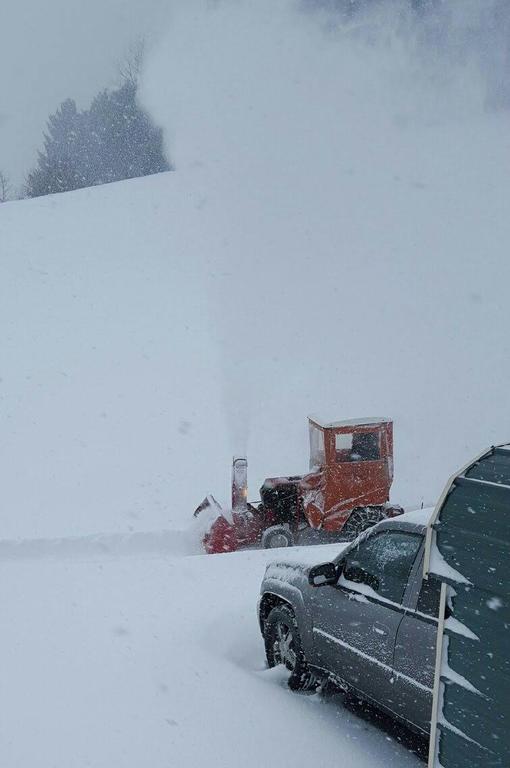

This is what 20hp hydro will do with a 2stage in nearly 2ft of snow and my single did just as well but would clog up in the DOT plow banks at the end of the drive way...

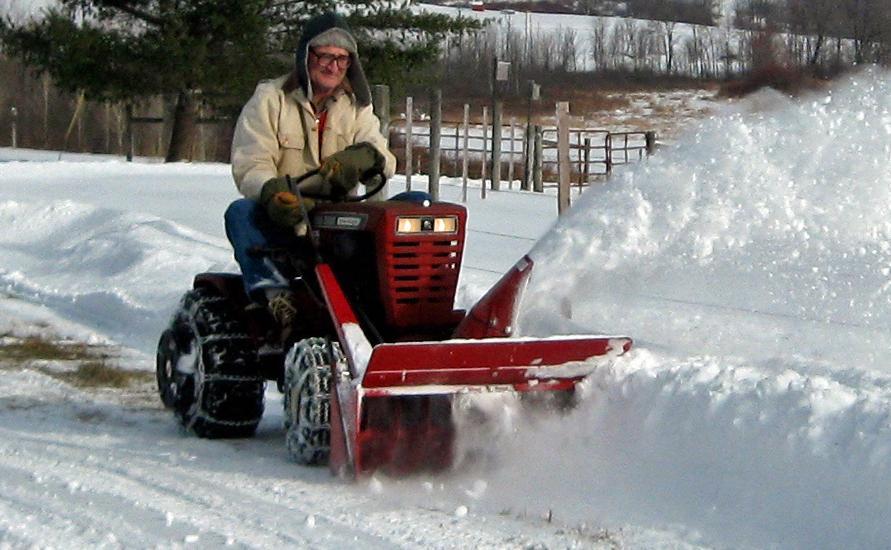

I do not need  (or want) to blow snow 30' in the air.  I live on a windy hill and it would probably wind up back in the driveway.  i just need to get it out of the driveway.  The 12hp charger (Pictured) did it for several years with out any problems.  Have now switched blowing duties to the Electro 16 I guess it will go a bit faster...

Its was closer to only 20' in the air and 30'+ to the side... And it was very windy that day and I also need to get out if the driveway but also make sure there's room for the next storms...
