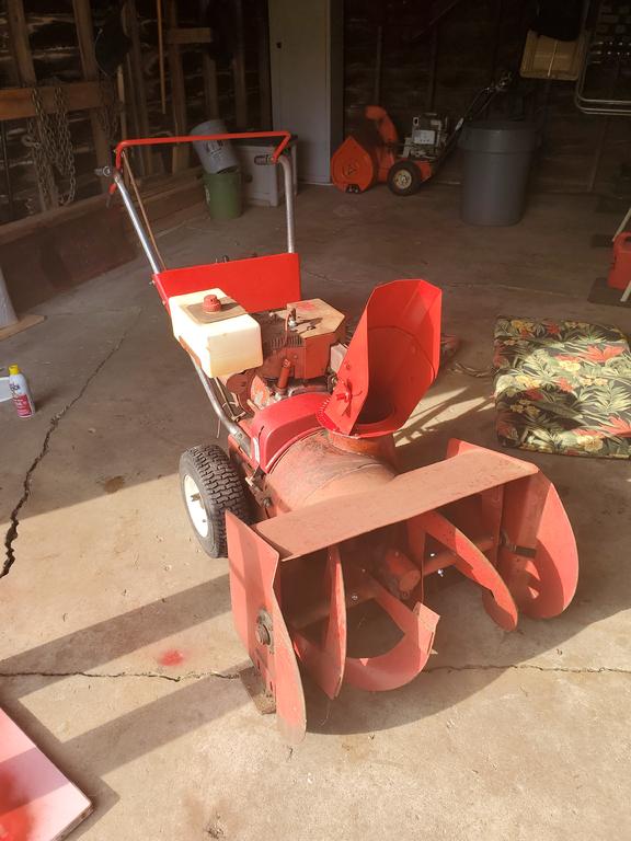

Having gone through my Trailblazer 7 this last yr, for her maiden 1st season with me, and doing a partial paint resto---to be done next yr---here i am.

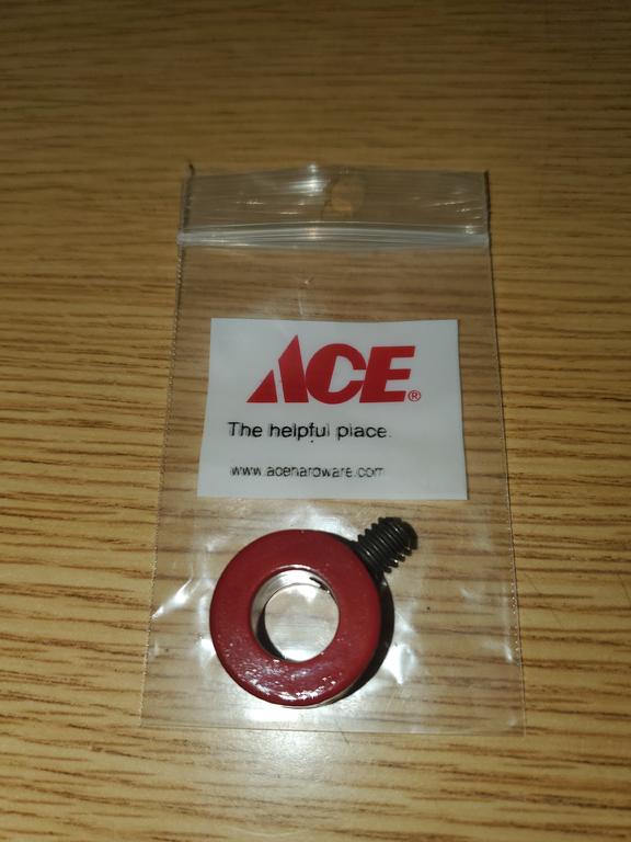

And what i cant figure out is where this 'collar' goes, exactly? I know it goes on the clutch rod, but where? It was riding at the bottom, loose, when i got this beast...the ACE baggie in the pic held the missing set screw i bought, lol.

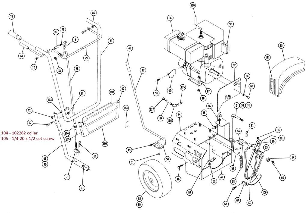

Just a guess but shows up for a few models.
May have something to do with the eyebolt.
Garry

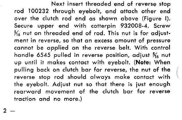

Found this on page 2 which is slightly different but suspect the design changed. Looks like a nut on this one limits the rod travel when it hits the eyebolt. Collar would do the same thing.
