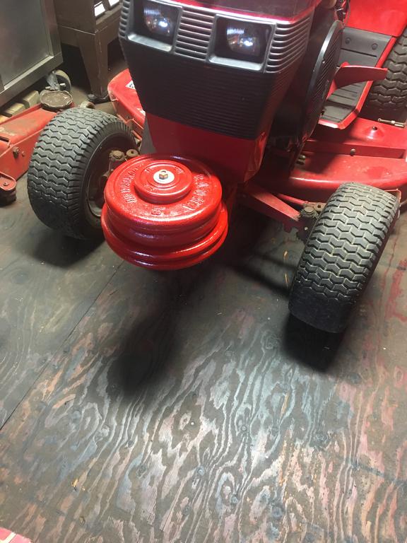

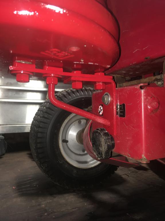

formariz 11,993 #1 Posted October 22, 2019 (edited) I use my 520 a lot to pull a regular trailer into and around property with a considerable amount of weight and steering is always a problem. Needed quick front weight without removing mule drive. Devised this simple quick bracket with unistrut parts to mount directly on the mule drive. It already had an existing hole in the correct spot. Now I can quickly add weight as needed. Edited October 22, 2019 by formariz 7 2 Share this post Link to post Share on other sites

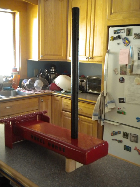

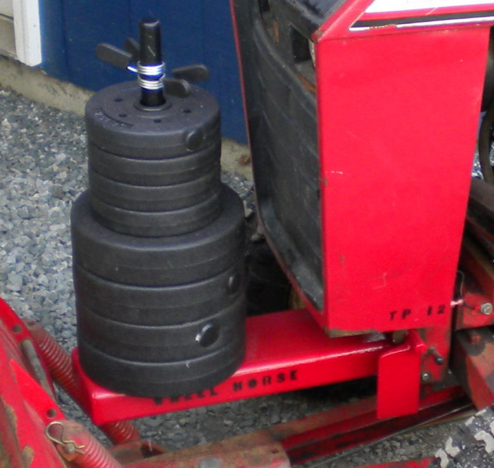

C-85 722 #3 Posted October 22, 2019 What a clever way of doing this I like it! Great way of adding weight and being able to still use the mule drive! This is what I did to get some weight out front - C-85 2 1 Share this post Link to post Share on other sites
