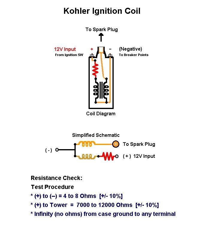

EDIT: Here's a picture I stole off the web. Should be the same procedure for you but with one extra spark plug wire tower.

The condenser keeps the points from burning out - it minimizes the arcing at the points so that they last longer. If it goes bad, you will see arcing at the points when you open and close them manually, but you won't have spark at the plugs. Boggles my mind as well.
Seeing that the voltage changes when you turn the engine over leads me to believe that the points are making contact, but maybe not good enough. I don't know the specifics on what the readings should be on the - side of the coil. I just know that most every engine that I've tested the - side on provided different readings.

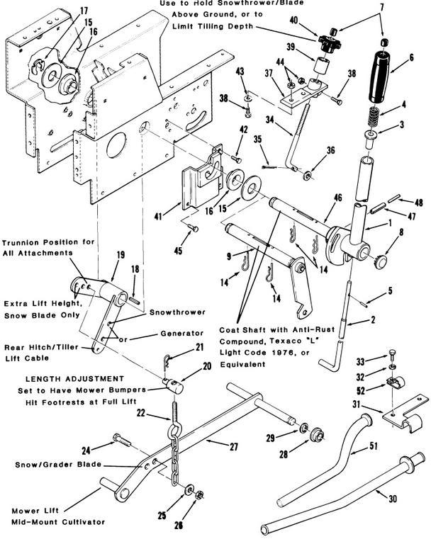

I got to plow snow withit yesterday!!!  How COOL!!   The plow is a factory model, but only lifts about 2 " off the floor.  I'm planning to drill a new hole or something to get it to lift higher.
You may not have the link in the right hole.See the note on part # 19
Gas Man
Thanks a LOT Richard!!  This might likely fix it!!
