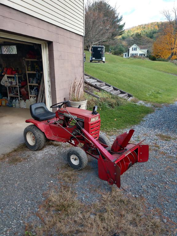

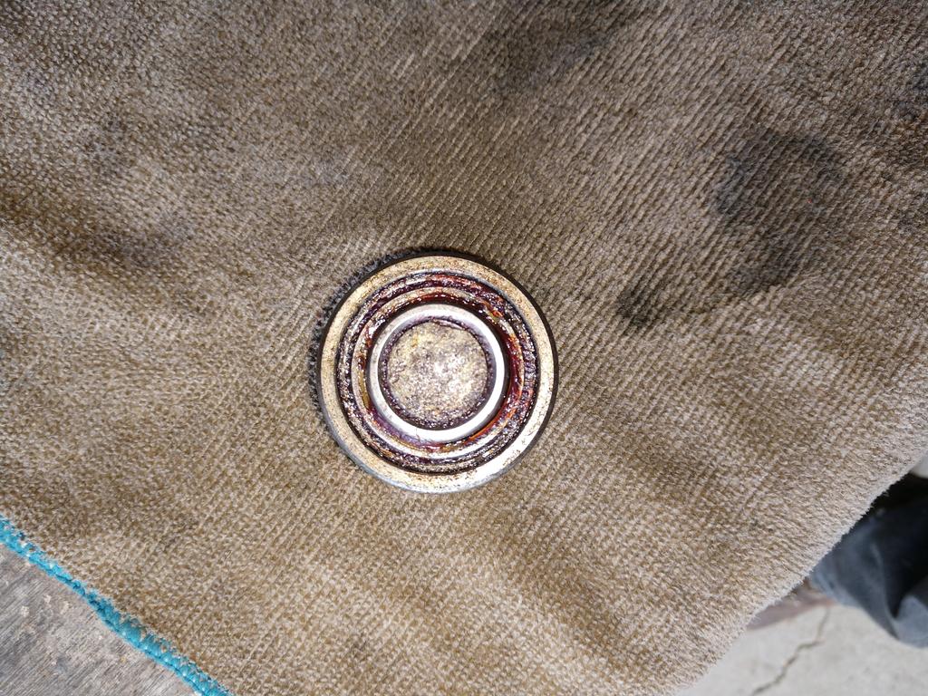

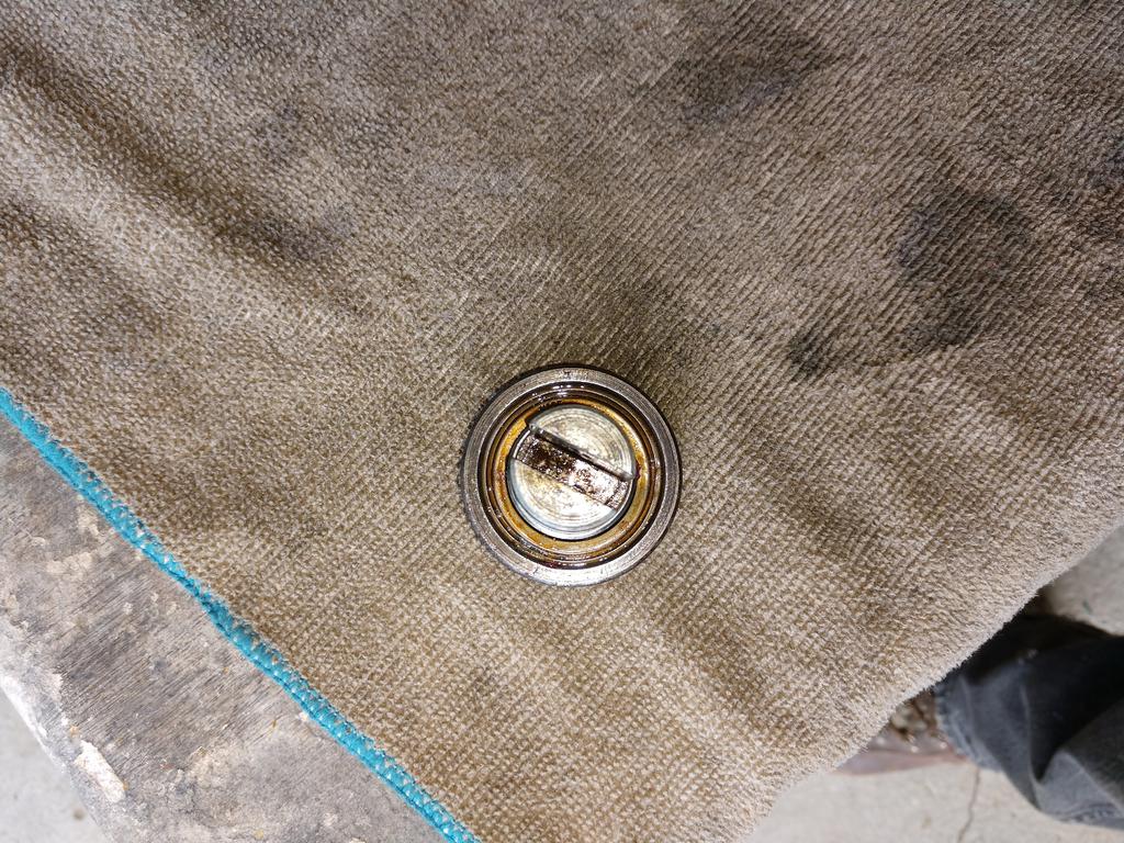

troutbum70 857 #1 Posted October 19, 2019 Is this a one piece unit as there are no snap rings to keep things together, or can the the center be pressed out. Did not want to attempt if it's not meant to come apart. This is on my commando 800. Also included a picture of the 800 getting ready for winter snow removal. Anybody else getting ready? 2 Share this post Link to post Share on other sites
76c12091520h 3,679 #2 Posted October 19, 2019 Separate pieces , should come out 1 Share this post Link to post Share on other sites
troutbum70 857 #3 Posted October 19, 2019 Okay tnx I thought it looked as though it would, but the others I am familiar with were held together with snap rings. Any idea what the bearing number should be? Share this post Link to post Share on other sites
Burnerman 759 #4 Posted October 19, 2019 (edited) https://www.ereplacementparts.com/toro-10110-1972-lawn-tractor-parts-c-121776_128672_128772.html You can scroll to the PTO breakdown. It looks like there is a c clip in there. 109842 is the toro on for that bearing. I needed 1 also. Just ordered 2 on flea bay for $15 Edited October 19, 2019 by Burnerman Share this post Link to post Share on other sites
squonk 41,522 #5 Posted October 19, 2019 Napa PP204RR6 or better grade P204RR6 Prime Line # 704250 2 Share this post Link to post Share on other sites
adsm08 2,208 #6 Posted October 19, 2019 9 hours ago, troutbum63 said: Also included a picture of the 800 getting ready for winter snow removal. Anybody else getting ready? I'm straddling the line between summer and winter. Plow on one tractor, mower deck still on the other. 1 Share this post Link to post Share on other sites
troutbum70 857 #7 Posted October 20, 2019 My 417 has the mower on and it has mowing to do this week if time and weather co-operate. Share this post Link to post Share on other sites
troutbum70 857 #8 Posted October 20, 2019 Also they make a good looking pair. Share this post Link to post Share on other sites
troutbum70 857 #9 Posted October 20, 2019 Every blow up I have looked at shows two snap rings a 3/4 inch and a 1 3/4 inch, this one has none and I put about 2 hundred foot pounds on that one to separate it and could not get it to budge. Guess I need to put 12 ton jack into action. Share this post Link to post Share on other sites
Burnerman 759 #10 Posted October 20, 2019 9 hours ago, troutbum63 said: Every blow up I have looked at shows two snap rings a 3/4 inch and a 1 3/4 inch, this one has none and I put about 2 hundred foot pounds on that one to separate it and could not get it to budge. Guess I need to put 12 ton jack into action. 😮 Share this post Link to post Share on other sites
adsm08 2,208 #11 Posted October 20, 2019 9 hours ago, troutbum63 said: Every blow up I have looked at shows two snap rings a 3/4 inch and a 1 3/4 inch, this one has none and I put about 2 hundred foot pounds on that one to separate it and could not get it to budge. Guess I need to put 12 ton jack into action. This is why I own a 20T press. I don't mess around. Share this post Link to post Share on other sites
troutbum70 857 #12 Posted October 20, 2019 Always better to have to much rather than to little, which is normally my situation. 1 Share this post Link to post Share on other sites
adsm08 2,208 #13 Posted October 20, 2019 3 hours ago, troutbum63 said: Always better to have to much rather than to little, which is normally my situation. Exactly. I once took a wheel bearing up to a friend's place to use his 12T press on it. After we still had to get the torch out I went and bought the 20T. We haven't had an issue with hitting the pressure relief on a press since. Share this post Link to post Share on other sites
troutbum70 857 #14 Posted October 20, 2019 If I have to I have a friend that's a 25 or 30 ton press. Share this post Link to post Share on other sites
Burnerman 759 #15 Posted October 20, 2019 I was gunna mess with mine today on my 20t press while I was pressing out spindle bearings. But after reading about the trouble you’re having but I chickened out. I have the new bearing coming. I’ll try it tomorrow after work and report back. Share this post Link to post Share on other sites
lynnmor 7,361 #16 Posted October 20, 2019 Do not press the shaft in a new bearing if it is too tight, instead fit it properly so that it is a light press fit. Share this post Link to post Share on other sites
troutbum70 857 #17 Posted October 21, 2019 I have a second pto bell that I just picked up a couple weeks ago, but the shaft is quite loose in the bearing. But bearing fits nice and snug in bell, the bell that came with the tractor the bearing is lose in the bell. So I was going swap bearings and shafts if I can get the shaft out of the bearing that came with the tractor, I really thought I should be able to press it out in a large vice. May try sticking it in the freezer over a night and see how that works. Share this post Link to post Share on other sites
