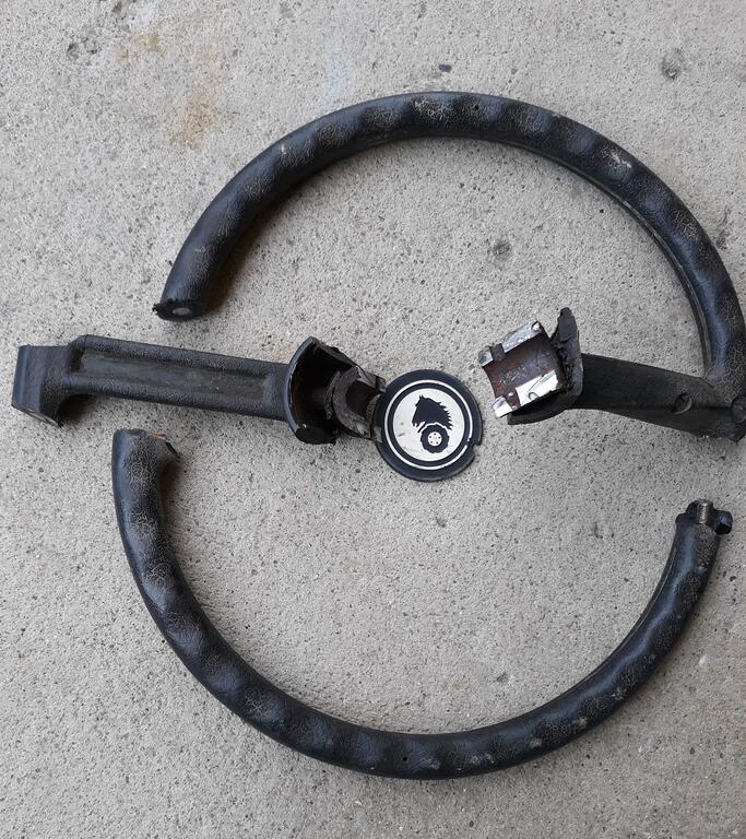

1973Auto 80 #15 Posted May 6, 2020 Well I finally got around to replacing the steering wheel, Angle Grinder 1, Steering wheel 0!!! 1 2 Share this post Link to post Share on other sites
pacer 3,175 #16 Posted May 7, 2020 Geez, aint that something!!! First time Ive seen that method --- I bet last fall when all that talk about how hard they were to remove you probably was thinking "Aw that thing CANT be THAT hard!! Made a believer out of ya didnt it Share this post Link to post Share on other sites
Lee1977 7,023 #17 Posted May 7, 2020 I see you got the wheel off how about the roll pin did it give you much trouble? Share this post Link to post Share on other sites
1973Auto 80 #18 Posted May 7, 2020 Pacer/Lee: The kicker was the other steering wheel, that was still good, the pin push out with no issues.This one wouldn't budge!! then I drilled it out,only half the pin can out,then more hammering, then after about 10 minutes of pissing around with it,I said,F-it,and got the grinder. It was rusted on pretty tight,even with WD and other stuff I put on still wouldn't budge. The wheel was broke anyway so I didn't care what I had to to get it off. Soo!!! It if off!!!!! Share this post Link to post Share on other sites
