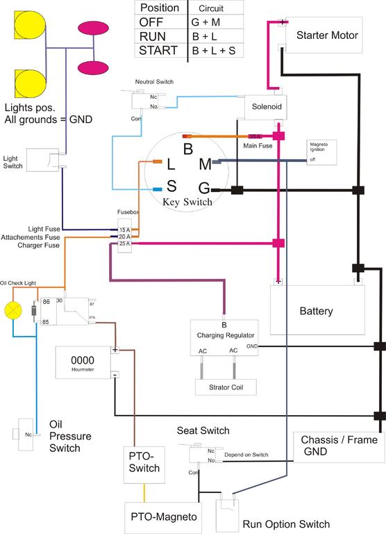

Figured out the design flaw. I goofed up, and I accidentally put the charging wire to the B terminal (always connected to battery) when it's supposed to be on the L terminal (only connects when key is in the run position). That explains a lot and is why the original diagram for the snapper didn't have an R terminal or a diode...
Tractorhead
So, did it.
Here is the Complete Wireing as i did in my Tractor.
As Suggested and one Year approoved.
The 2 Master Gimmicks are:
1.) The Hourmeter just runn's if engine is running and the Oilpressure is up ( also shown on Oil Control Lamp).
2.) The Seatswitch doesn't interrupts staring, it interrupts the PTO and optional the Ignition, selectable by the Switch.
If you are Mowing, and you must short standup for remove a thing. the PTO is allway's automatically stopped for Safety,
but the tractorengine is optional able to continouse run with the Optional Switch.
A Restart of the Engine depends mostly more time than just shift the Neutral in.
IF the Option Switch is in "Active Mode" also the Engine will be shutdown if Seatswitch is Activated.
In my Case this was the best solution until now.
