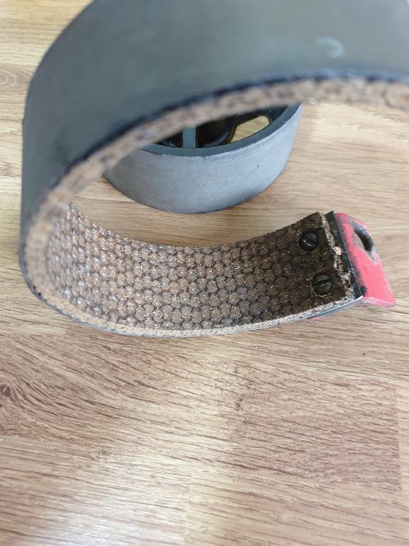

Mickwhitt 5,015 #16 Posted October 15, 2019 Hi all, I was recommended to try custom brakes and hydraulics in Sheffield. The reline anything from giant cranes to classic cars. They will reline and bond the material in place for £30 which is ok by me. Guaranteed repair so some peace of mind. I will post pics when done. Regards Mick 2 Share this post Link to post Share on other sites
Mickwhitt 5,015 #17 Posted October 17, 2019 Managed to sort out a newly lined brake band using these guys from Sheffield. Dropped it off at 10am and it was ready to collect at 3pm. Cost £40 for cash. They said if it has friction linings, we can handle it. So PTO clutch linings should be ok as well. 1 3 Share this post Link to post Share on other sites
