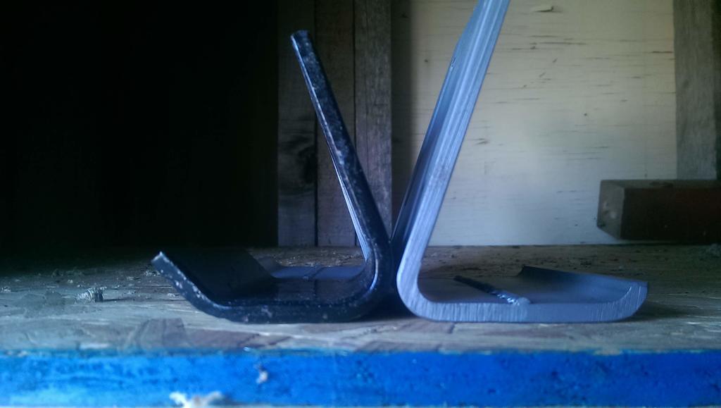

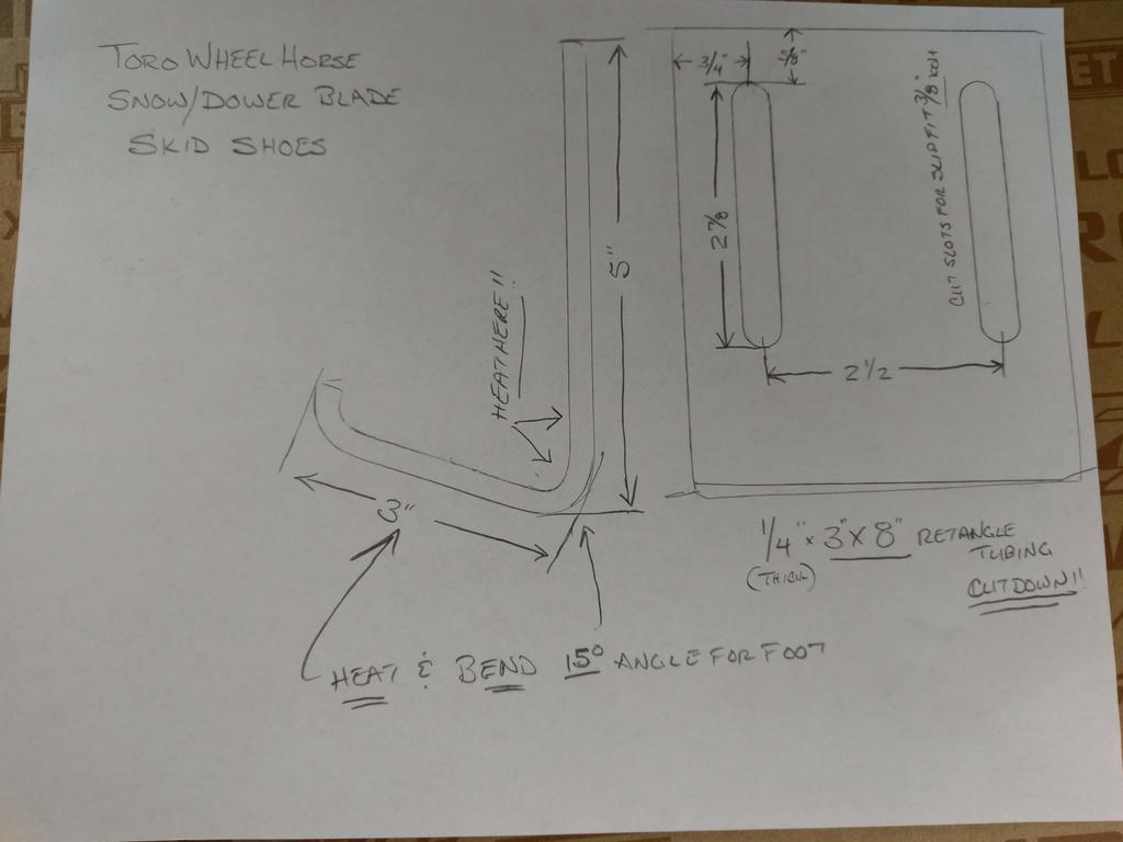

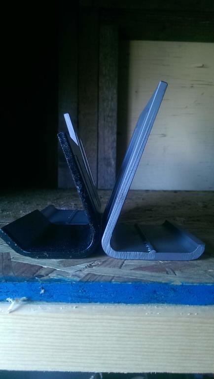

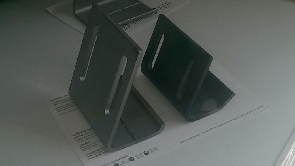

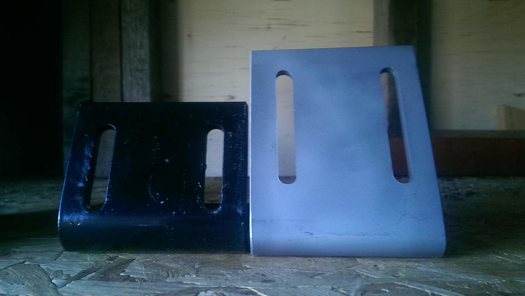

WVHillbilly520H 10,376 #5 Posted October 12, 2019 55 minutes ago, ebinmaine said: @WVHillbilly520H Had a plan to build some.... You mean these... Didn't you get my last set... I believe at @elcamino/wheelhorse has a set of mine as well so @richmondred01 Mark give Jim a shout to check out mine vs Toro. 3 Share this post Link to post Share on other sites
richmondred01 2,287 #6 Posted October 12, 2019 No I didn’t get a pair. let me know if you make some more. Thanks. Share this post Link to post Share on other sites
ebinmaine 70,390 #7 Posted October 12, 2019 9 hours ago, WVHillbilly520H said: Didn't you get my last set T'was I . Yep. I'm intending to get them on the 48" plow this fall. 1 Share this post Link to post Share on other sites
