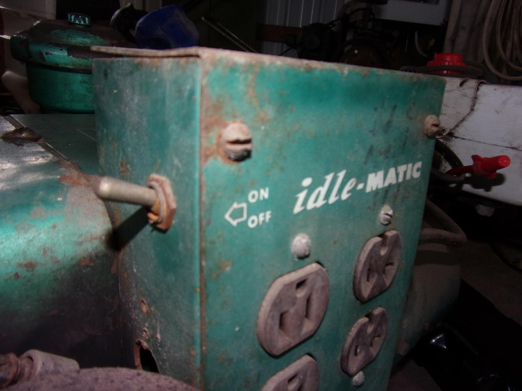

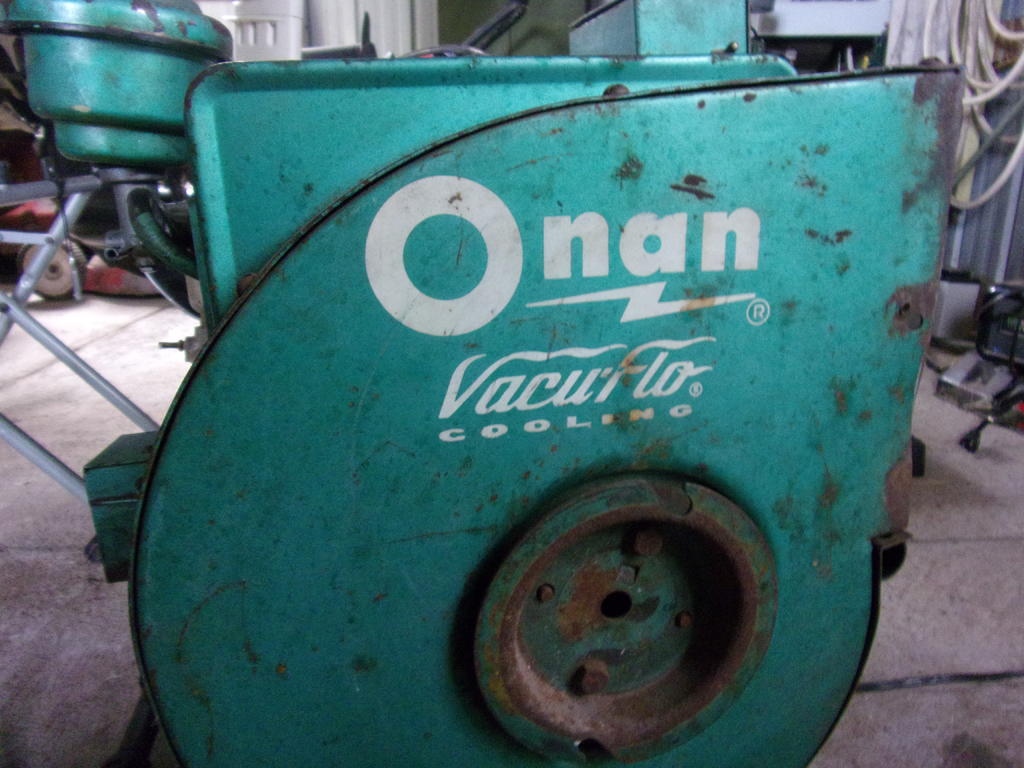

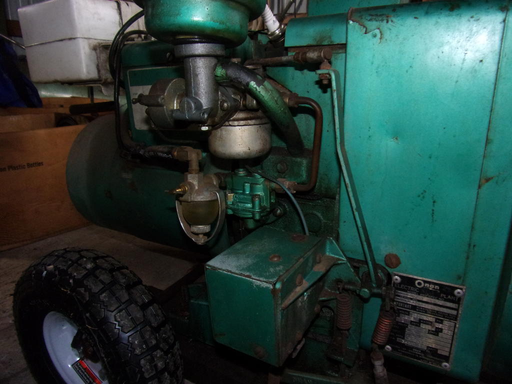

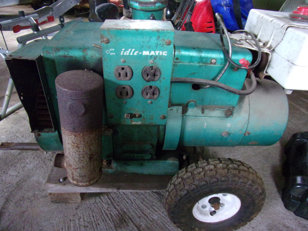

Ed Kennell 39,787 #6 Posted October 8, 2019 I rescued a 2500 watt ONAN gen set from a scrapped '70s era Snow Cone truck. It was used to power the freezer for the crushed ice. The unit was hard wired into the truck battery and started and charged the battery. The fuel line was also plumbed into the trucks fuel tank. I added a fuel tank, wheels, and a retractable tongue for towing. I didn't add a battery because it starts so easy with the rope. In addition to the 120VAC output, It also puts out 13VDC and could be used as a battery charger. It has the idle switch. When this is on, it only revs up when it sees a load. 1 1 Share this post Link to post Share on other sites
