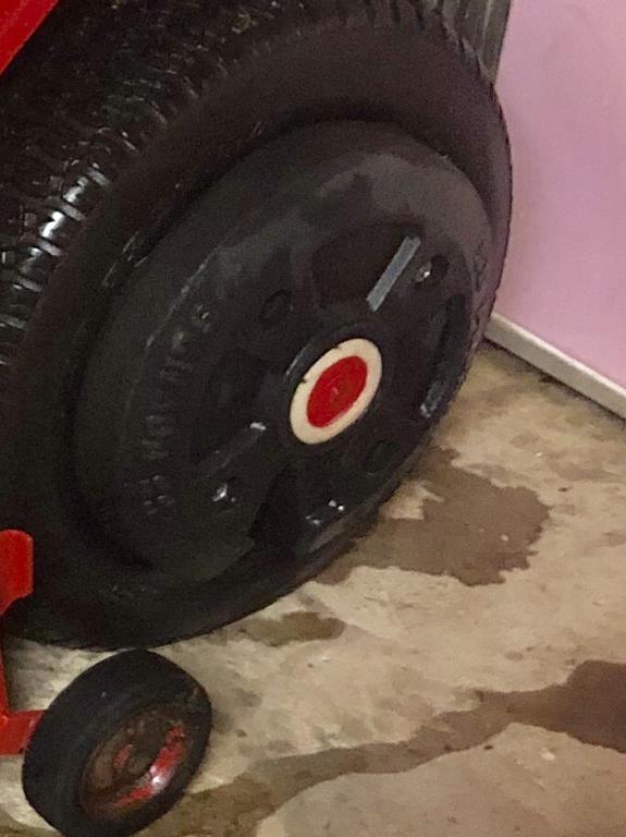

The Tuul Crib 7,352 #2 Posted October 7, 2019 25 minutes ago, troutbum63 said: My question is does any one know what is used inside the plastic cover with craftsman wheel weights? I have a person offering me a pair of craftsman wheel weights at a very good price, but the mounting bolt spacing is only 5 1/2 inches. My wheels the spacing is 6 1/2 inches. I am wondering if I can turn them 180 degrees and drill new holes or if there is a compound in them that will run out when I drill the first hole? Or my other option is to turn the wheels 180 degrees a make new holes if they would clear the hubs. These are 55 lb. weights. Tnx for any and all input. Do they look like this? Share this post Link to post Share on other sites
troutbum70 858 #3 Posted October 7, 2019 I have not seen them as they are 75 miles away. But have wondered if they are 55 pounders why the bolt spacing is so short, but he measured them at 5 1/2 inches. He sent me a picture not a close up, but they are for sure craftsman. Share this post Link to post Share on other sites
