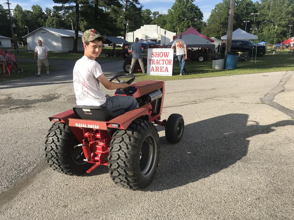

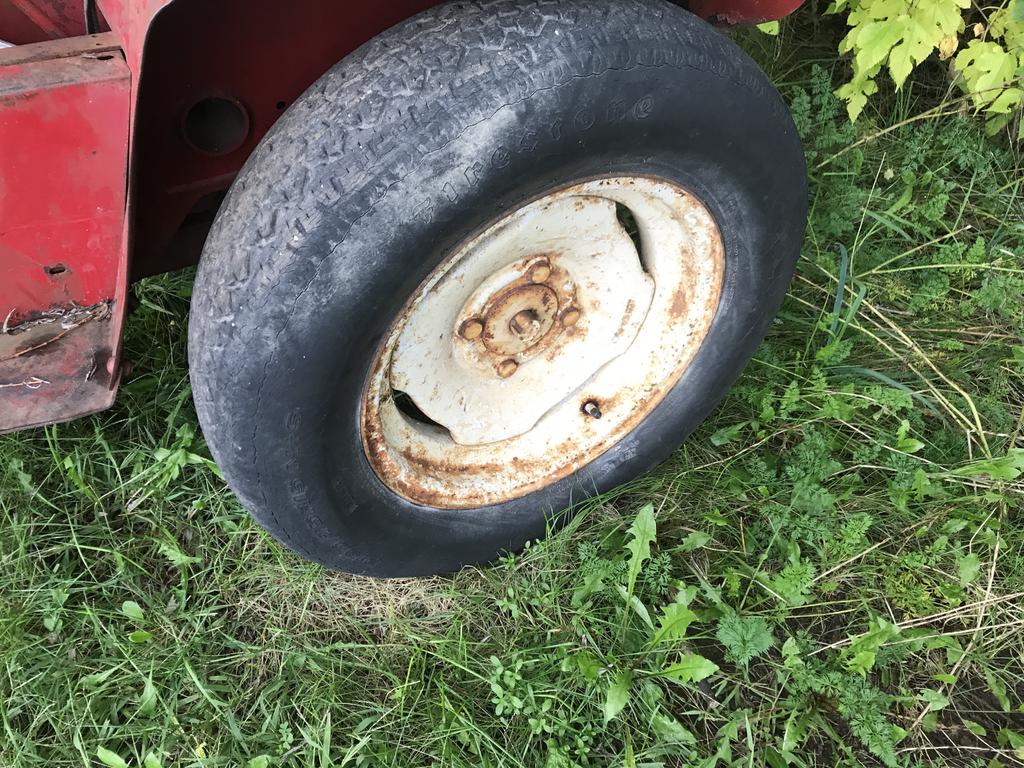

PeacemakerJack 10,743 #7 Posted October 5, 2019 Also keep in mind the ever growing ATV/UTV market. Lots of options there if you can find a tread pattern that suits you. Check out the awesome tires on the rear of @19richie66‘s GT-14... These are ATV tires! Super cool looking and versatile. Another option if you don’t care about looks but need something cheap and easy for the short term... These are p195/75/15. I would go with a 205 or even a 215 for the wider GT-14 rim. Again just some thoughts to mix into the mental “soup”... 2 Share this post Link to post Share on other sites
Machria 78 #8 Posted October 6, 2019 23 hours ago, PeacemakerJack said: Also keep in mind the ever growing ATV/UTV market. Lots of options there if you can find a tread pattern that suits you. Check out the awesome tires on the rear of @19richie66‘s GT-14... These are ATV tires! Super cool looking and versatile. What size are those?? They look like they would work, I need something that will last, and work in the snow. I only use my GT14 for snow blowing and as a mule to haul firewood around my yard. Share this post Link to post Share on other sites

19richie66 17,578 #15 Posted October 9, 2019 (edited) On 10/6/2019 at 12:08 PM, Machria said: What size are those?? They look like they would work, I need something that will last, and work in the snow. I only use my GT14 for snow blowing and as a mule to haul firewood around my yard. They are 26-11x15 maxxis ceros radials. Not cheap but very grippy. Wouldn’t know about snow as we have none here in Florida. I plan on using thier 27-9.50x15 on my wife’s 1054. Those in the pic were $150 each but were bought for something else that never materialized. They are right at home where they are though. Edited October 9, 2019 by 19richie66 1 1 Share this post Link to post Share on other sites
