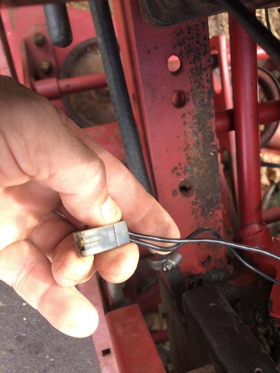

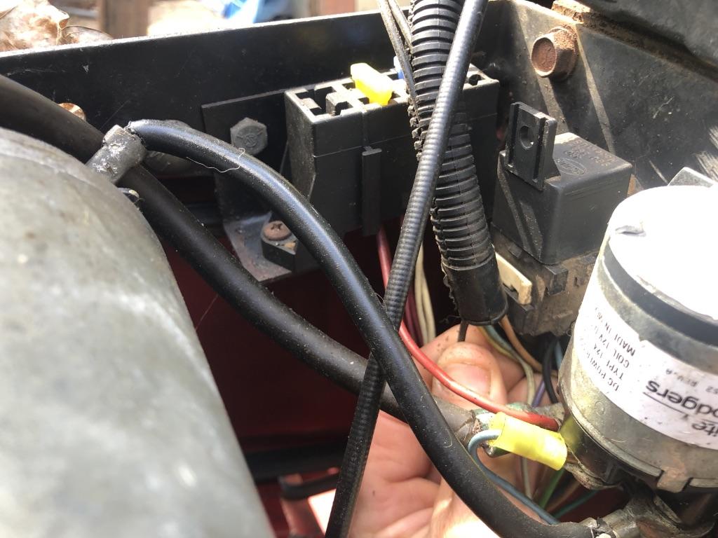

I picked up a wheel horse and I am having trouble finding the connection for this wire. I have no spark and  have searched for the placement of this wire within the distance of its length...any ideas?...can't seem to paste the picture....

One wire comes from the harness and the other into the relay? connection on the left side of the tractor. Thanks!

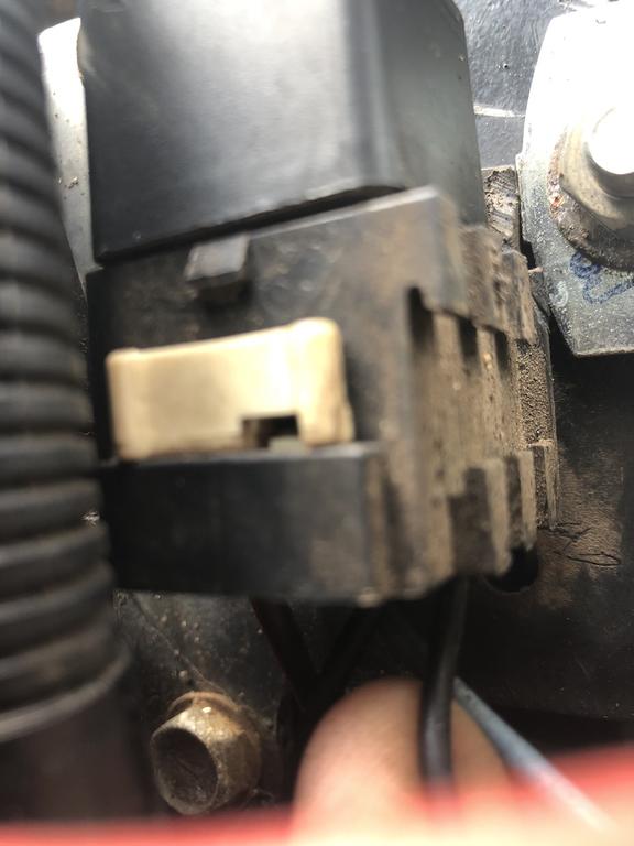

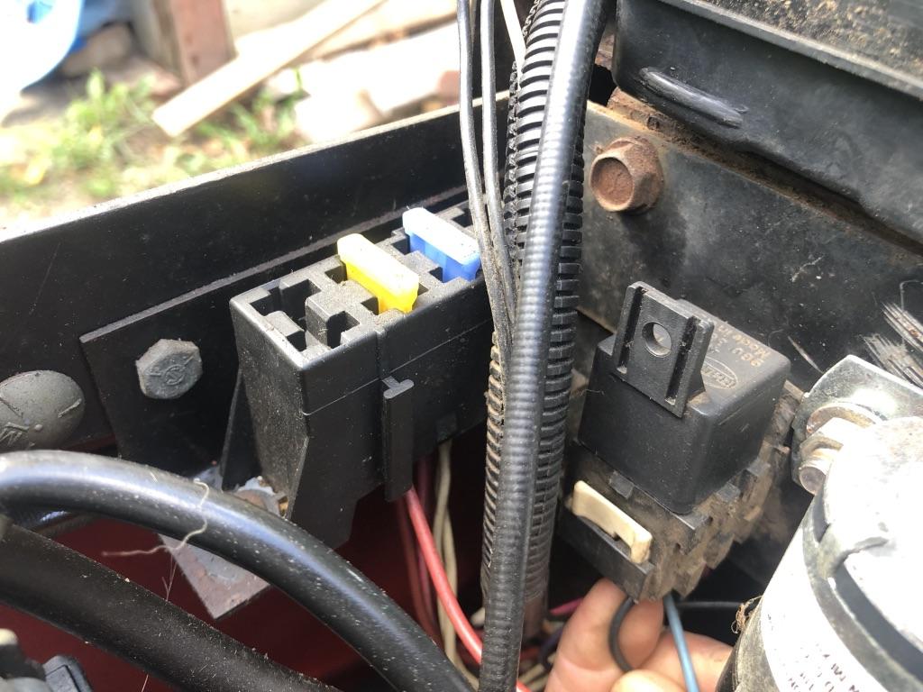

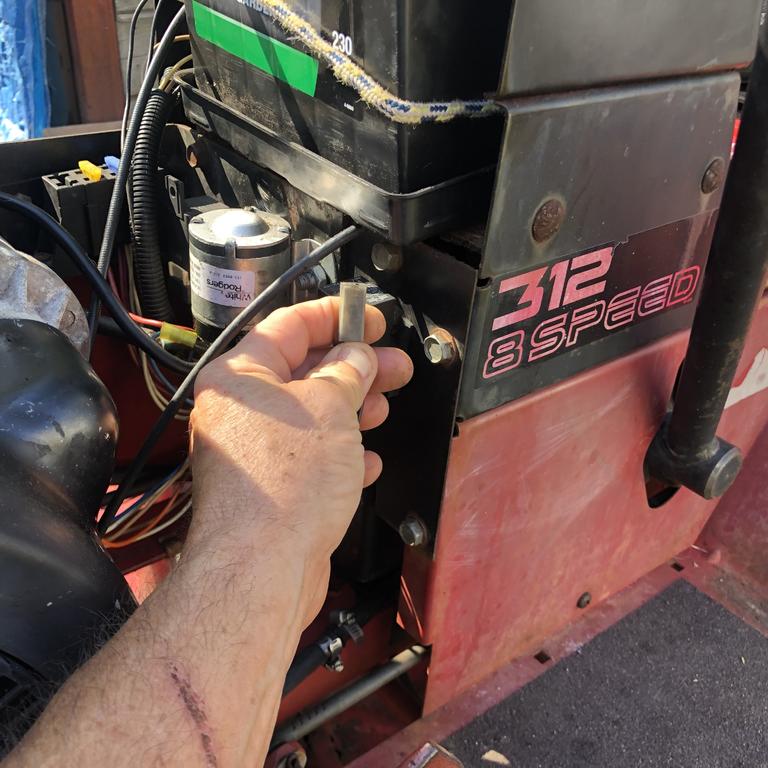

That appears ti be the "Seat Switch Relay". If you can tell us what year 312-8 you have we can give you a detailed wiring diagram of each system.
  • Like 1
gwest_ca
Two wires into 1 terminal or 2?

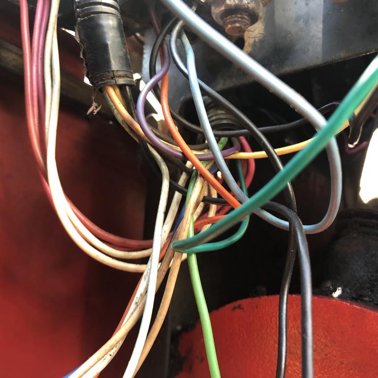

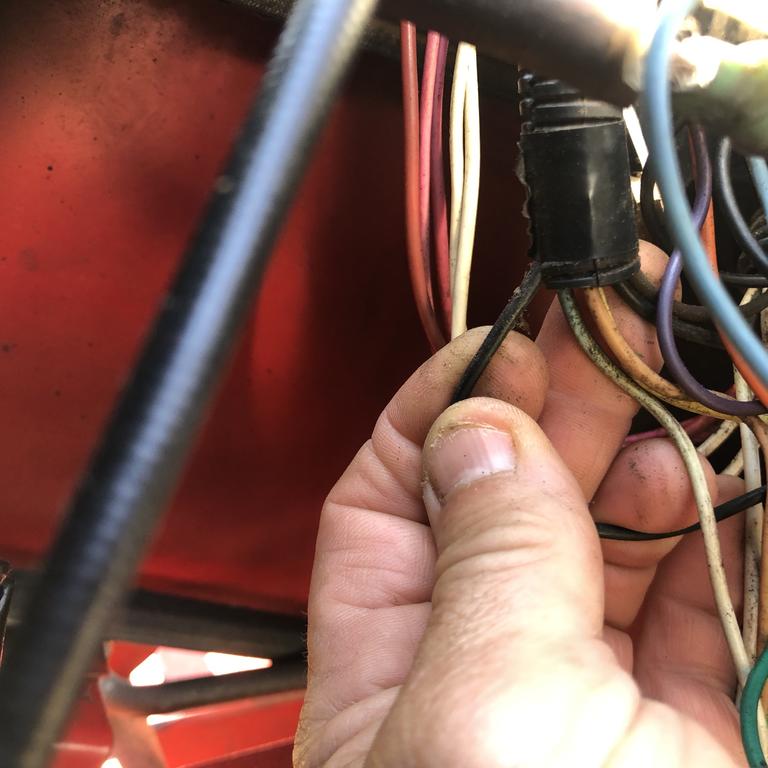

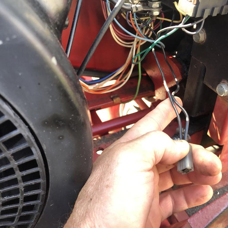

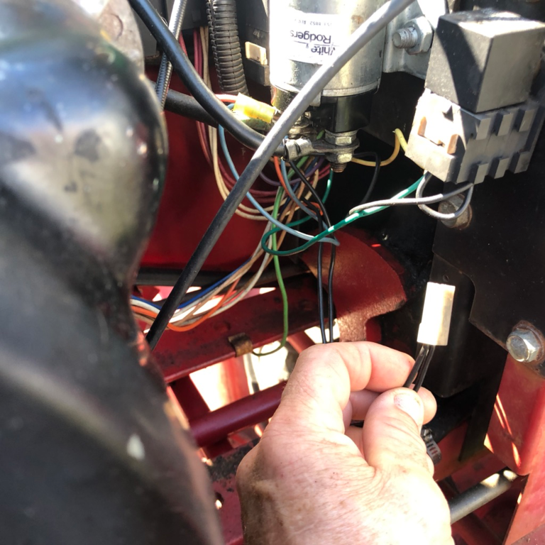

Thank you for your responses. The seat switch relay seems to be working because it will not turn over unless I am sitting, I am not sure if that fact rules out the switch relay?  I am also not sure of the year, I will look for markings...is there a probable spot on the frame or engine to look? One of the  2 wires come from what looks to be the main harness picture added and the other comes from the terminal  on the right side...picture added..

I guess it can be a Neutral Switch connector, or a „Clutch pressed“ switch.
without exactly knowing of your tractor‘s details, i would look for a Switch mount near Clutch Pedal or link
or maybe PTO.

The tractor ID decal was likely under the left side of the seat on the rear fender pan.
Post all the numbers off the engine data decal including the serial number. May be able to identify with those.

I'm not a big wiring expert, but from the photo did you check under the fuse that is missing?

Being the wires are black which are usually grounds it may be for the original solenoid that required one of the small terminals to be grounded.
