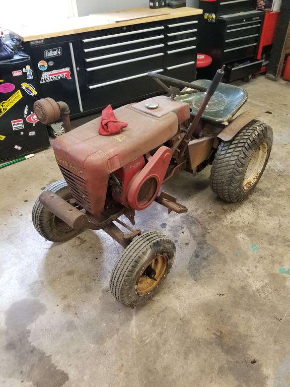

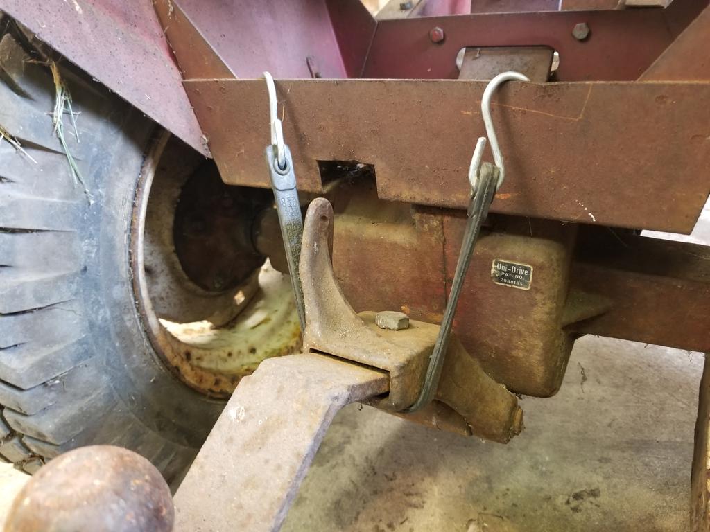

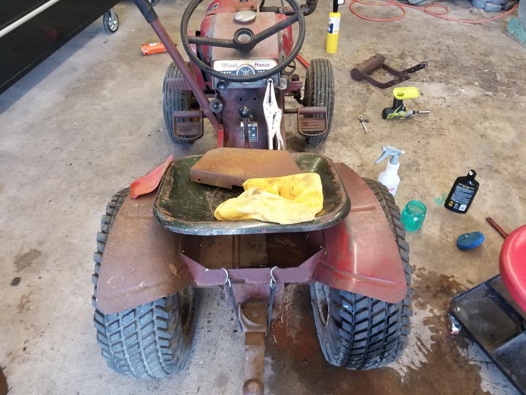

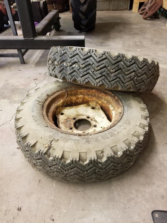

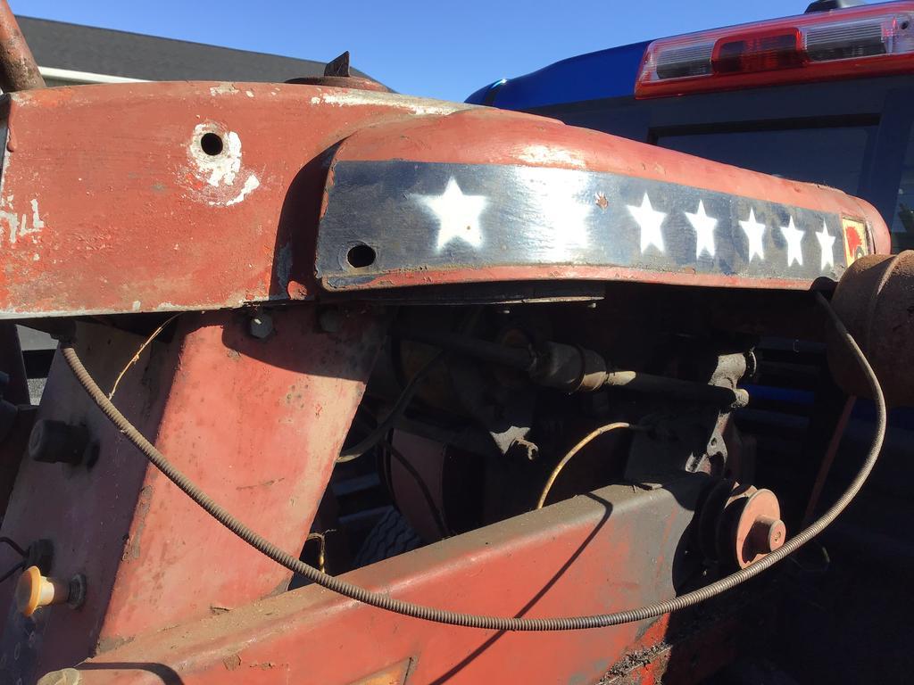

Unfortunately the tractor supply down the road from me didn't have the battery in stock. So no go on cranking it over today. Still had a few moments to look it over. Aired up the tires to see if they would hold air overnight. There's a hitch assembly on the back that I have a question about. There seems to be a spot on it that accepts a pin and the frame is notched out in the same area. Am I missing a piece? My buddy also had another set of tires as well. They are skinnier than the ones on it right now. Are they for plowing snow or something? I'm throwing another picture of it up now that it's in my garage. Who doesn't like more pictures?
Lowell can fix you up with the lift cable.
https://www.wheelhorsepartsandmore.com/cables.html#!/Reproduction-Lift-Cable-for-Wheel-Horse-3931-see-application-chart-in-ad/p/84954740/category=23548045

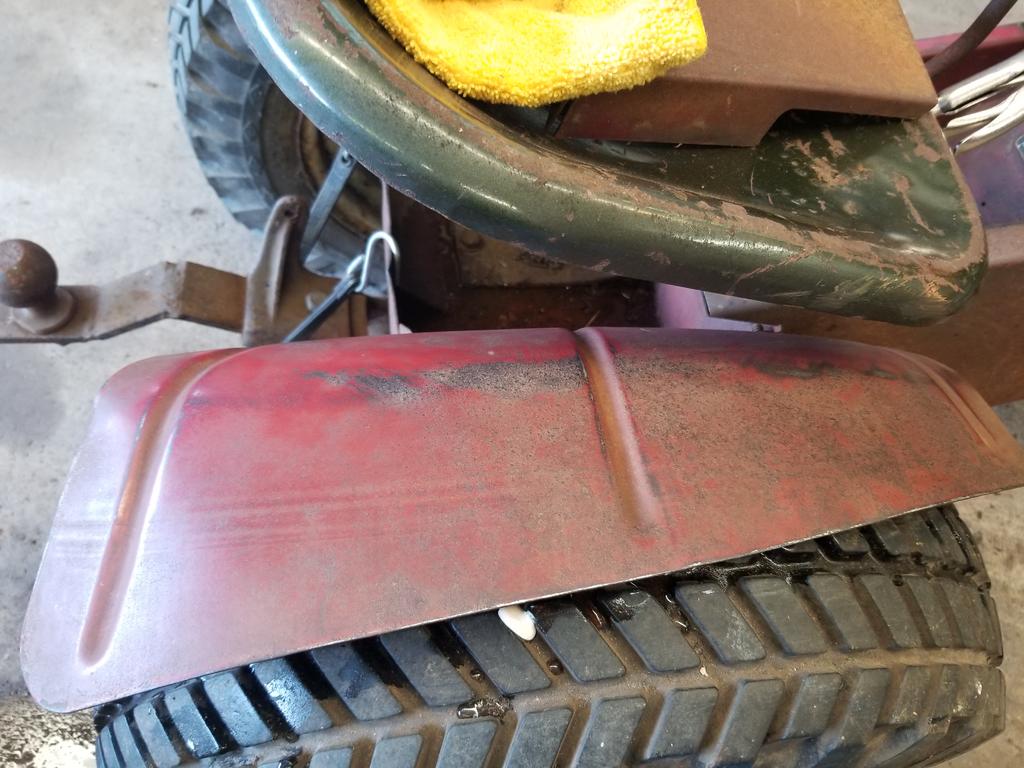

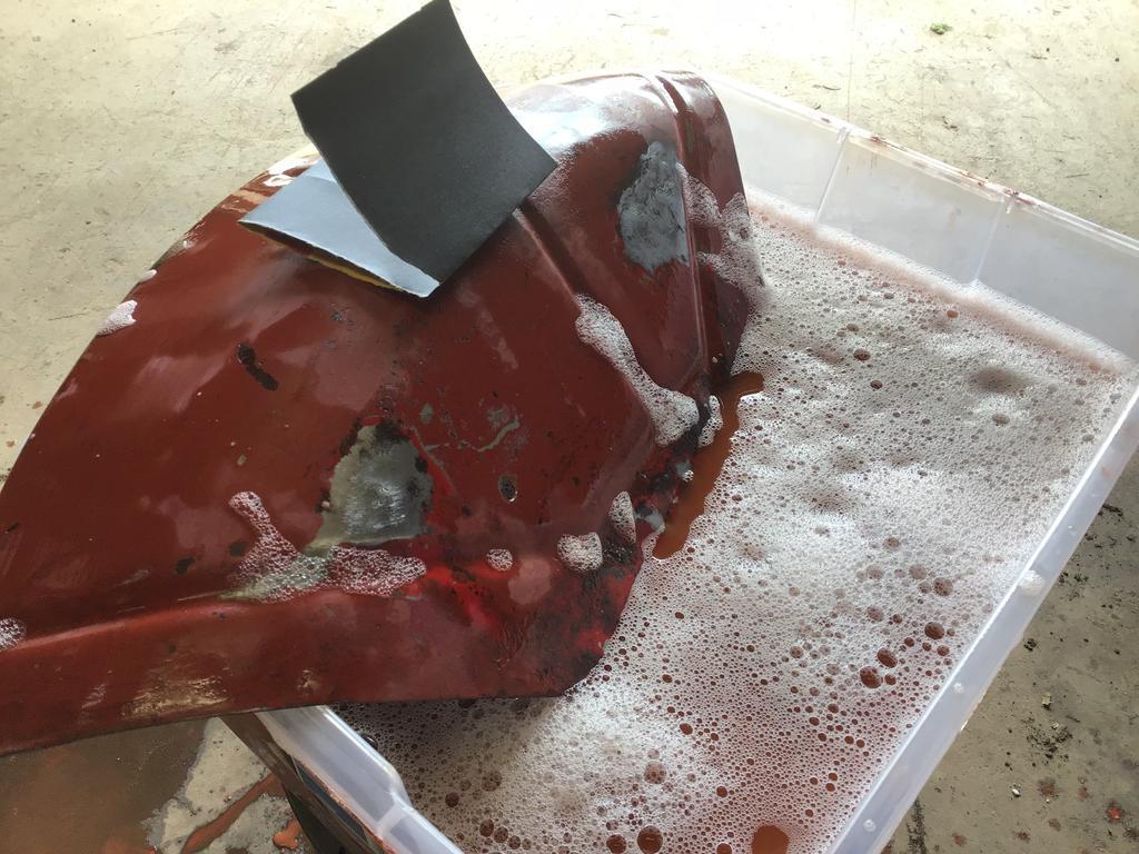

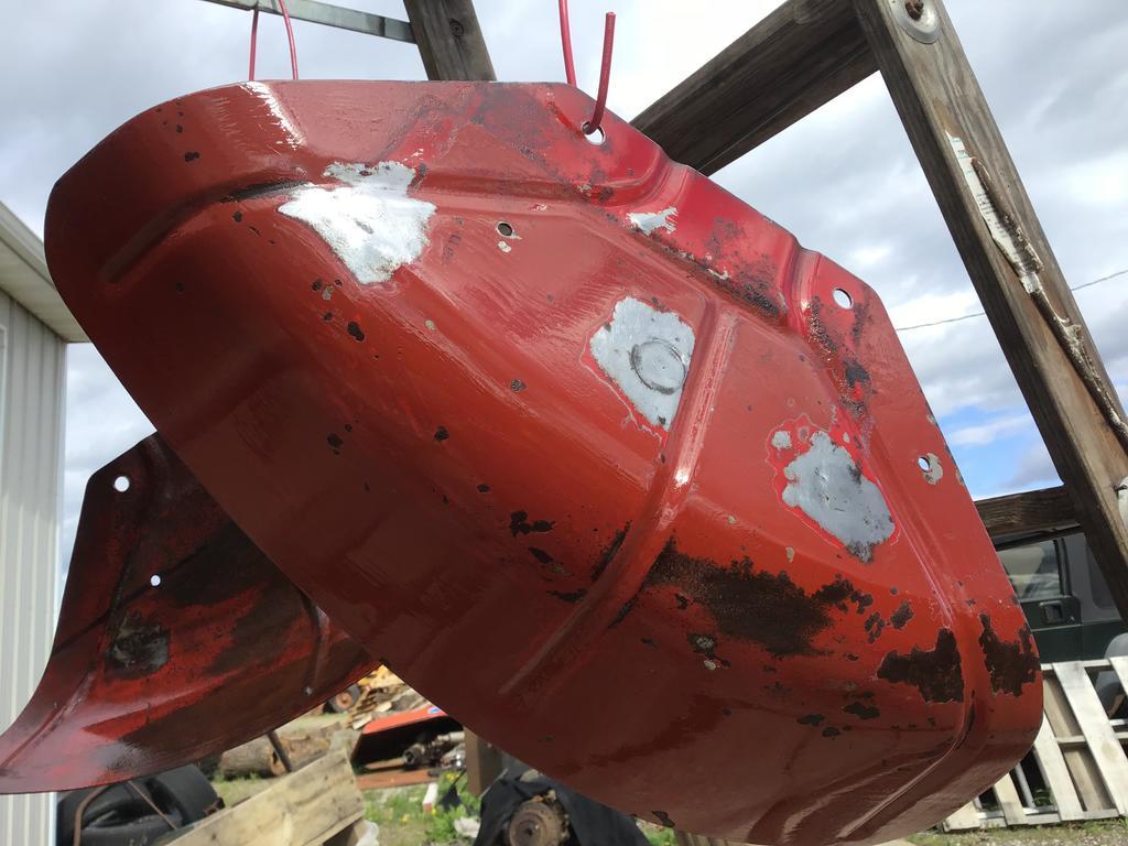

I just want to let you guys know that you all are very bad influences and I'm positive that you're doing it on purpose. My original plan was to tear it down and do a resto on it. After being told and reading around on here, i noticed Resto's ain't all that popular around these parts. So on a whim to see if all these random people on the internet knew what they were talking about, I wet sanded a rear fender with some 400 grit that I had laying around. Now I have a fender with character to cool to cover with new paint which means now I have to do the rest to make it match. My arm is aching! And it's all of y'alls fault! Sorry about the mess in the pic, like I said it was on a whim.
  • Excellent 4
  • Heart 1
Yes.
WHX??
I like it ... It's always a tough decision to resto or stay orginal. The fellas here have got me  brainwashed to orginal and sometimes I think the only reason I agree is even with the elbow grease it's much less work than a totall resto! End result is it's your tractor you make it your own. Another general consensus amongst us is if the original paint has been attacked, say with a terrible paint brush job, it is open for a full blown resto.
Hope this helps to confuse you more! :lol:
BTW thank you for crediting us as being bad influences.... anything to help a fledgling addict out!
  • Haha 4

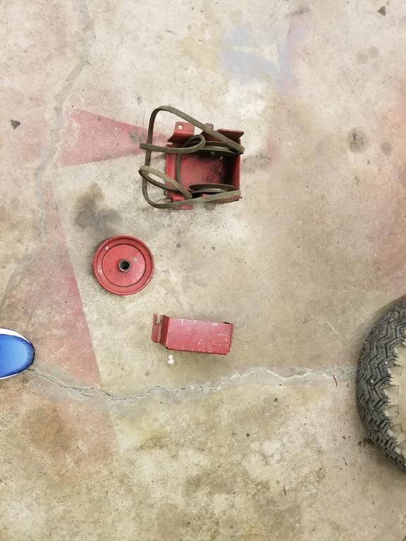

Ok, one last question on this thread (I hope). I'm putting the mower deck together and have some left over parts. I'm pretty sure they are not mower related so I was hoping you could tell me what they go to or where I can go to look it up and figure it out myself.
Those look like extras to me, they don’t belong on a round hood mower deck.  The wet sanding looks good!
Even crappy shop broom paint jobs look good with some wet sanding.  You could even do a clear or satin clear if you want to preserve it, or some Johnson’s Paste Wax.
