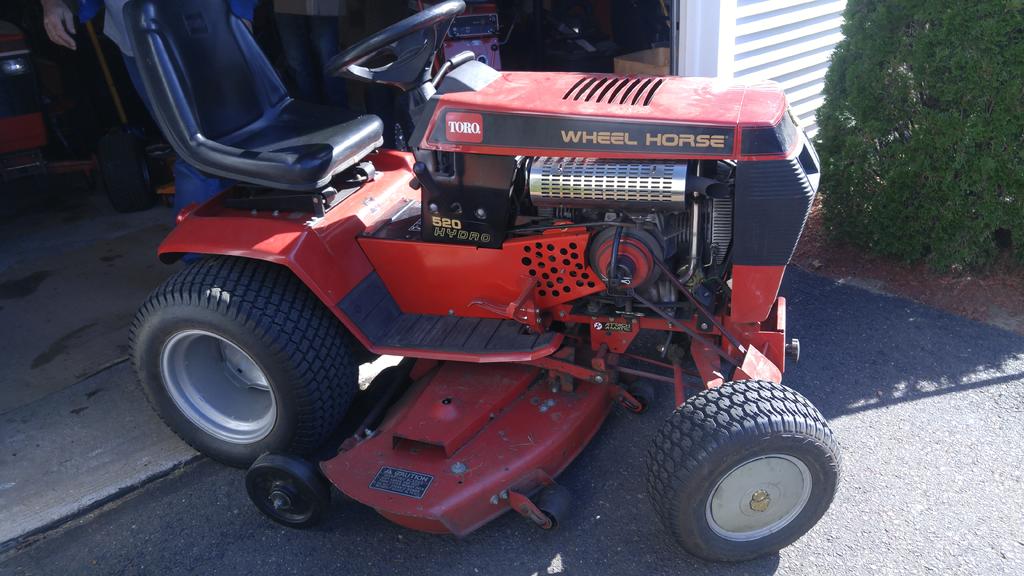

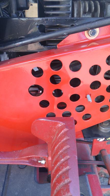

hi men, i ventilated the belt guard AND the support bracket to hopefully avoid the dreaded valve seat issue. i had the belt guard sandblasted and powder coated.  please note the 8 inch deck gauge wheels. i can cut
very high. thanks again to my buddy phil for the pics.  mike in mass.

Nice job!!  That looks so good.  :handgestures-thumbupright:

Nice work.  What did you use to punch the holes?

I USED A 2 INCH HOLE SAW ON MY 520-H. IT DROPPED THE TEMP. IN THERE OVER 20 DEG.

spinjim, first i used double ended, short, .125 drills for the pilot holes. then a step drill to enlarge the holes. finished off with a flap wheel on an angle grinder and hand file. mike in mass.
