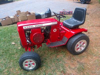

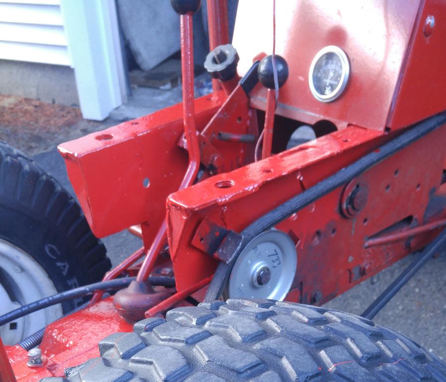

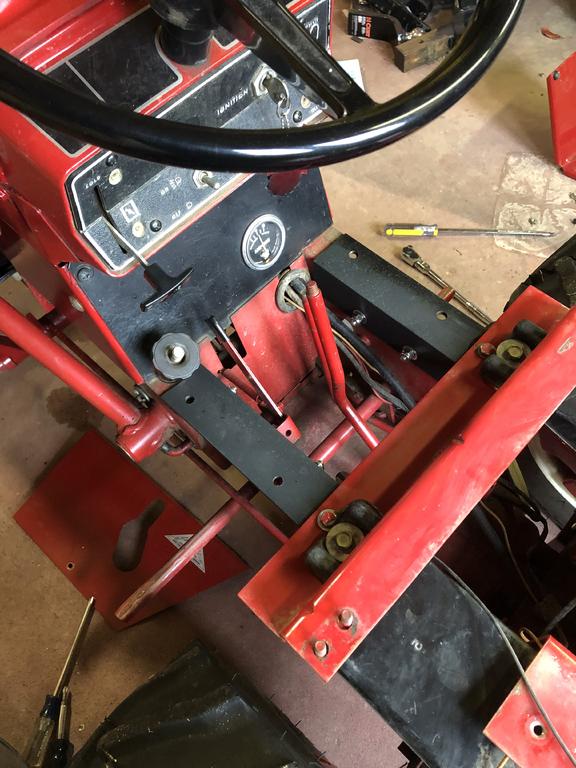

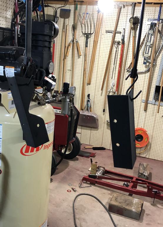

mrc 752 #1 Posted September 20, 2019 hi men, here is a few pics of my son-in-laws C161 i just fixed. i don't know how many of these cracked/ broken seat support areas i have fixed. certainly a weak link and a bad design of the late C series and 3,4 and 500 series. my hobart welder sure came in handy. thanks to my buddy phil for the pics. mike in mass. 10 3 1 Share this post Link to post Share on other sites
cschannuth 3,815 #2 Posted September 20, 2019 I’d love to see a picture of the entire tractor when it’s put back together. I still have my dad‘s 161 and it is my work horse. 1 Share this post Link to post Share on other sites
Pollack Pete 2,273 #3 Posted September 20, 2019 Nice repair job.Good idea to weld in the gussets.I usually only weld in flat stock on top.I'm sure the gussets make a stronger fix.Will remember that for next one I repair. 1 Share this post Link to post Share on other sites

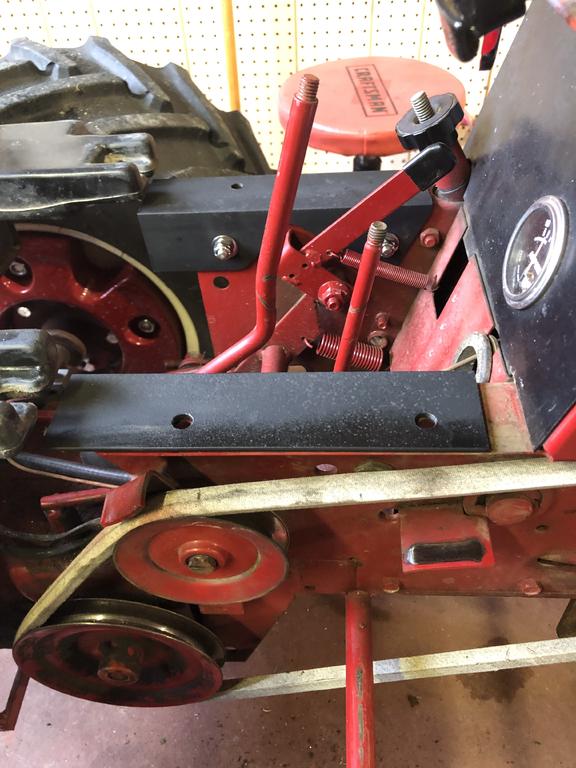

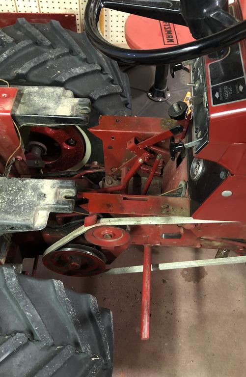

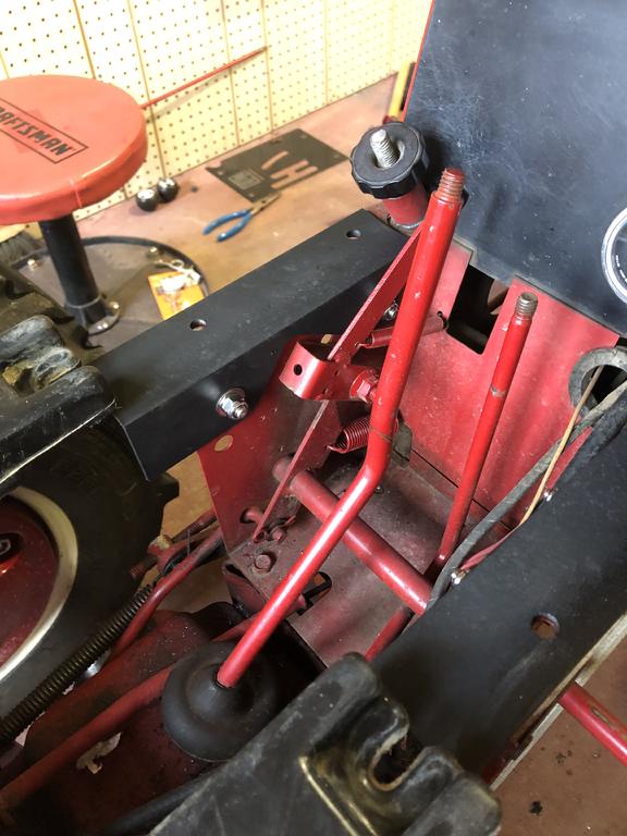

cschannuth 3,815 #4 Posted September 21, 2019 (edited) That looks really great. I’m not a very good welder on the light stuff so I ended up bolting in some angle and it really beefed up my seat on my 161. Edited September 21, 2019 by cschannuth 2 Share this post Link to post Share on other sites

mrc 752 #8 Posted October 1, 2019 hello cschannuth, what size angle did you use? 2x2x1/8"??? thanks mike in mass. Share this post Link to post Share on other sites

peter lena 8,408 #10 Posted October 1, 2019 that angle steel redo , makes the most sense, pete Share this post Link to post Share on other sites
cschannuth 3,815 #11 Posted October 1, 2019 1 hour ago, mrc said: hello cschannuth, what size angle did you use? 2x2x1/8"??? thanks mike in mass. Yessir Share this post Link to post Share on other sites

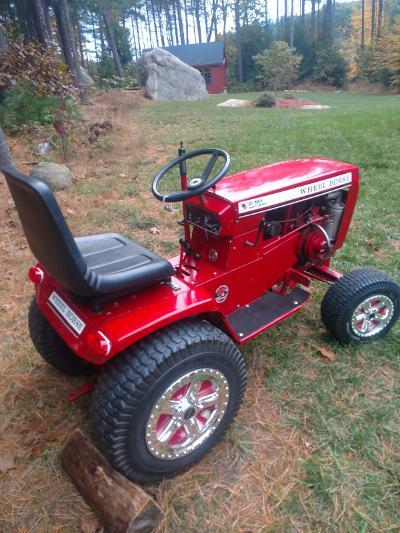

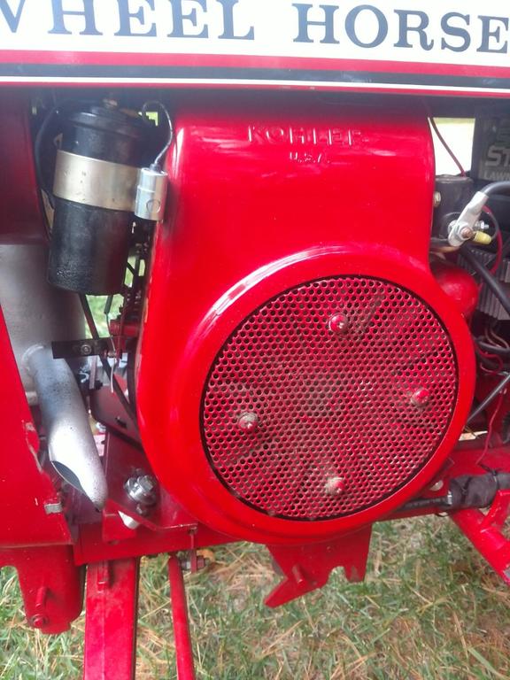

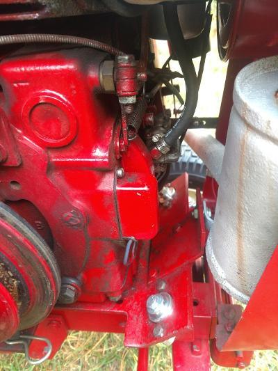

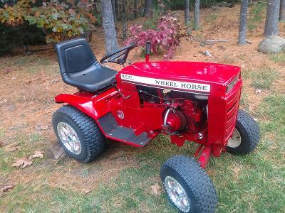

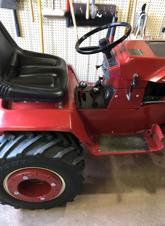

mrc 752 #15 Posted October 21, 2019 cscannuth, here are a few pics of the tractor all back together. also included are a couple pics of the zach kerber solid motor mounts installed. regards mike in mass. 2 1 1 Share this post Link to post Share on other sites

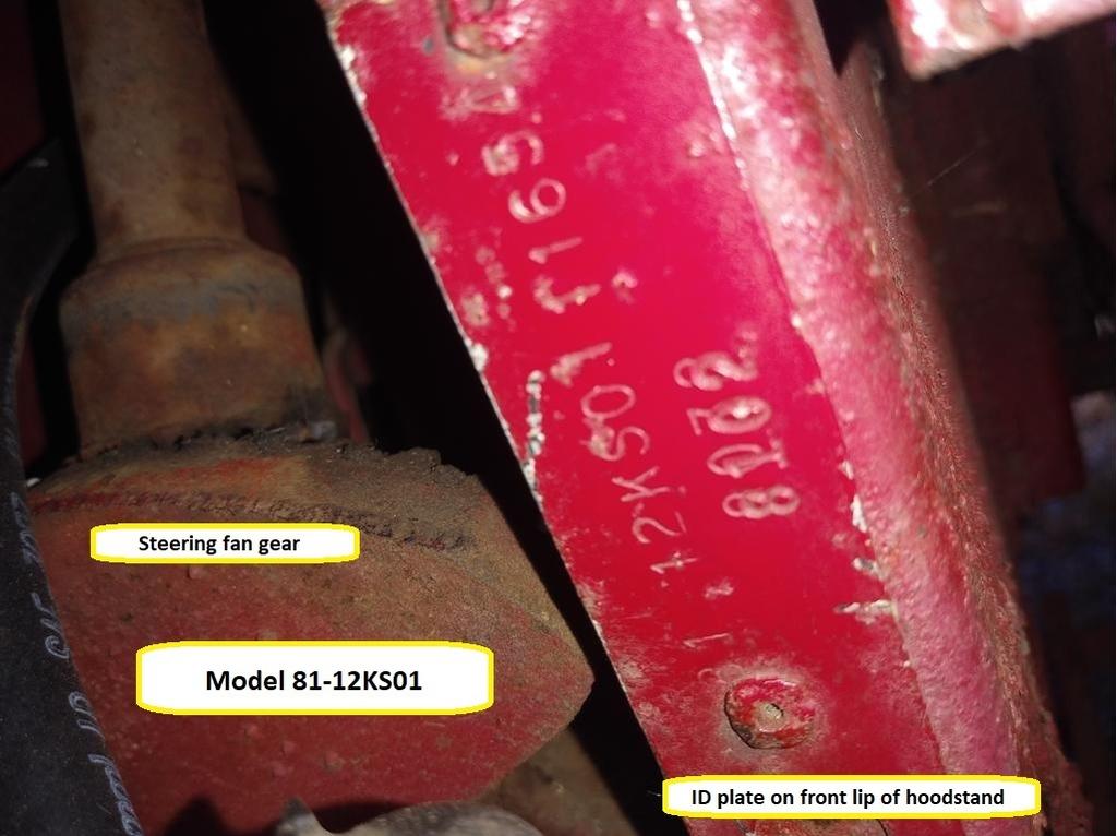

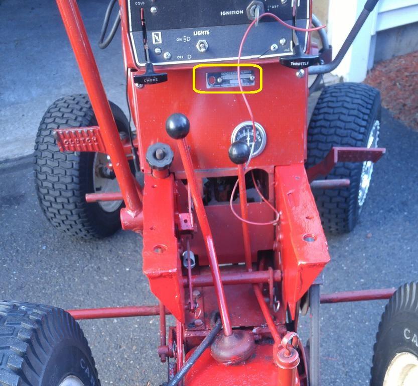

gwest_ca-(File Mod) 10,876 #16 Posted October 21, 2019 mrc - Is your tractor a 1978 or 1979 model? Have been watching for the locations of the tractor ID plates these two years. Garry Share this post Link to post Share on other sites
mrc 752 #17 Posted October 21, 2019 garry, the tractor is now back at my son-in-laws house which is 45 minutes from me. i do not know the year exactly. how do i tell what year? regards mike in mass. Share this post Link to post Share on other sites
gwest_ca-(File Mod) 10,876 #18 Posted October 22, 2019 The model number on the ID plate will start with 81 or 91 for 1978 and 1979. These are usually printed with the remainder stamped into the plate. Serial number will follow on the top line. The bottom line will have a 4-digit Julian build date. Many 1978 models have the ID plate facing the opposite direction down beside the steering fan gear on the front of the left side hoodstand. Trying to determine when the ID plate location changed. Garry Share this post Link to post Share on other sites
