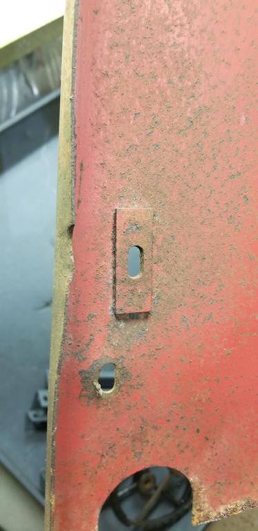

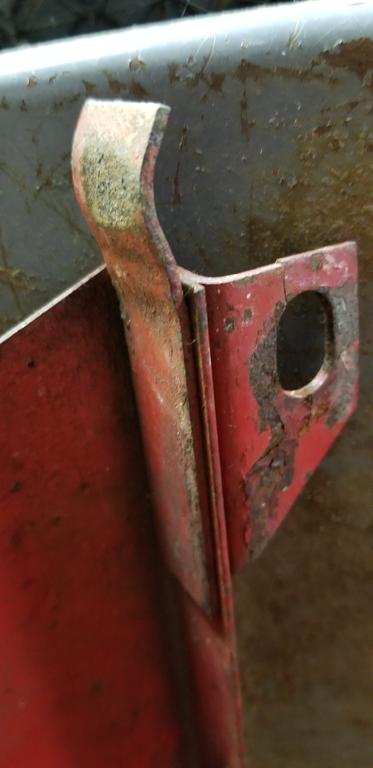

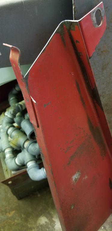

20190913_095354.jpg.1736921d0d1c8b8c010fb9fb364faa05.jpg20190913_095426.jpg.52fa3c35b65e95aed6570f8416a563e0.jpg
Top two picts showing you the factor version of the finger...
...and the simple "crimp" that will provide a similar belt resistance.
