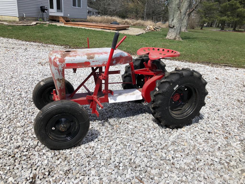

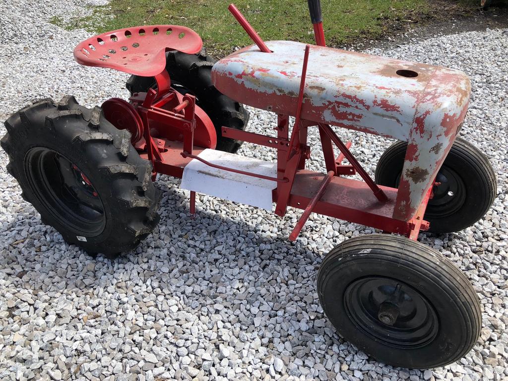

rreischman 2 #1 Posted September 9, 2019 Hi all, this is my first post to the forum, so please forgive me if this has already been discussed. I have an old rj-25 and it originally had a 2.5 tecumseh motor on it, which never ran because it was locked up. I want to put in a newer more reliable engine on it so my nephews can enjoy it and get some use out of it. Not sure if i need a clockwise or counter - clockwise engine or do you have any recommendations for what I should do? Thanks Share this post Link to post Share on other sites

WHNJ701 4,165 #3 Posted September 9, 2019 being it's a very early rj, personally I would keep it original. adding a predator/new replacement type engine will kill the value of it. I would either rebuild or find a period correct replacement. I would look for an early 60's wheelhorse for the kids to ride around on instead at least they are common enough if want to repower with a newer engine. Share this post Link to post Share on other sites
CasualObserver 3,410 #4 Posted September 9, 2019 Umm... if you truly have an actual RJ-25, I'd recommend you sell it and buy your nephews each their own tractor with the money. Some pictures will tell a much better story here if you can add some. Share this post Link to post Share on other sites

Pullstart 63,941 #6 Posted September 9, 2019 @rreischman! That is a great looking tractor! I’d keep my eye out for a Clinton or Kohler powered something from that vintage, to put around with. Anything you can do to not cut or hack the tractor would be best... but good on you for getting this going for the grandkids of the original owner I feel like I have a connection to my grandfather each time I use something that was his. 1 Share this post Link to post Share on other sites
WHNJ701 4,165 #7 Posted September 9, 2019 Maybe restore that one to original condition with the grandkids being it's family history and an uncommon tractor. Share this post Link to post Share on other sites
AMC RULES 37,144 #8 Posted September 9, 2019 RJ-35 1 Share this post Link to post Share on other sites
953 nut 57,091 #9 Posted September 10, 2019 8 hours ago, rreischman said: I have an old rj-25 and it originally had a 2.5 tecumseh motor on it The RJ-25 is a 1956 model and came with a Briggs & Stratton engine. What is pictured could be a 25 or a 35. Do you have a picture of the engine you could post. If it is the correct factory engine I would put it away for a later date. Just repowere the RJ with one of the Harbor Freight engines so the kids can enjoy grandpa's tractor. Later on you can rebuild the engine and do a proper restoration, right now tractor bonding time is at hand! 7 hours ago, rreischman said: I'll never sell it in my life time or will ever be worried about resell just want them to enjoy it. It was their grandpa's 1 Share this post Link to post Share on other sites

AMC RULES 37,144 #11 Posted September 10, 2019 The proof then... it's not an RJ-25. Share this post Link to post Share on other sites
