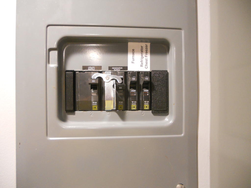

Let me elaborate on that hopefully to avoid confusion. Here's what I call my transfer panel:
I have 5 panels on this property. One in each garage, the main 200 amp, a panel in the addition with a 60 amp feed from the main and the transfer panel. A 60 amp feed from the main panel is connected to the breaker on the left marked 'utility supply'. A dedicated line is run from the breaker marked 'generator supply' to the garage where it can connect to the generator. The feeder to the 60 amp panel in the addition is connected to the main lugs in this transfer panel. Everything we need powered in an outage is run to the addition panel. The furnace, refrigerator and chest freezer and run to this transfer panel only because it was easier. The transfer panel and addition panel are powered through one of the 60 amp breakers you see. The interlock is a Square D QO2DTI and that's was prevents normal power and generator power from meeting. The main 200 amp panel is still connected to the power company in an outage but isolated from the transfer panel and, of course' the addition panel. When power is restored anything on the main panel will come on if the switch is on. At that point just flip flop the two breakers with the interlock and everything is back to normal. :)
