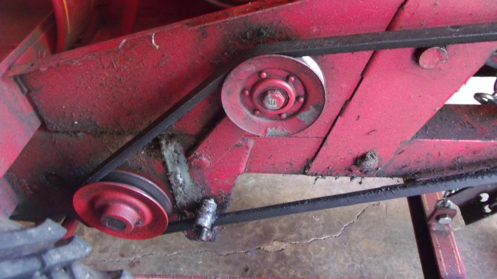

15 minutes ago, stevasaurus said:
Well. a picture is worth a thousand words.  The #5085 is a 4 speed transmission and it would have appeared in the 1973 8 hsp, 4 speed (1-0120) with a Kohler.  What you have has been replaced at some time.  You have what is called a 3 speed.  The brake drum is on the 11/44 toothed gear shaft.  Somebody had to jury-mander the brake linkage to make that work. There is nothing wrong with that transmission.  Pretty much the difference between a 3 and a 4 speed is where the brake drum is mounted...mushroom gear shaft or the cluster gear shaft.  As far as what the # of your trans is...it is either a #5025, #5046, #5049, #5053..  If your shift rails are round...call it a #5025.  If your shift rails have a flat running the length of the shift rails...call it a #5053.  All of the internal parts of the 3 speeds are interchangeable, and all the seals, bearings and gasket are the same in all of the above transmissions.  :occasion-xmas:  Oh, and that pulley on the input shaft should be a 4" pulley...then it would line up.
With a 4" pulley on the input shaft and a 2 1/2" drive pulley on the Kohler 8, I would think it should use the same belt as a 1967...857.     1/2" x 70"  if the tractor frames are the same length.
Thanx steve that is what l needed! I didnt
think that like the correct pulley for the input shaft.  If I can get the motor running decent I'll keep the tractor if not I'm going to part it out . :text-thankyoublue:!!

Here is what that trans pulley looks like...bottom left.  A - Z tractors should have one fairly cheap.  You may still have to use string to measure belt length.
your pulley was probably on the 8 speed trans
 So does that 8 at the end of the model number mean the  horsepower or the trans?
stevasaurus
the trans is what the 8 stands for...your model number came with an 8 speed trans...no doubt about it.  The 4 speed had it's own model number for 1973.  This was not a case of Wheel Horse using what was on the shelf...and they would never have replaced it with a trans from the 1960's.  The brake drum on the mushroom gear shaft tells the whole story.  Most of those stories about Wheel Horse using things from the shelf are from the 50's and early 60's...and some of that happened in the horses that were built in Belgium.  But even in Belgium, it was not slap happy...the C-100 would be the Raider 10 (that is just an example). :occasion-xmas:
