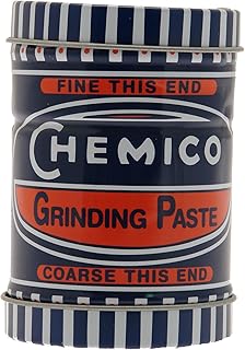

From a maintenance aspect you can just lap the valves to the seats using rough then fine lapping compound.  I'm not an Onan guy, but if you can remove the valves with the block in place, you can do this lapping. You would need these items.  There's probable some youtube videos on lapping valves on an Onan engine.
Performance Tool W86552 2-Piece Valve Lapper SetChemico- Valve Grinding Paste Fine & Corse
