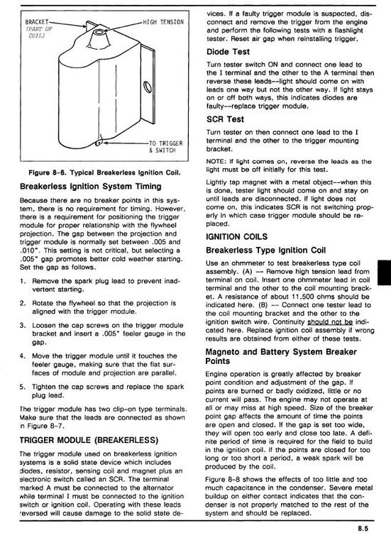

On 9/2/2019 at 6:56 PM, pfrederi said:
Did you download the service manual in post #6 above???  Go to page 75 and test the coil and the trigger.  Both are worth money if they pass the tests.
thanks for the reply and i have down loaded the file so now i can get a better understanding of this type
