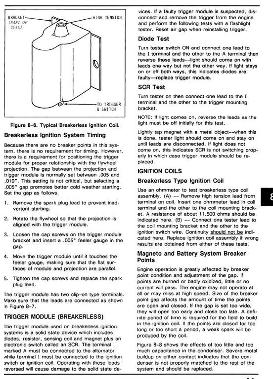

You have the Breakerless ignition system.  be very careful how you wire it any power applied can destroy it.  The bump isn't magnetized the trigger is.  look at the Kohler service manual for correct wiring and testing. Sorry no time right now to link it for you.

The white wire on the I terminal goes to the triangular shaped coil.  The second wire attached to the connector goes to the M terminal of your ignition switch.

Thanks, so the trigger is the SCR. I don't have a flashlight tester but I have a multimeter. It appears to be a continuity test and just making sure it switches when the magnet touches metal. I'll go try it.
tntatro
I'm not sure the test I did was right but the only way I could get continuity was by having the positive lead on the mounting post and negative on the A terminal and it read around 19 with the meter set at 20k. If I had the negative on the mounting terminal and positive on A there was no reading. That doesn't make sense to me but that is how it is. I could not get a reading from the I terminal with the leads either way or by tapping the magnet with metal. I think the trigger is bad but not sure.

You can use the 15 amp regulator with the 10 amp stator no problem.  Get a couple aa batteries and a flash light bulb and some wire ...you have the tester
