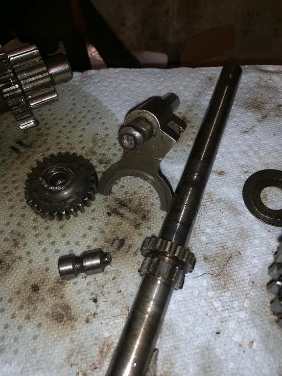

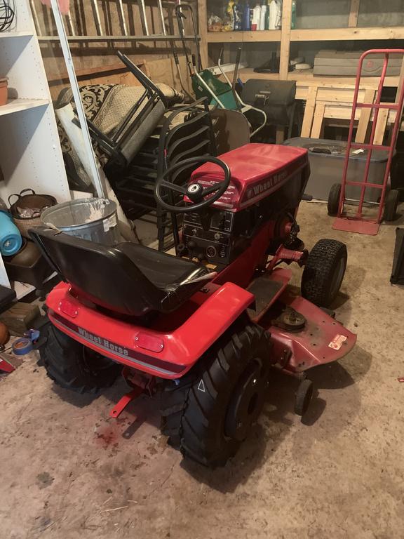

Dave3434 13 #1 Posted August 28, 2019 Hey All, I just inherited a 414-8 from my late father in law. It was his pride and joy, so I have been working on getting it restored. I probably put more into it than is worth, but it’s all good. New starter, tires, battery, fuel lines, and now working on rebuilding the transmission. Once that’s done.. should be good to go. 7 4 Share this post Link to post Share on other sites

Stormin 9,981 #11 Posted August 29, 2019 That looks well looked after. Wheel weights as well. Get it up and running and use it. Your late Father-in-Law will smile down on you. Share this post Link to post Share on other sites
Dave3434 13 #12 Posted August 30, 2019 Thanks everyone.. I am not exactly sure of how it all unfolded, but I had to order a new reduction gear, input shaft, and shift fork. It started off that it would not go into low gear and wouldnt stay in 3rd. After my first mow, the shifter was stuck and I was too. I would say the hardest part was getting the damn woodruff key off of the axle. Fingers crossed that we are as good as new once all completed. 2 1 Share this post Link to post Share on other sites
