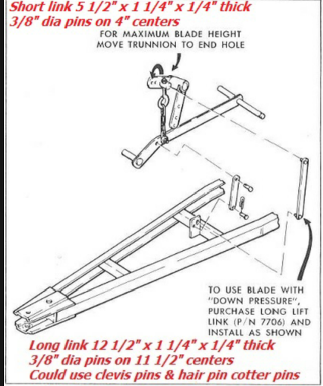

boondockboost 34 #1 Posted August 26, 2019 Hello, im looking to add the link for down pressure to my plow cause right now its liffted with a piece of chain and its not that great. Is the toro #7706 the piece i need for down pressure? Share this post Link to post Share on other sites
ebinmaine 79,359 #2 Posted August 26, 2019 If that's the one that is a little over 11" long, yes. 1 Share this post Link to post Share on other sites
gwest_ca-(File Mod) 12,304 #3 Posted August 26, 2019 Click on the picture and download from the next page if you want. Garry 2 Share this post Link to post Share on other sites
boondockboost 34 #4 Posted August 26, 2019 And thats suppost to replace where the previous owner put the chain at? Share this post Link to post Share on other sites
ebinmaine 79,359 #5 Posted August 26, 2019 10 minutes ago, boondockboost said: And thats suppost to replace where the previous owner put the chain at? The horizontal bar that your current one is attached to would be tied up out of the way. The long solid bar would go directly from your plow frame up to the lift handle lever. The chain and short bar is actually the far more common and normal way to hook up the plow. I use down pressure in pretty near every snowstorm and I would not want a chain hook up. Down pressure is very very handy sometimes when scraping denser snow. Share this post Link to post Share on other sites
The Tuul Crib 7,354 #6 Posted August 26, 2019 So where does the long link fit in? Does it go directly from the blade connection to the lift arm? Share this post Link to post Share on other sites
ebinmaine 79,359 #7 Posted August 26, 2019 1 minute ago, The Tool Crib said: Does it go directly from the blade connection to the lift arm? Exactly. Share this post Link to post Share on other sites
The Tuul Crib 7,354 #8 Posted August 26, 2019 (edited) Eric you just answered my question as l did not type quick enough! I had some issues the other day when I was pushing some dirt that's trying to get more down pressure on the blade. I guess I can make a bracket at work Edited August 26, 2019 by The Tool Crib Share this post Link to post Share on other sites
ebinmaine 79,359 #9 Posted August 26, 2019 3 hours ago, boondockboost said: link for down pressure I'm sure you're well aware of these are available online for anywhere between 25 and $50. If you have a piece of flat stock laying around you can make one up pretty easily with a couple of clevis pins or even bolts with locking nuts. Share this post Link to post Share on other sites
ebinmaine 79,359 #10 Posted August 26, 2019 1 minute ago, The Tool Crib said: Eric you just answered my question as l did not type quick enough! I had some issues the other day when I was pushing some dirt that's trying to get more dental pressure on the blade. I guess I can make a bracket at work I can take some measurements for you guys if you want but I think somebody else online has them already. If I remember right that link is something like 11 1/4 inches long and the space between the bolts or pins is maybe 10.5 in? Share this post Link to post Share on other sites
The Tuul Crib 7,354 #11 Posted August 26, 2019 1 minute ago, ebinmaine said: I'm sure you're well aware of these are available online for anywhere between 25 and $50. If you have a piece of flat stock laying around you can make one up pretty easily with a couple of clevis pins or even bolts with locking nuts. Yes we have plenty of quarter inch stock at work that I can make one of these brackets easily. 1 Share this post Link to post Share on other sites
The Tuul Crib 7,354 #12 Posted August 26, 2019 The diagram that Gary has on the above measures 12 1/2 inches long overall . 1 Share this post Link to post Share on other sites
ebinmaine 79,359 #13 Posted August 26, 2019 2 minutes ago, The Tool Crib said: The diagram that Gary has on the above measures 12 1/2 inches long overall . Seems as though that should be fine. I don't think mine is quite that long but it shouldn't make any difference. I have no notion whatsoever if mine is homemade or a Wheelhorse part. Share this post Link to post Share on other sites
953 nut 66,989 #14 Posted August 26, 2019 This drawing should help you. The lift link can attach to either of the front two holes, chain stays where it is. 1 Share this post Link to post Share on other sites

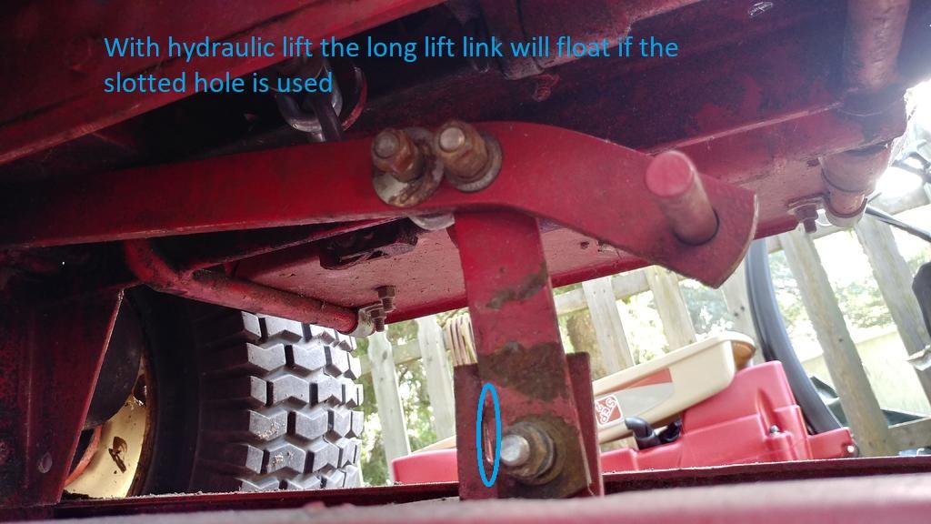

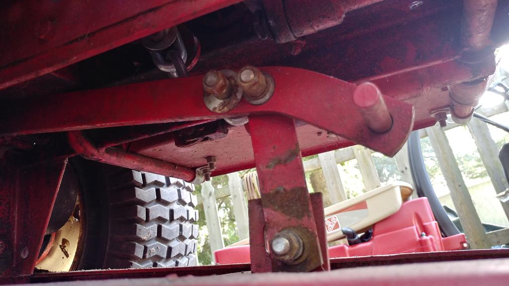

gwest_ca-(File Mod) 12,304 #16 Posted August 26, 2019 I drilled 3/8" holes in the bar and used 3/8" x 2-1/2" Gr.5 bolts. Cut the threads off. Weld the head of one bolt to the bar and try it for alignment. I ended up installing the 2nd bolt from the other direction and welding the head only. This provided 1/4" of offset and the pins are square to their attaching parts to minimise wear. Drill holes in the bolts perpendicular to the bar for spring pins. Use a countersink to ease the edges of the holes. With the holes drilled like they are you now know where they are and you can instal the pins blindfolded. With manual lift the float is built in - everything floats including the lift handle. With hydraulic lift the float is accomplished by connecting the bottom of the link to the slotted hole. Down pressure is still available when the pin hits the bottom of the slot. Garry 1 Share this post Link to post Share on other sites
boondockboost 34 #17 Posted August 26, 2019 Well this post turned into a good read. This is excatly everything I wanted to know. So with my tractor (hydro lift) i tie the horizontal bar outta the way and go from the lift to plow frame. Also taking out the mini link thats there? Thanks for the help I may just make it like you guys said 1 1 1 Share this post Link to post Share on other sites
