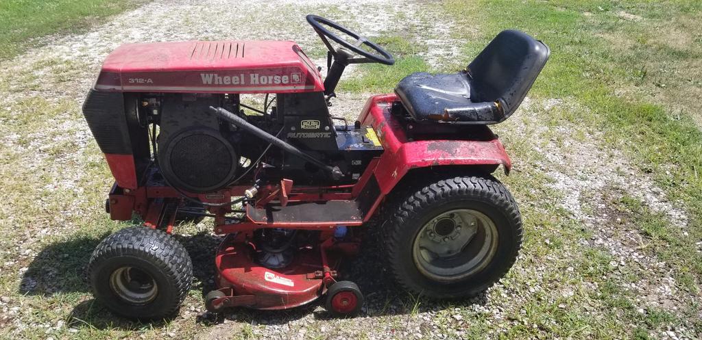

Bean701 35 #1 Posted August 24, 2019 It’s been about 8 years but I’m back in the fold with a “new” tractor. My first WH was a GT1800 hydro I put way too much money into only to have the 18 horse Briggs die. That was taken out to the grandads farm and then inadvertently junked by a careless in-law. This tractor is a 312-A. I paid $0 for it, a blessing from a co-worker who knew my interest and had no use for it. I hope to salvage the transaxle and pump from the GT to hopefully swap in when this Eaton 700 craps out. 5 Share this post Link to post Share on other sites

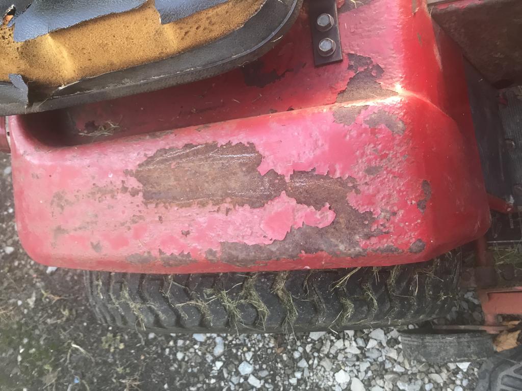

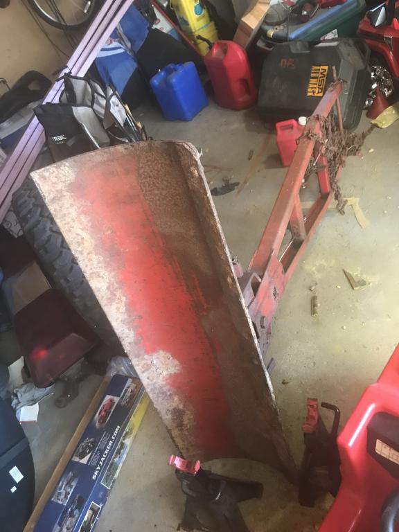

Bean701 35 #8 Posted August 24, 2019 Dealing with failing paint and pitted rust. Here’s to hoping some of the sheet metal on the GT is salvageable as well. Forgot to mention I got a dozer blade in the deal. I am missing the handle which turns the blade. Any suggestions? I know there were many variations. 2 Share this post Link to post Share on other sites

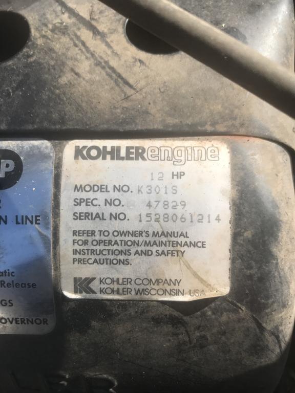

Bean701 35 #11 Posted August 27, 2019 Anyone able to tell me a year from this engine tag? My build tag is gone off the tractor. Share this post Link to post Share on other sites

Bean701 35 #13 Posted August 31, 2019 In the pic above of the dozer blade on its side can anyone advise what is missing to make the blade work? There were no handles or angle adjustment levers... turns out the hour meter meter works on this. Right at 1100 or so hours. Governor issue needs addressed. Running wide open all the time. Still trying to locate correct pn for air filter. Everything I get is too tall. Share this post Link to post Share on other sites
gwest_ca-(File Mod) 11,187 #14 Posted September 25, 2019 The 47829 spec number was only used on the 1986 312-A's models 21-12KE01 and 21-12KE02. The difference between the two may be the bearings used inside the transaxle. Kohler made serial 1528061214 in 1985. A 1986 dozer blade. Click on the picture. Garry Share this post Link to post Share on other sites
