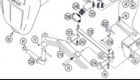

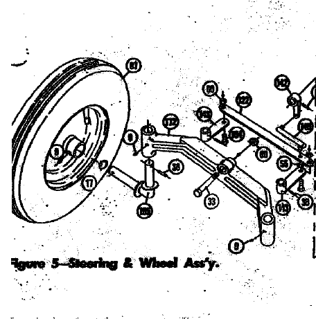

rmaynard
8 hours ago, Achto said:
One difference that I noticed is that the 701 used a flat tie rod to connect the two spindles together and a single round tie rod with ball joints to connect to the steering arm. Much like the mid engine Suburbans of '60 & '61.
The 702 uses a tie rod with ball joints on each side to connect the steering arm to the spindles. Like all of the later model :wh: tractors.
Actually, the parts diagram shows that the steering is the same on both. Below is a bad copy of an image from the 702 parts manual.
702 image
701 image

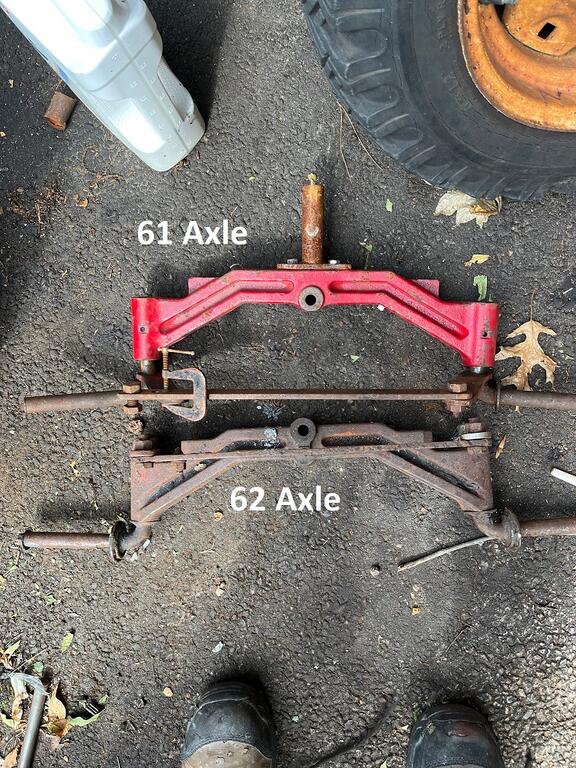

wallfish
Never had any 63s so can't help there.
But I do know the 702 axle isn't just a flipped 61 axle. They appear the same but the pivot hole is moved to have a thicker amount of cast to support that flip. They are just a little bit different. That was just recently discovered by accident when the two were sitting next to each other. I can get you a pic if you want it

wallfish
Guessing the 603 probably has the 62 702 type axle then
Notice the pivot hole location difference to support the down force. The spindles on the 61axle are on upside down
(never mind the piece attached to the 61, turning into handlebars)
  • Like 1
  • Excellent 1
slim67
I see what you’re talking about. Probably a minor change in the casting process? Interesting how the Ponds did things. Thanks for posting picture.
