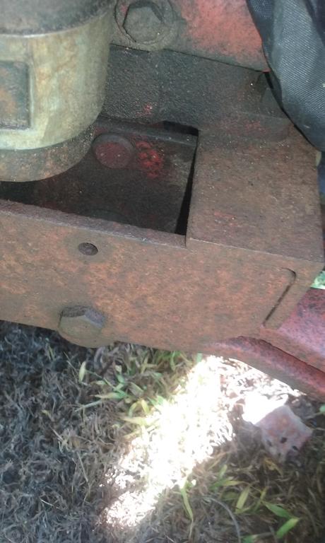

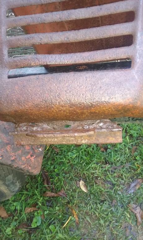

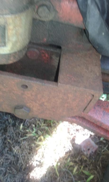

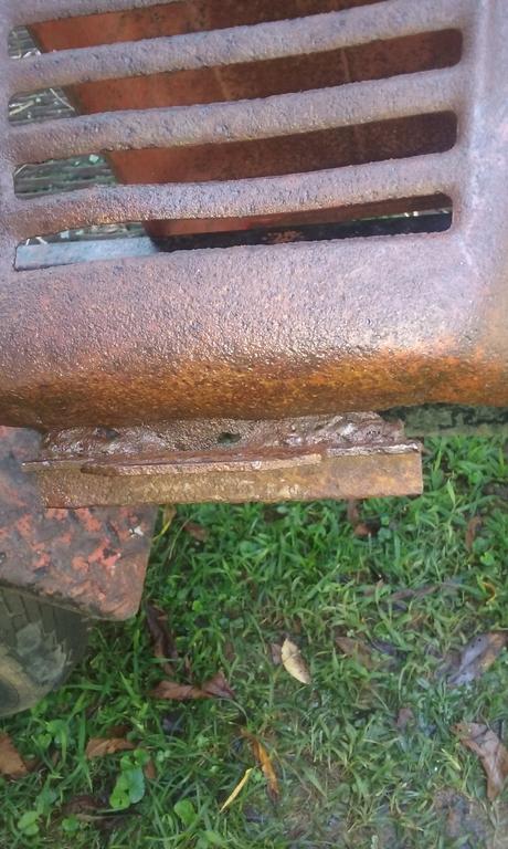

Should you have a hinge here or not. Looks like someone just welded it?
Racinbob
There's no hinge. The hood should have a tab that slips down between the frame and is held by a 1/4"-20 bolt that goes through the hole just above the axle bolt. :)
RickyMayhew
Thank you! Leaf looks like a small animal.
Achto
@RickyMayhew This is a poor picture, but the mounting tab can be see on this hood.
