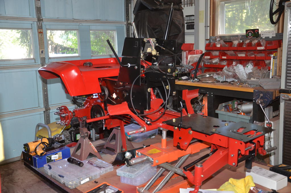

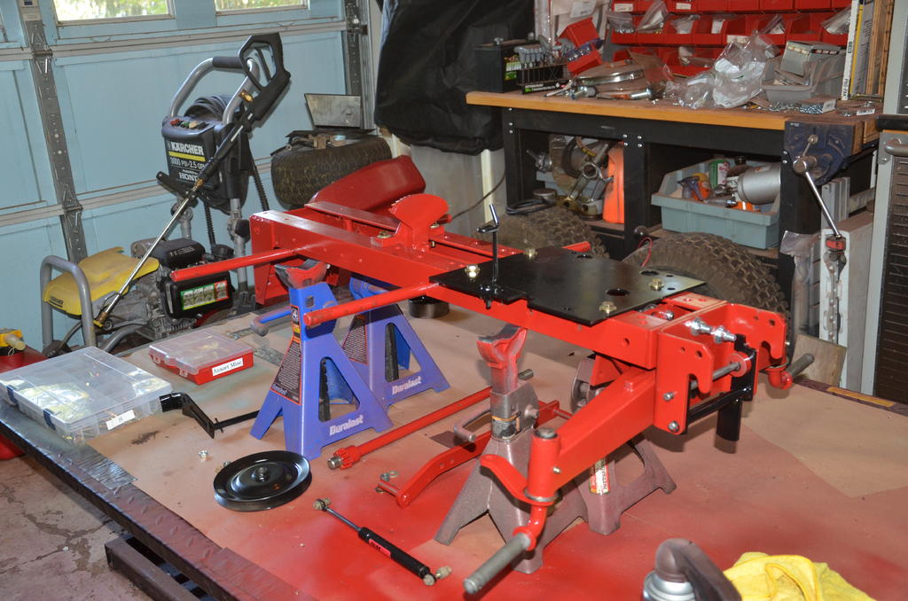

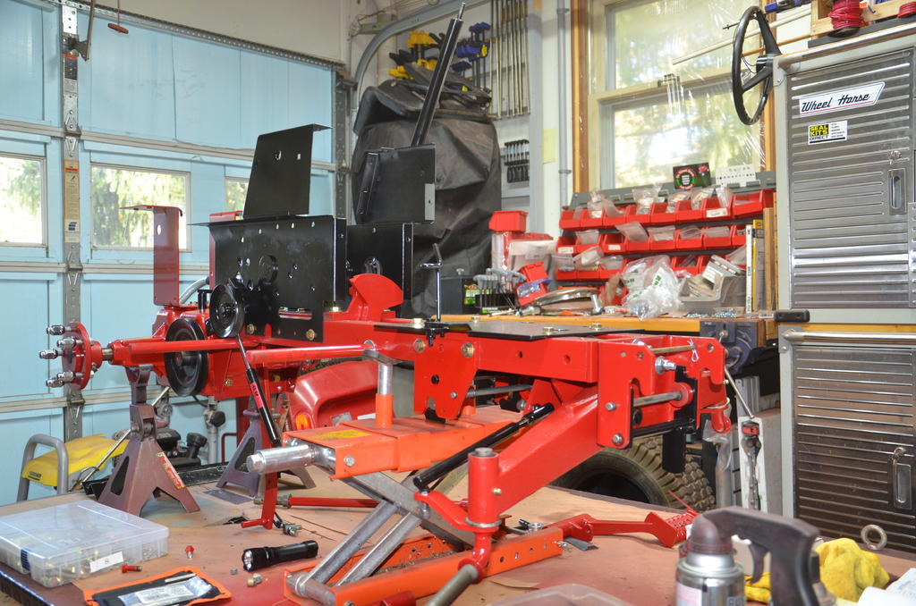

I have managed to make some progress.  I have blasted, primed and painted the frame and a lot of the parts that get bolted to it.
I gave in and painted the frame red this time

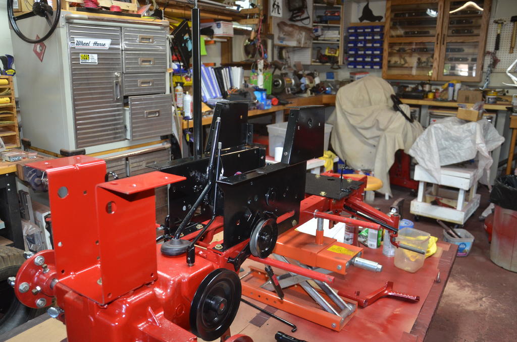

Finished up the transmission and got it connected to the frame.:D
While I was waiting on transmission part gave the blast cabinet a real workout with a lot of small stuff.
Then got ambitious and took the tower apart.
Parts book shows the collar with the lift arms removable from the shaft.:huh:
Soaked that sucker for two weeks with penetrate.  Didn't even phase it.:laughing-rolling:
So....the tower frame complete with lift arm went into the blast cabinet.  Boy was that FUN!!!:blink:
The basic frame is done and the rest of the parts are getting their final coats (don't have enough "clothesline")

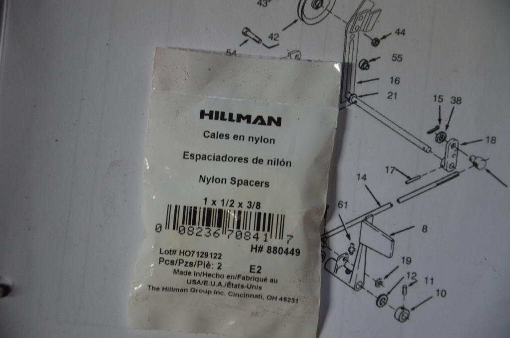

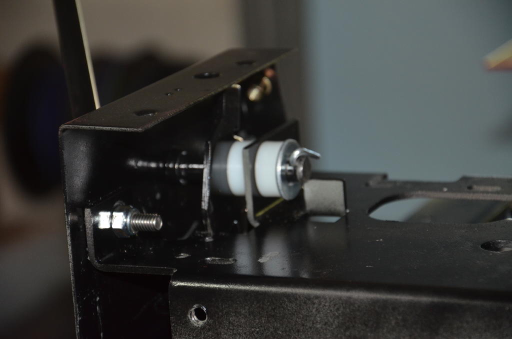

Peter Lena made a comment about a couple of mods to improve the horse.
1. Was the addition of an additional bearing for the steering shaft.  (part is on order)
and
2 Was a way to tighten up the PTO lever with additional washers and nylon washers.
WELL....
I was in the hardware section this afternoon looking for some nylon washers and I came across Nylon Spacers.
I thought this might work even better so I tried it.
And It Worked
Take a look

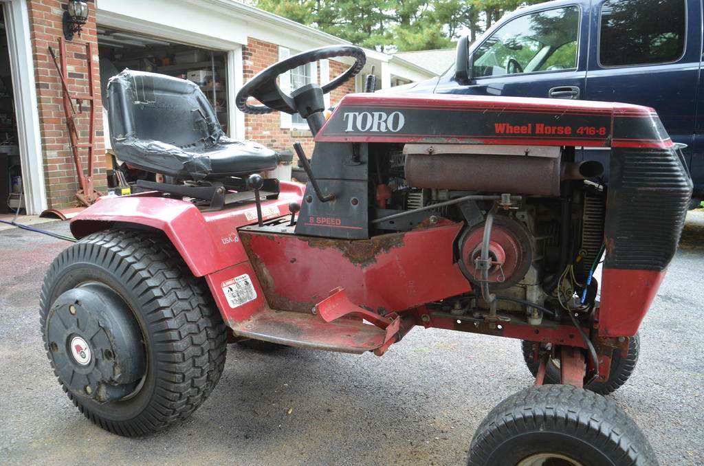

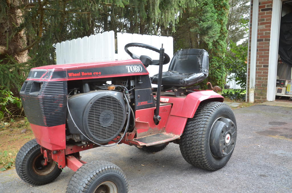

I am beginning to think that the wife is getting wise to my line of "Look what followed me home":unsure:
The guy down the street is in the process of moving and asked me if I would be interested in a Wheel Horse tractor (ya think):P
Its a 93 416-8.  No deck.  He just used it to tow his trailers around
This may have partly solved my wiring issues along with any spare parts.:)
Probably worth the $200

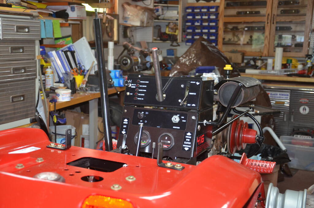

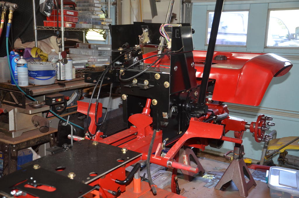

RJ Hamner

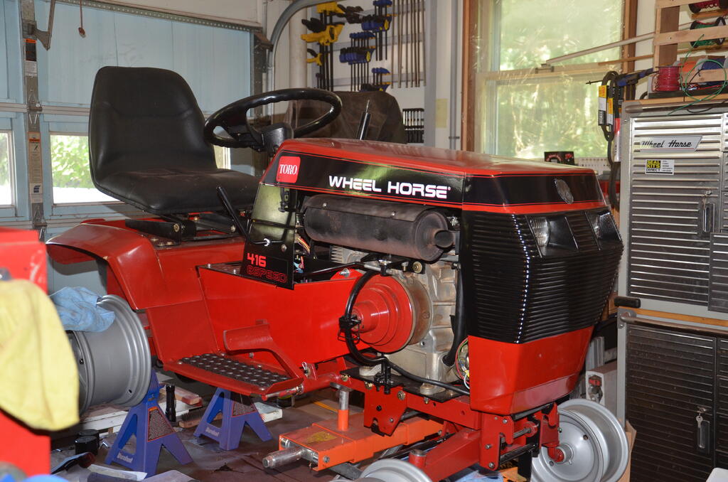

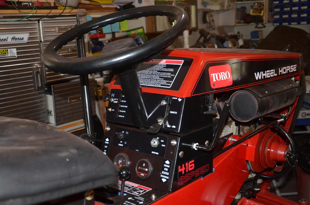

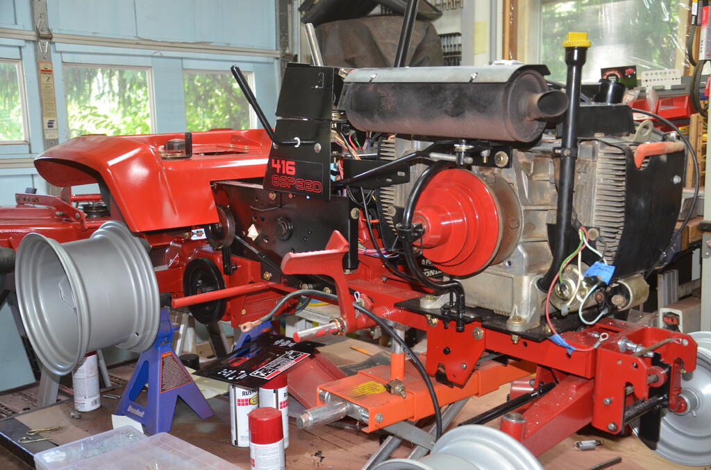

After the 416-8 project has been 9 months on hold the shoulder is finally getting to the point where I can get back to working on the tractors.:happy-bouncymulticolor:
Installed the repaired wiring harness.  Thankfully I labeled all the wires or I would have been up the creek.:blink:
Installed all the new decals on the panels and installed all the switches and gauges.

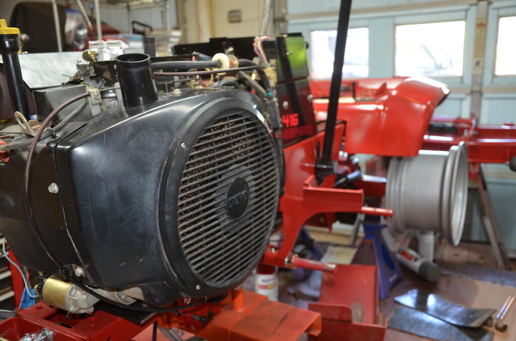

Got the wife to help installing the engine. Installed the cables and the PTO (minor PITA):ranting:
Guess the next thing is the running boards and then the hood.
