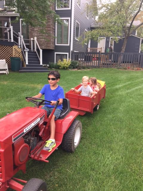

Got the Commando 800 restored and running, was my grandfathers that we rode around on as kids, now my grandkids will enjoy riding it! Thanks for the help on the belt everyone, that was the trick!
oliver2-44
it didn’t happen without pictures
Thrashing Trout
Oliver2-44,
here you go
