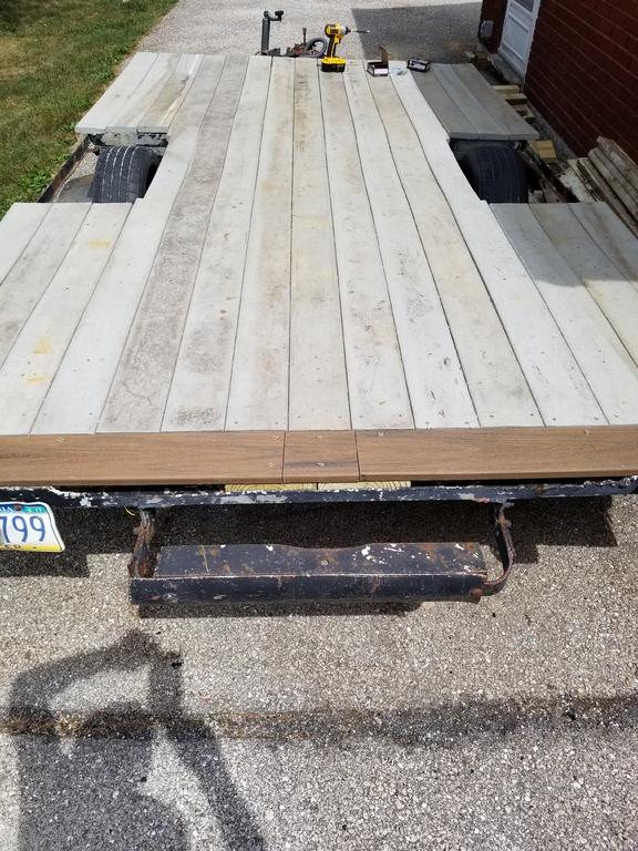

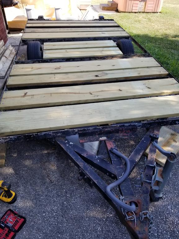

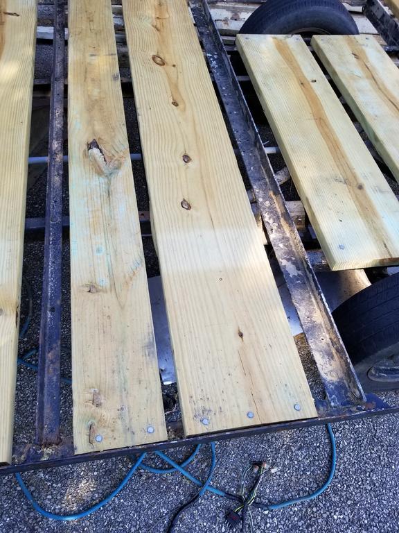

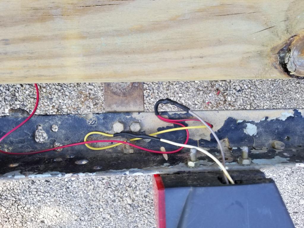

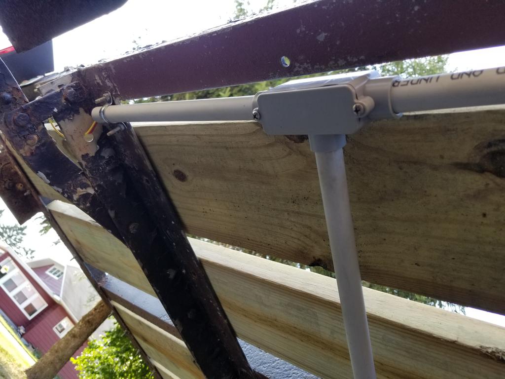

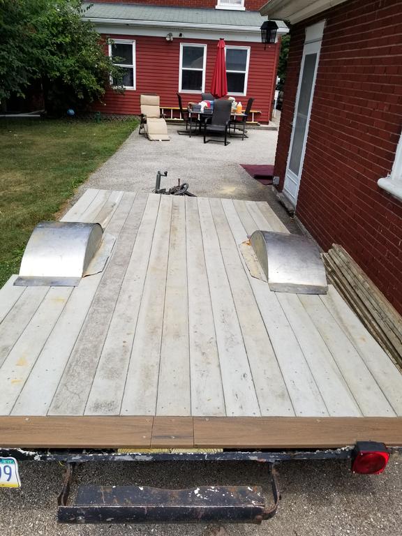

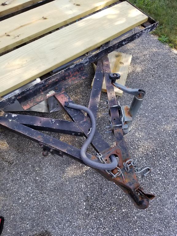

cafoose 3,360 #1 Posted August 12, 2019 The wood was rotting on my trailer and the wiring was messed up on my trailer so I redid the deck with treated some 2 by 8, 10, and 12 wood. I used plastic decking I got from a friend who got it at an auction for $1 I used galvanized nuts and bolts and ran conduit to all the lights with flexible cord organizer to the plug. I also soldered all wire connections and used heat shrink tubing on them. 12 6 Share this post Link to post Share on other sites
WHX?? 49,941 #2 Posted August 12, 2019 11 hours ago, cafoose said: also soldered all wire connections and used heat shrink tubing on them. Best way to do it Cafoose. I would have been tempted to throw a little paint on the frame. Easy when the deck is off. 1 Share this post Link to post Share on other sites
cafoose 3,360 #3 Posted August 12, 2019 1 minute ago, WHX24 said: Best way to do it Cafoose. I would have been tempted to throw a little paint on the frame. Easy when the deck is off. I would have but I was in a hurry to get it done because I needed it for this weekend Share this post Link to post Share on other sites
