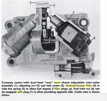

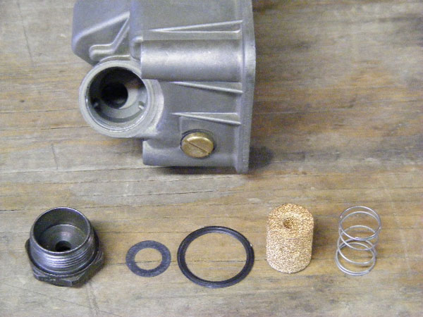

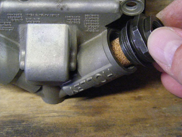

I've also seen plenty of sediment bowels in use with out the sintered bronze, both Carter and Holley carburetors used a sintered filter which is hidden inside the fuel inlet.
And I believe these bronze filter used by Carter and Holley were eventually replaced with paper elements not necessarily because the were more efficient but based on manufacturing costs
