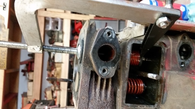

gwest_ca-(File Mod) 11,148 #7 Posted August 12, 2019 Is this the pin you are describing? Copper washer https://www.partstree.com/parts/kohler-25-468-01-s/ Photo from page 12-2 of the service manual Garry Share this post Link to post Share on other sites
