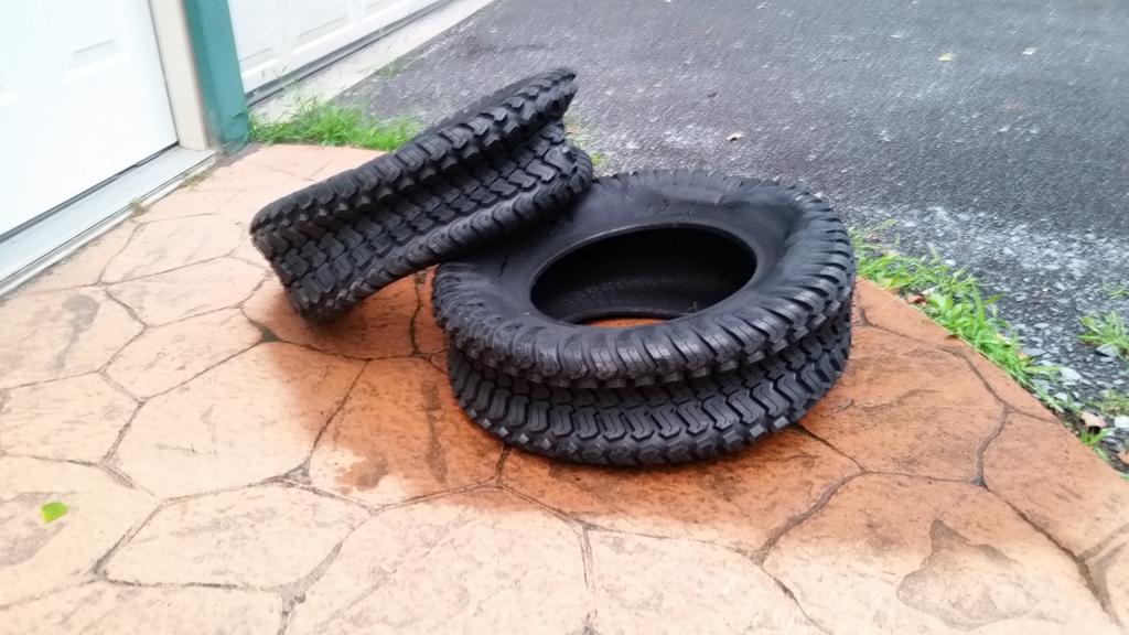

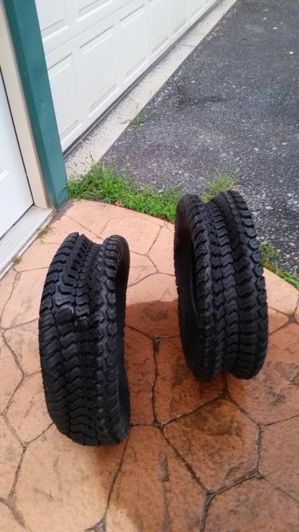

rjg854 11,829 #1 Posted August 10, 2019 The little lady got me a set of tires as a present and you can see they are a bit out of shape . I remember a thread about this and tried the search. But dealing with tires the results are endless. What can I do to get them usable for mounting. Thanks Share this post Link to post Share on other sites

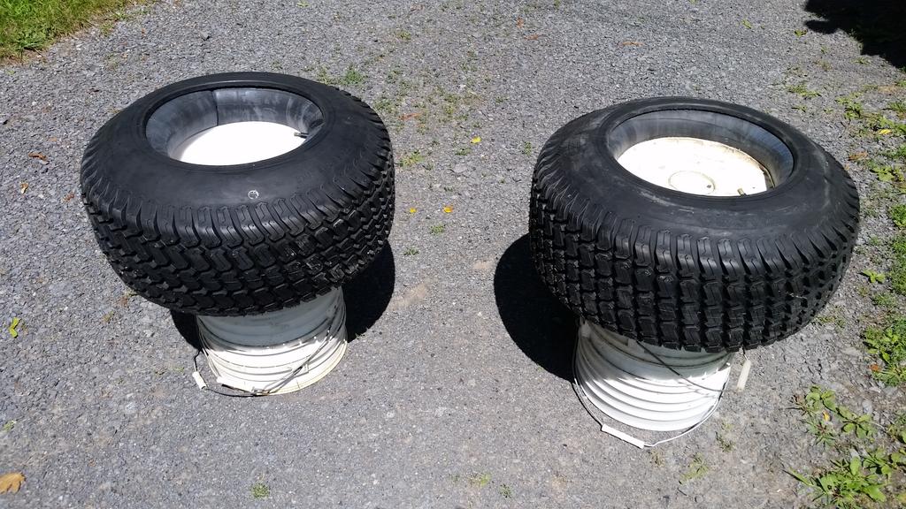

rjg854 11,829 #10 Posted August 10, 2019 I think what Richard is saying is put the tubes in the tires before putting the tires on the rims. And leave them out in the sun. 5 Share this post Link to post Share on other sites

rjg854 11,829 #13 Posted August 10, 2019 I'm giving Richard's suggest a try. With just a tube inside the tire, that wasn't enough to get it to the shape it needed to be. So I added some plastic pails to the center of the tubes and helped quite a bit, now, time will tell. 2 1 Share this post Link to post Share on other sites
ebinmaine 70,229 #14 Posted August 10, 2019 1 minute ago, rjg854 said: I'm giving Richard's suggest a try. With just a tube inside the tire, that wasn't enough to get it to the shape it needed to be. So I added some plastic pails to the center of the tubes and helped quite a bit, now, time will tell. Looks like those should settle out fine. Will you be removing the tubes for installation? Share this post Link to post Share on other sites
clueless 3,104 #15 Posted August 10, 2019 (edited) 1 hour ago, rjg854 said: I'm giving Richard's suggest a try. With just a tube inside the tire, that wasn't enough to get it to the shape it needed to be. So I added some plastic pails to the center of the tubes and helped quite a bit, now, time will tell. What,s the old saying about necessity, you done well. Edited August 10, 2019 by clueless spelling 2 Share this post Link to post Share on other sites
rjg854 11,829 #16 Posted August 10, 2019 4 minutes ago, ebinmaine said: Looks like those should settle out fine. Will you be removing the tubes for installation? Planning on fluid filling the tires, and since I have them I just might 2 1 Share this post Link to post Share on other sites
