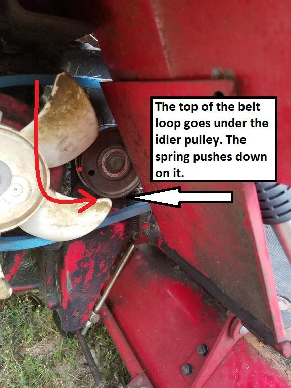

Jenna 6 #1 Posted August 5, 2019 How to I run the belt with the clutch pulley (middle one) I'm trying to get this put back together before night I cannot figure ot out 1 Share this post Link to post Share on other sites
wallfish 17,077 #2 Posted August 5, 2019 Pull the handle up which is connected to the idler pulley and route the top part of the belt loop under the idler pulley. Then when you release the handle it will push the pulley down on the outside of the belt 1 1 Share this post Link to post Share on other sites
wallfish 17,077 #3 Posted August 5, 2019 The bottom part of the belt loop is always the drive side on a Wheel Horse. That part of the belt is always direct because it handles all of the load. All tension pulleys and such always go to the slack side (upper loop) of the belt loop 3 Share this post Link to post Share on other sites
953 nut 55,712 #4 Posted August 5, 2019 As John said, your belt installation should look like this when completed. 1 1 Share this post Link to post Share on other sites

peter lena 8,708 #8 Posted August 5, 2019 953 NUT, perfect reference picture, to those that have an issue, note that the top side of the belt is driven against the flat side of the pulley, while the lower V side rides in the v grove of the larger drive pulley. as simple as it sounds , people get confused by it, this picture should be a quick reference to a belt mount question, good response, pete 1 Share this post Link to post Share on other sites
