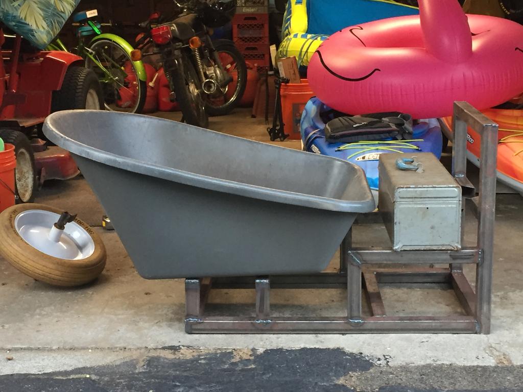

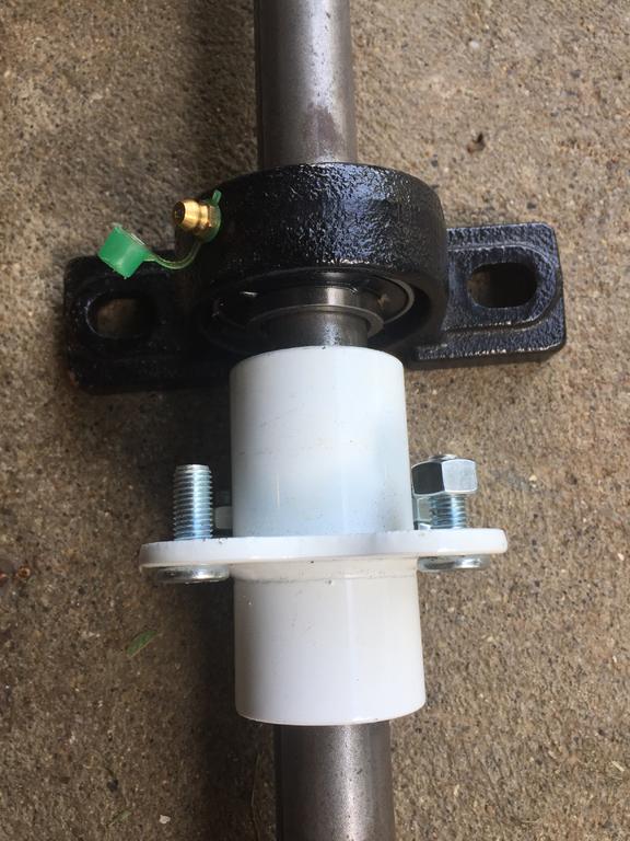

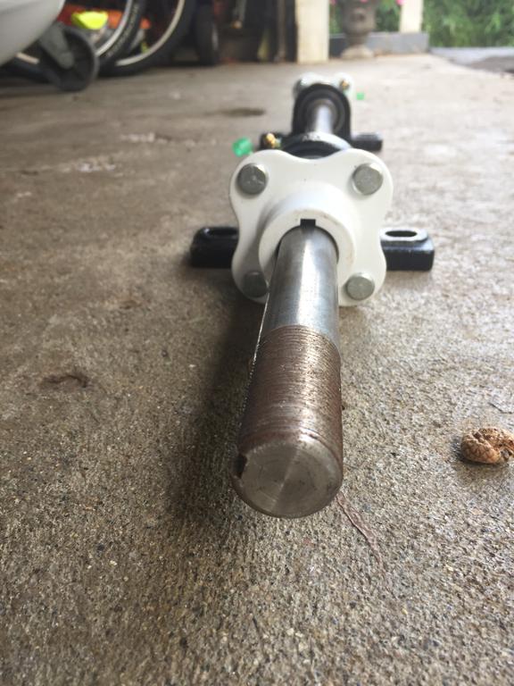

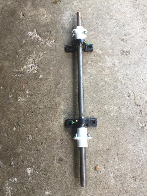

SylvanLakeWH 29,818 #1 Posted August 4, 2019 So 4 years ago my son decides he is going to build a wakeboard winch (google it - they are pretty wild)... Long story short, he bought all the stuff, fabricated the frame, began assembly, lost interest and now is away at college. I, on the other hand, have a large pile of winch "stuff" in the basement which is going to become another wheel barrow conversion trailer. Here are the basics: Trailer will connect with my previous wheel barrow trailer build to create a "kid train" to haul nieces and nephews around the hood. The frame and all parts are WAY over built for this new trailer need, however the price is right (free) and I am looking to basically build this so I do not need to do any (or minimal) cuts, welds or other stuff...I want to bolt and go. Here are my dilemmas / questions: 1. Axle is 1" and I am having a hell of a time finding cheap (free would be sweet) wheels / tires that will bolt on... HF, Northern Tool, TSC etc. no go with options. So ideas on this would be welcome. As you can see, the set up he was using (totally different application) was a live 1" axle to spin the winch using hubs and pillow blocks. 2. Looking to have a tool box bolted on and for this design I want the barrow to tilt, with a lock / latch so I can use it to haul / dump as well as cart kiddies around without dumping them... I was thinking a simple hinge point using several door hinges and a hardware latch from my pile of crap (supplies). Too simple? Pictures show the concepts I am kicking around... I will also be painting the appropriate shade of red, and will be ordering another set of custom decals from Terry to match the previous set. (pic of previous build attached fro reference. Thoughts / suggestions would be appreciated...! PS - If anyone in SE Michigan has a Black Hood Roller with a solid 8 speed manual - I am looking for one (cheap) to use the 9 hp Honda clone he bought for the winch...Brand new - never fired up...(I am partial to the Black Hoods)... 3 Share this post Link to post Share on other sites
JAinVA 4,638 #2 Posted August 4, 2019 I hate to say it but the best source for 1" hubs is off the green garden tractor fronts.That is what I use for heavy builds and I get them used off of the popular bidding site. 2 Share this post Link to post Share on other sites
SylvanLakeWH 29,818 #3 Posted August 4, 2019 Ok thx. Will check that out! Share this post Link to post Share on other sites
953 nut 63,003 #4 Posted August 4, 2019 If you have a couple of 1 1/8" hubs kicking around you could use a couple of bronze bushings in each hub. Don't need high speed bearings for a load of grand-kids and the ride would be better with a pair of 23" pneumatic tires.. 4 Share this post Link to post Share on other sites
SylvanLakeWH 29,818 #5 Posted August 4, 2019 Also excellent idea! Thx! 1 Share this post Link to post Share on other sites

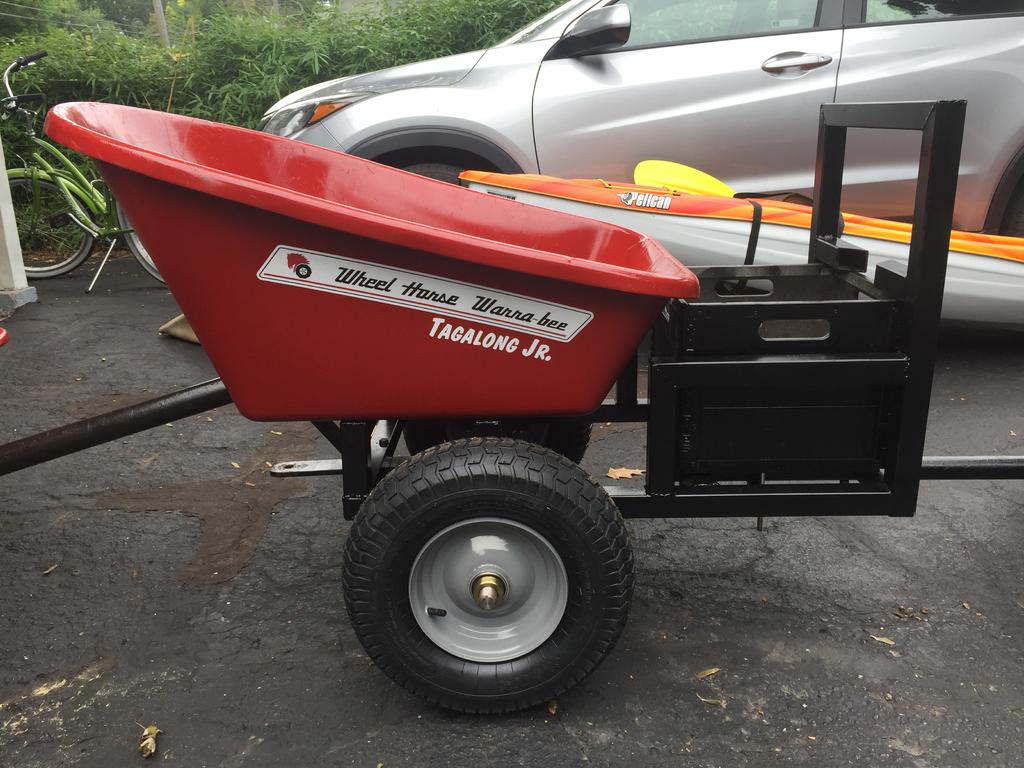

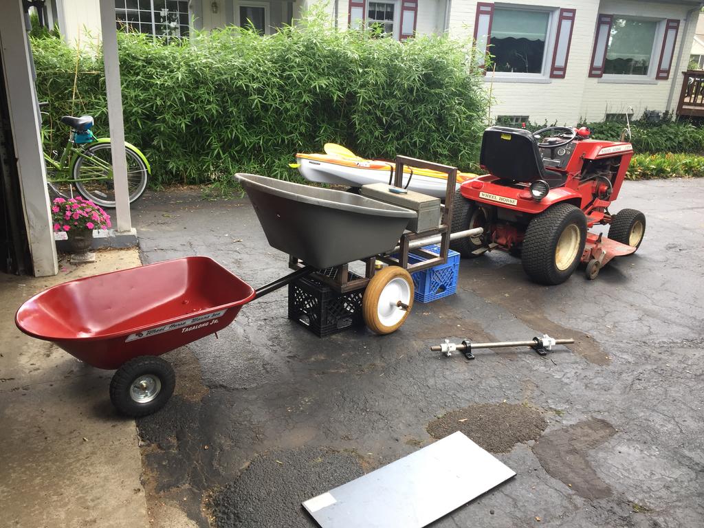

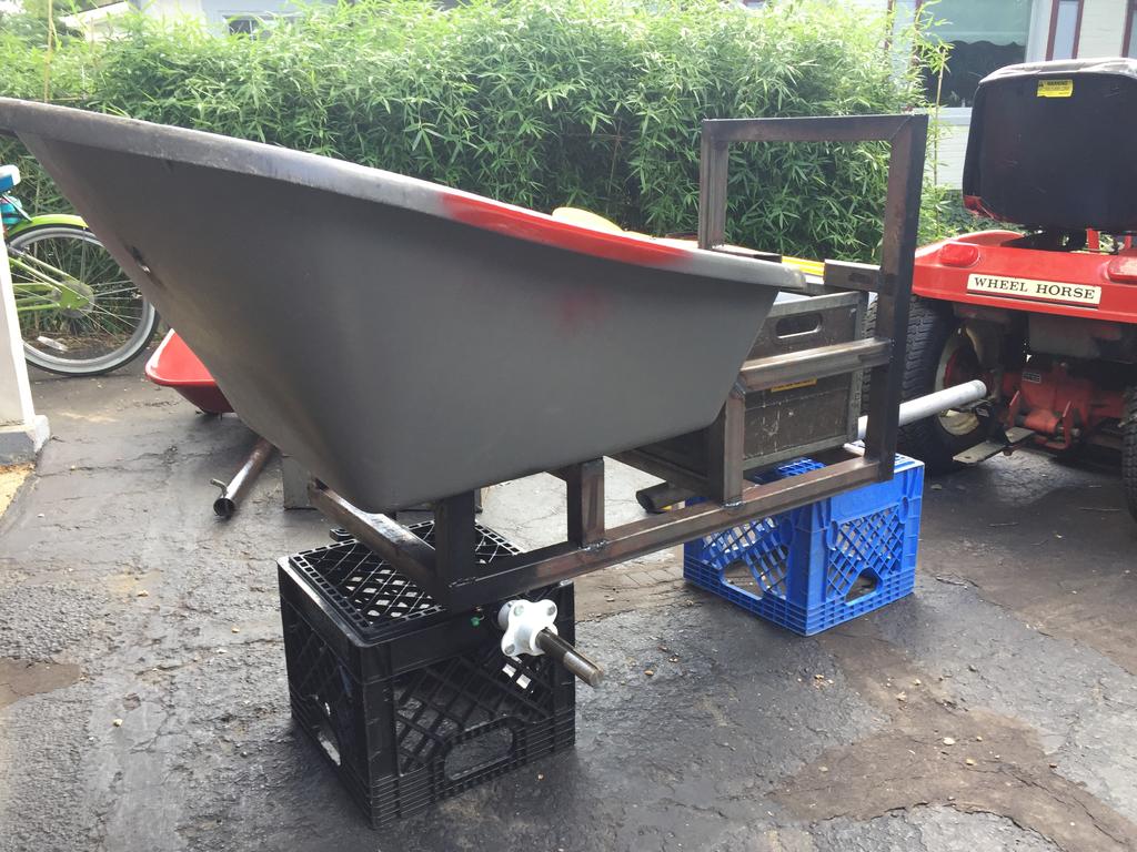

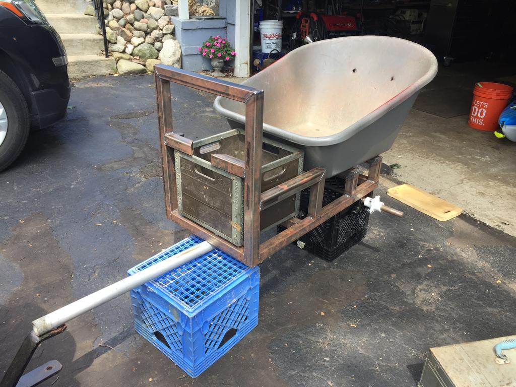

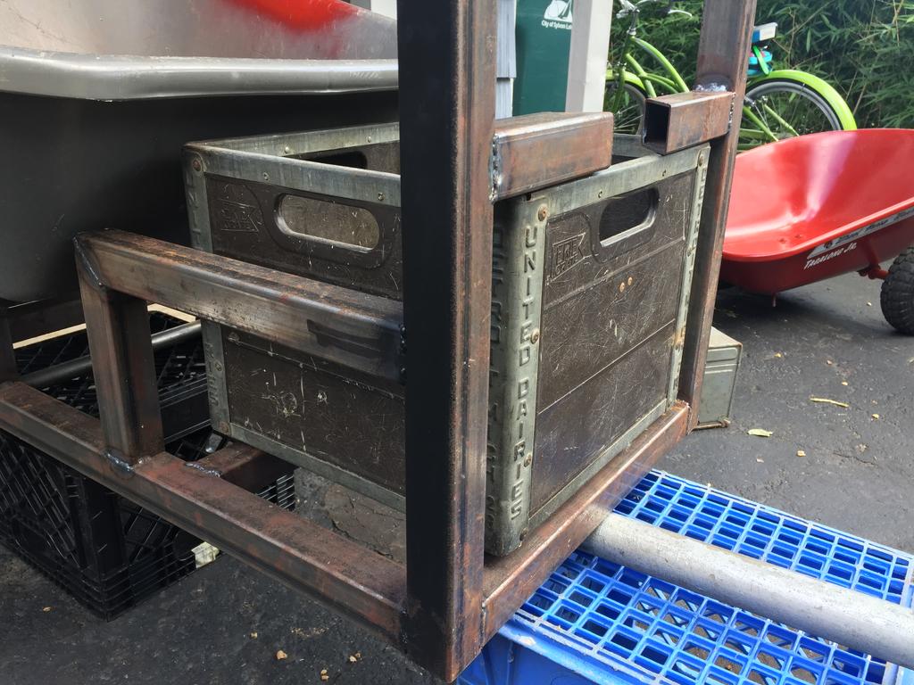

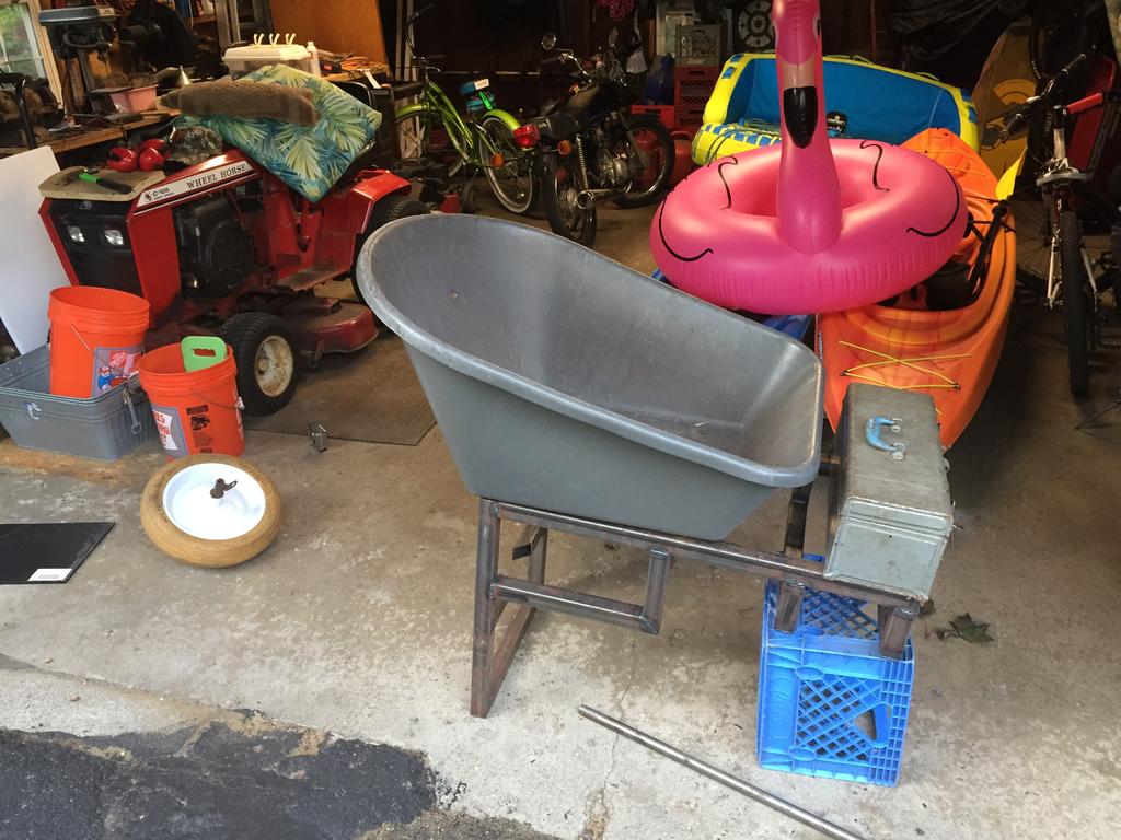

SylvanLakeWH 29,818 #8 Posted August 9, 2019 So a bit of progress today... Design needs to include a “train” of two trailers for nieces and nephews...important stuff before practical...! Found 1” bore wheels / tires at TSC. Ordered...along with shaft collars...no luck finding anything reasonable used... The yellow tire is just for mock up purposes... honest... Working on hinge for dumping. Gonna just use the front axle and brackets off the wheel barrow with the axle Inside a pipe bolted to the dump to make a hinge. pics to follow when fabricated... Decided on milk crate instead of tool box. More flexible carrier... Going with black frame and red barrow...I think it will compliment the Black Hood well... Graphics from @Vinylguy on order! All for now! 5 Share this post Link to post Share on other sites

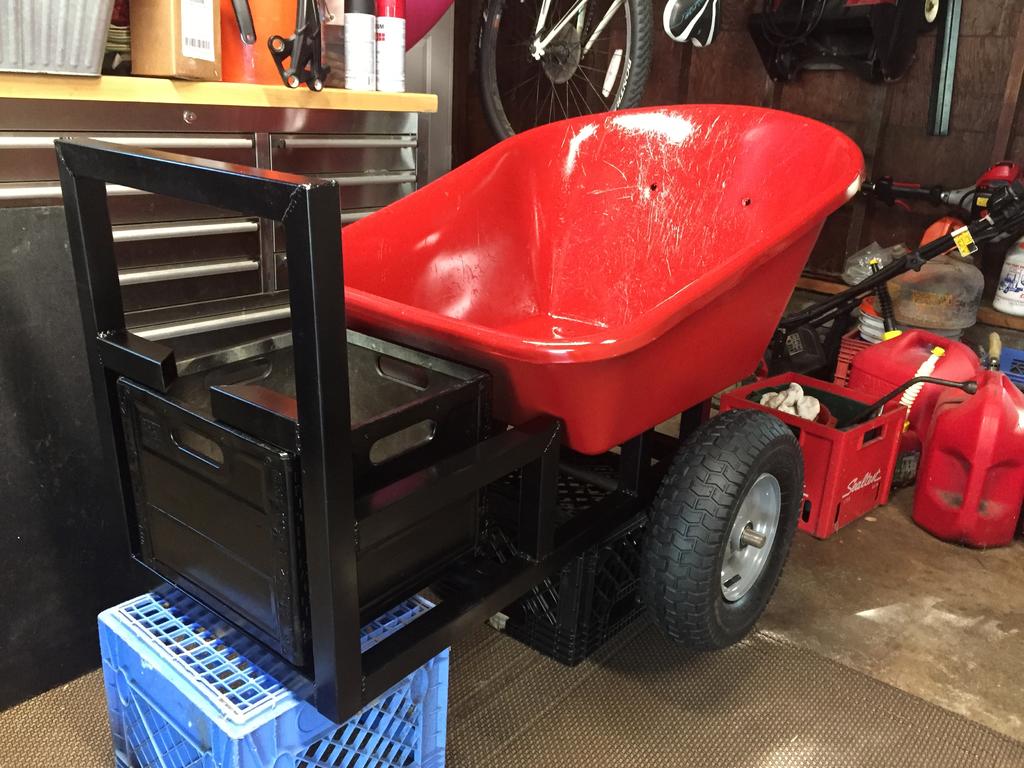

SylvanLakeWH 29,818 #9 Posted August 17, 2019 Little more progress on the trailer today. Paint, wheels and axle configuration completed. Decals arrived from Terry as well (as usual - fantastic quality @Vinylguy)...but I will make you wait to see those until applied to the finished product... All that's left is to line it all up, drill some holes, bolt it together, add the decals and then load the nieces and nephews... Oh, also thinking of adding a front wheel. It would "hang" from the tongue suspended while hooked up to the tractor, but would be used to wheel the trailer around when not hooked up. Have a spare wheel barrow wheel and an old bike fork that will work... We will see...not sure I want the added "stuff" on the trailer. 3 Share this post Link to post Share on other sites

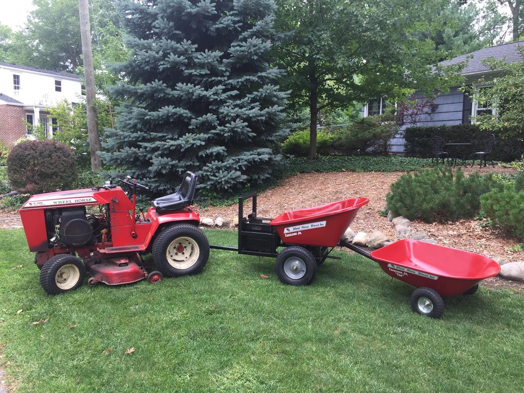

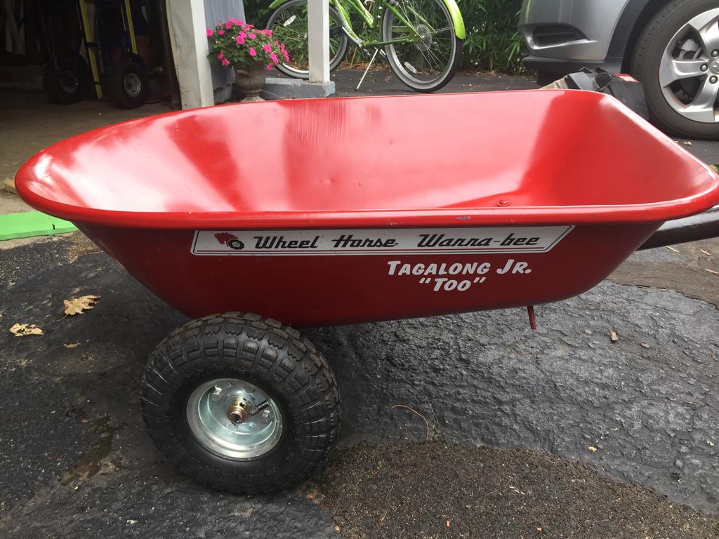

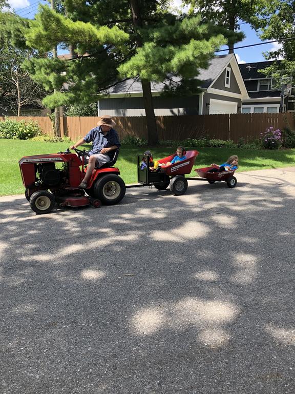

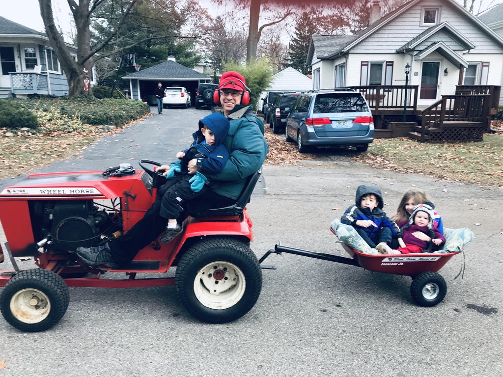

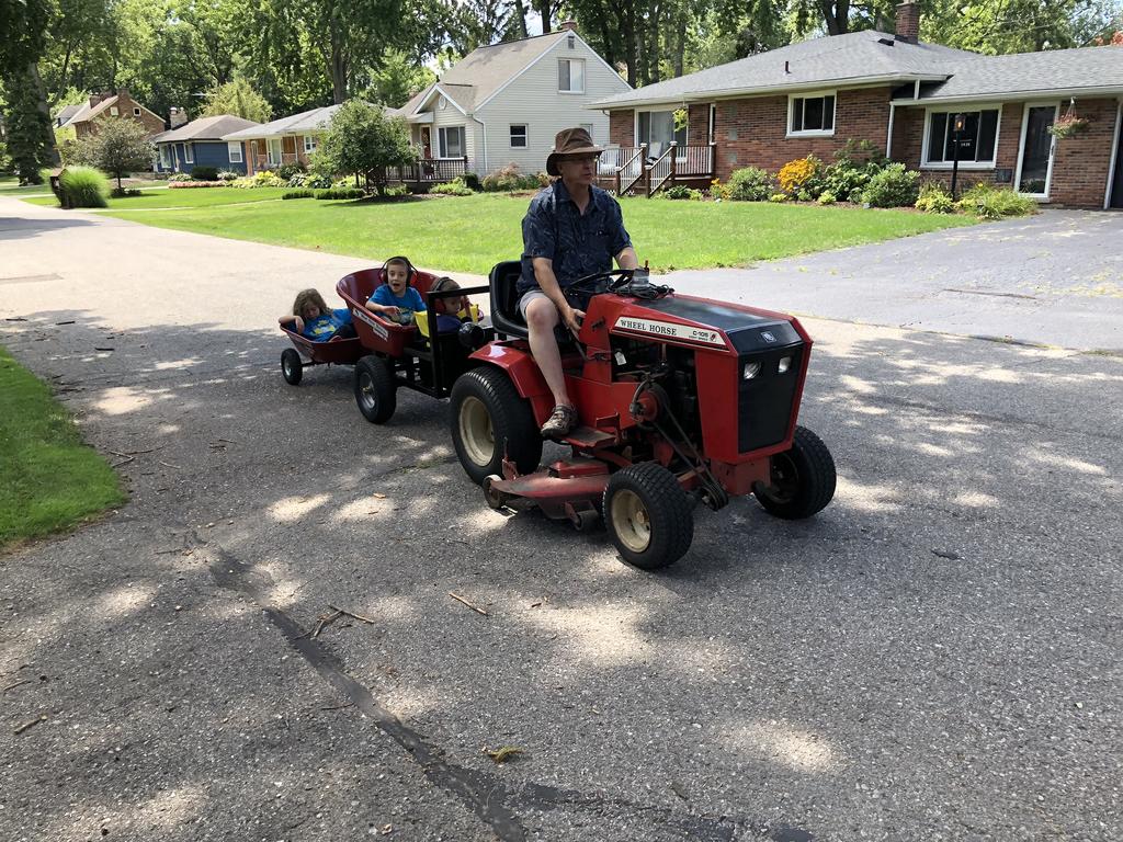

SylvanLakeWH 29,818 #10 Posted August 18, 2019 (edited) Finished! My thanks to Terry @Vinylguy - The graphics are great!...even the little guy got "Too" added to its name...! Now its time for the nieces and nephews to hop aboard the Wheel Horse & Sylvan Lake Western RR...! My wife is hoping we do not spot anymore wheel barrows in the trash! Can't imagine why... Edited August 18, 2019 by SylvanLakeWH 1 1 1 Share this post Link to post Share on other sites

Vinylguy 4,710 #12 Posted August 18, 2019 My thanks to Terry @Vinylguy - The graphics are great!...even the little guy got "Too" added to its name awesome wagon train!! 1 1 Share this post Link to post Share on other sites

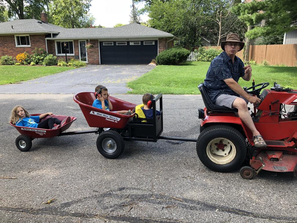

SylvanLakeWH 29,818 #13 Posted August 24, 2019 The Field Testing Crew spent yesterday fly-specking the trailer... Passed with flying colors! 1 3 2 Share this post Link to post Share on other sites
ebinmaine 75,745 #14 Posted August 24, 2019 Absolutely fantastic! 1 Share this post Link to post Share on other sites
Digger 66 3,488 #15 Posted August 24, 2019 1 hour ago, ebinmaine said: Absolutely fantastic! Y E S 1 Share this post Link to post Share on other sites
