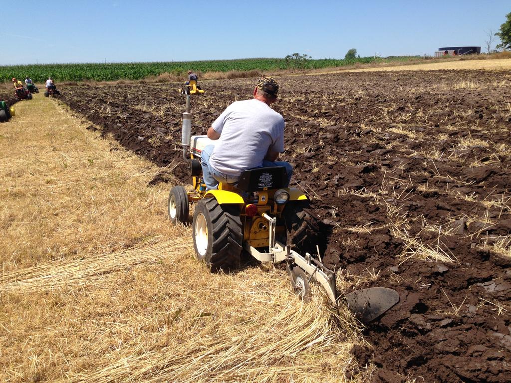

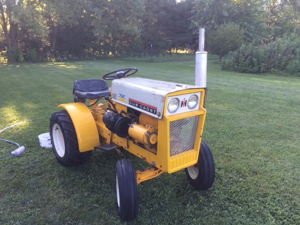

PeacemakerJack 10,743 #1 Posted July 15, 2019 As per @RandyLittrell‘s request, I’ve started a thread on a cool little plow tractor that has been in our stable for about 5 years. As those of you who have followed my posts over the years know, I have purchased a vintage tractor for each one of my kiddos to use while they are young and then to refurbish/restore when they are about 14-15 years old. It will give them a little background in mechanics, electrical, and paint, and also how to use basic tools. I also like the aspect of the father/child time invested in the project. They also will learn how to take care of their own machine as part of the process (check and change fluids, grease the zerks, make routine adjustments, etc). I got into GT plowing in 2011 and by 2012 I really had the bug. As I looked at the various machines out there, I was really impressed with the Cub Cadet 100. They are tough little machines but still very early production yet with some good options that make them quite useful for plowing. As I looked through the pictures on my phone dating back to June of 2015 nearly every picture of this tractor has a plow attached to it. I guess that makes sense given the purpose for which it is built! The Cub 100 is widely considered one of the neatest Cubs ever made both in design but also overall durability and function. The Original cub was built from 1961 through most of 1963 and was only offered with a 7hp engine. By ‘63, many manufacturers including WH had larger engines offered and IH knew that they needed a bigger engine to compete and so the 10hp 100 was born. They had already sold over 60,000 Cubs in a three year span and so it was time to release a model that had more options and “creature comforts” that offered more attachments to handle the jobs that customers ran into daily. I bought this tractor for my third born Jonathan, whom we call Judge. The guy I bought it from had rebuilt the engine, fabricated the trailer fenders to accommodate the much larger than stock 10.5” wide rear tires and had painted the sheet metal. I saw the potential in it right away and a deal was struck. The ideal plow tractor has hydraulic lift and this tractor was equipped with strong arm manual lift. Thankfully I had a complete hydraulic unit from a different cub on my shelf. I also installed the third arm and bracket for my Brinly hitch adapter. This tractor came new with the optional rear PTO which was really a novelty because it turns backwards since that it the rotation of the engine. The center section of the rear end was directly out of the Farmall Cub tractor and that is the reason that this option was offered. On the FC the engine rotation was correct and the PTO could be used operate a variety of attachments. On the CC, there wasn’t much that could be run. I’ve heard stories of farmers that would hook them to a grain elevator to free up a tractor while harvesting grain or corn. There was also a company that offered the Hub City reverser which changed the rotation to the correct way. Those seem to be pretty rare and I’d like to find one someday for novelties sake. This tractor also has the optional creeper gear. If you notice on the diamond plate tunnel cover just ahead of the gear shift, there is the slot for the Hi/Lo range lever. This one loves to pop out of Hi range and so you will also see my 4 year old (temporary fix) of a small C-clamp! I like some variety in pain colors to my tractors and you will note that I painted the air cleaner cover (off an 18hp Kohler for extra breathing capacity) and the hydraulic pump unit Black on the Mule. This tractor also came with the factory pepper pot exhaust. To be a serious plow tractor it had to have a stack and so a Farmall Cub stack was installed. From the above picture you can also see that it has the optional cigarette lighter. It doesn’t have the factory one (I’ll get one someday for it) but it gives a place to charge your phone should you run low on battery while at Jim’s plow day! This one also came with optional headlights and Grote tail light. I added the rear plow light for night plowing at some of the big plow days. The factory seat was a metal pan with a two colored cushion. I had the old school black short back rest seat from a different tractor and installed that for now. Here is my son Judge with a bone stock fully restored 100 at Red Power a couple of years ago. I included this for reference of the correct fenders, seat, exhaust, etc. This is the first out of state plow day that I took GhostRider to before he got his dark clothes. You’ll notice that the hood on the Mule is kinda gnarly compared to the yellow on the rest of the tractor. The previous owner liked the Patina of the hood so much that he just cleared over it to preserve it. I didn’t like it at first but it has grown on me over the years. Lots of people (Uncle Roger on it here at Jim’s PD) have turned furrows with it and it is almost universally liked as a plow mule. @Rp.wh told me that plowing on that little tractor is what helped get him into the hobby. It only has 10 hp but it does a good job of putting power to the ground. The only real negative is that it has fairly low ground clearance and that can sometimes be a problem when following someone who is trying to recreate the Marianas Trench! This pic was taken in Peoria, IL at Bluniers PD. The Mule is second from the right and did a great job of plowing. @Coulter Caleb Jumped on that thing and plowed for several hours. My mom’s red 782 in the foreground (she calls Decklan) the Mule, the Five, and Grizzly in the background. As with any project machine, improvements can always be made. I would like to build a more powerful engine for it, not because it needs it but because I can😁. I also would like to upgrade the clutch (pressure plates, clutch, spring) rear end gearing. @Achto took this super cool pic last summer of Uncle Roger plowing with my youngest Zach up at Plainfield. It is a really neat little tractor and we have made a lot of memories with it over the years. Judge is turning 9 in about two weeks and I’ll be sure to post some pics on here of him driving his Mule on his birthday. Here he is turning soil in a Stertz field that his great grandpa turned, his grandpa turned, his dad turned, and now him! This land has been in the family since 1948 this little farm boy has the perfect Mule to get the job done (maybe a tad small for a 15 acre field but Uncle Roger can bring out the big guns to finish what he doesn’t!) Feel free to ask any questions that you have about the setup...hopefully the yellow didn’t hurt your eyes too much😉 3 13 Share this post Link to post Share on other sites
oliver2-44 10,075 #2 Posted July 15, 2019 Great thread @PeacemakerJack You certainly can give people the "Plowing Bug" As far as the yellow, I like em working in all colors Setting up a plow tractor is on my build list! Some tractor clubs around here have plow days for there old full size tractors. They even use have Cubs, Farmall A's, etc, but no GT's. I just may be the 1st to show up with a GT. 2 2 Share this post Link to post Share on other sites

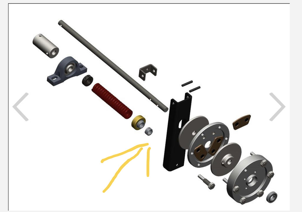

PeacemakerJack 10,743 #16 Posted October 15, 2019 So...I finally stuck my head under the Mule last night to find out what was wrong with my clutch. Turns out it wasn’t a broken/missing spirol pin but rather a broken/missing teaser spring. This is a diagram of a heavy duty version of the Cub clutch compliments of Midwest Super Cub. I am missing that little teaser that is sandwiched between the throwout nearing and the clutch arm. So...I ordered a new one of those as well as new Kevlar friction disc, pressure plates, and HD clutch spring. That should keep Judge in good shape for a long time 2 2 1 Share this post Link to post Share on other sites
RandyLittrell 3,887 #17 Posted October 18, 2019 On 10/15/2019 at 12:43 PM, PeacemakerJack said: So...I finally stuck my head under the Mule last night to find out what was wrong with my clutch. Turns out it wasn’t a broken/missing spirol pin but rather a broken/missing teaser spring. This is a diagram of a heavy duty version of the Cub clutch compliments of Midwest Super Cub. I am missing that little teaser that is sandwiched between the throwout nearing and the clutch arm. So...I ordered a new one of those as well as new Kevlar friction disc, pressure plates, and HD clutch spring. That should keep Judge in good shape for a long time Did you get the red spring or the blue one? The red one gets a little tiresome pushing in on the clutch. I bought a blue one but haven't put it on yet. Its supposed to be in between the stock and red spring. Randy Share this post Link to post Share on other sites
Pullstart 63,529 #18 Posted October 22, 2019 On 10/18/2019 at 9:04 AM, RandyLittrell said: Did you get the red spring or the blue one? The red one gets a little tiresome pushing in on the clutch. I bought a blue one but haven't put it on yet. Its supposed to be in between the stock and red spring. Randy I think this looks red to me... ”The color or the pen that I hold in my hand is RRRRRRRRRRROYAL BLUE!” Mr. Reid, Liar, Liar 2 1 Share this post Link to post Share on other sites

PeacemakerJack 10,743 #22 Posted October 22, 2019 On 10/18/2019 at 8:04 AM, RandyLittrell said: Did you get the red spring or the blue one? The red one gets a little tiresome pushing in on the clutch. I bought a blue one but haven't put it on yet. Its supposed to be in between the stock and red spring. Randy I only saw the Red (800#) and yellow (1200#) on their site. So, I got the red one. And set it just slightly longer than their recommendation of 4.5” Thanks to Pullstart for helping me put that thing together at 1am on Saturday! Starting point... 40 minutes later. The high performance clutch parts. Back together and ready for Plow Day! Two 1964 models in one trailer—cool. The clutch worked great at Plow day but I think the engine is getting a little tired after 5+years of hard use. Next plan for that is a rebuilt engine and a gear change for the rear end... 3 1 Share this post Link to post Share on other sites
