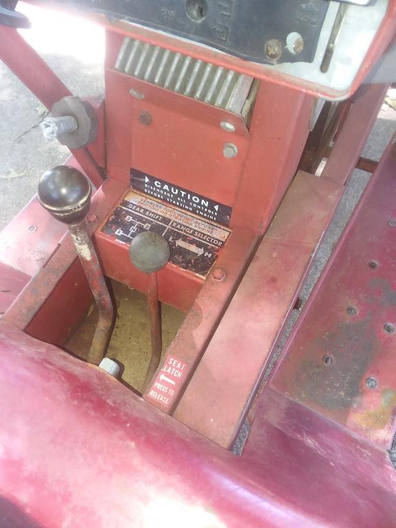

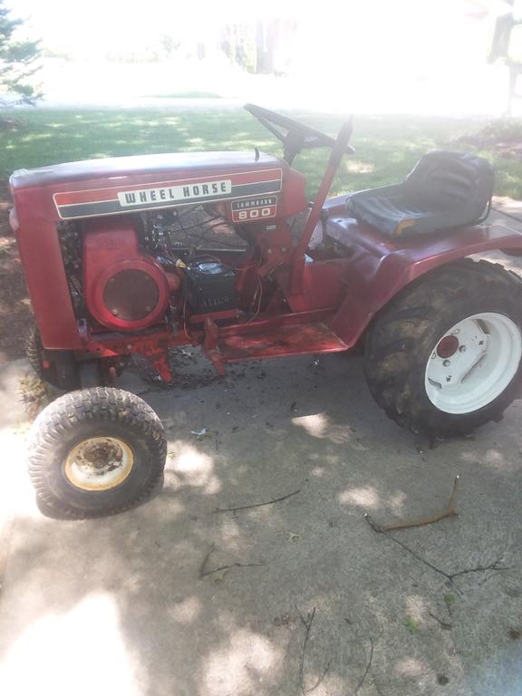

Picked up this tractor yesterday couldn't tell from his pictures that it had a 8-speed I looked through the manual and does show it as option Kohler 8 hp  1972 model 1 0110 7  serial 889625

With the round knobs that might be a six-speed.

Odd because the 1-0110 should have 3 forward speeds and 43-1/2" wheelbase.
The Raider 8 model 1-0330 has 6 forward speeds and 45-1/2" wheelbase.

I don't see the round knobs as a factor Eric but they were period correct. An 8 speed would be a bit easier to swap but that's not saying that it isn't a 6 speed. An 0110 Commando 800 is what I restored for my grandson. Originally a 4 speed with 10" rears. Easy enough to put 12" on it as that's what I did. From the pics that tranny swap was well done with attention to detail. Geez, that shifter decal looks original. Do you suppose some left South Bend like that? :eusa-think:

That could be. We all know that the Ponds like to mess with our heads and it wouldn't surprise me if the dealers compounded that. The rear wheels are cleaner and 'whiter' than the fronts indicating a swap, probably more recent. :)

I would not part it out the commando 800 was only made for 2 years. Everything about the tractor appears period correct like patina, what bolts are visible do not appear to have had a wrench on them for a very long time. And even that shifter decal has been there a long time as well, the only thing that stands out are the larger white rear wheels. I think you made a great find enjoy it.
ELECTRORIC
I was reading the Commando 800 manual on this website and it shows a 8 hp 8-speed option it shows the front rims at 6" for the 8 hp rear tires were 23x7.50-12 for the 8-speed option for sure the rear tires now are not original it had plastic wheel weights maybe that is why the wheels are so white

   I'm liking what  @ELECTRORIC was saying about the 8 speed option.  They used 3 different transmissions in 1972.  It should be fairly easy to figure out what transmission is in here.  1. was what would have been original...the #5085 4 speed.  2. the 8 speed #5086.  This transmission had the Hi/Low with a 4 pinion differential and 1" axles.  3. the 10 pinion Limited Slip #5073 with 1 1/8" axles.
   The brake drum would be on the cluster gear shaft on all of these transmissions.  The dead give away would be if it has 1" axles. :occasion-xmas:
So, measure the axle diameter, and post a picture of the left side of the transmission from the back and from above if possible.
That is a very nice find, and is probably on the rare side.

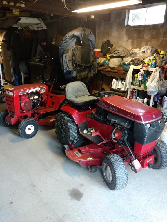

Any idea how many of this configuration was produced? Here is picture of my commando 800 the one in the rear, it has the 3 speed.

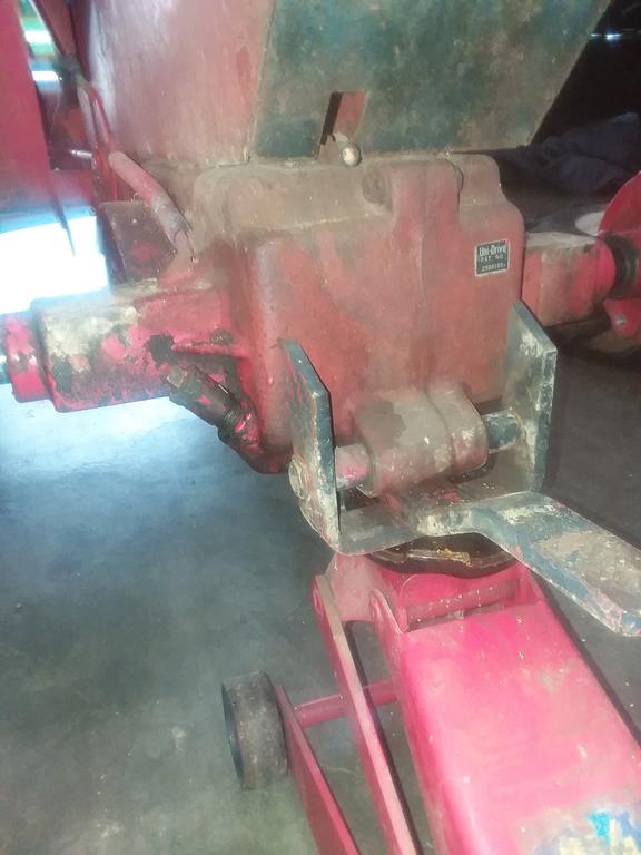

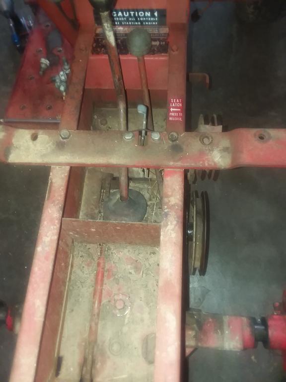

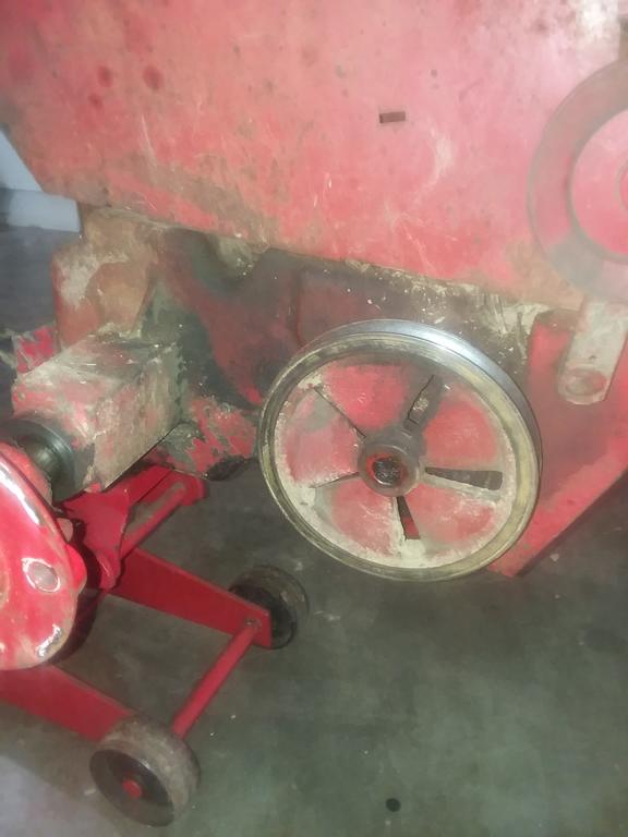

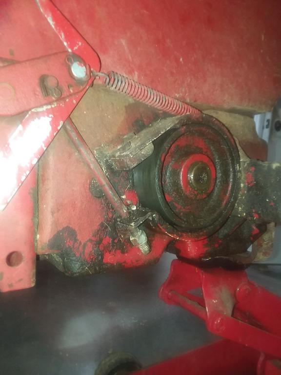

ELECTRORIC
Took some pictures of trans, going to split it input shaft bearing is bad and the differential sounds like it has gravel in the gears oil looked good the axles do turn in different direction.
pfrederi
The extended fill plug would indicate it was ..at least originally ...a 10 pinion.  If it was still in there and the spring was in good shape the wheels should turn in the same direction.  That yours is going opposite indicates the differential may have been swapped out or the spring is shot.  If it is a 10 pinion with a bad spring Lowell sells replacement springs,
ELECTRORIC
Trans turned out to be a 5060 so it looks like somebody did a conversion long time ago. I'm going to keep it the same as I got it.
Is that the 10 pinion with limited-slip?
if it is, you should probably throw another tension spring in the differential.
ELECTRORIC
Yes it is a 10 pinion limited slip I have a 5071 w/bad axles & bearings but the limited slip worked good so I hope between the two trans. I get one good one.
stevasaurus
All parts are inter-changeable between the #5060 and the #5071.  The difference between those 2 transmissions...#5060 has aluminum end plates on the differential...#5071 has steel end plates.  :occasion-xmas:
